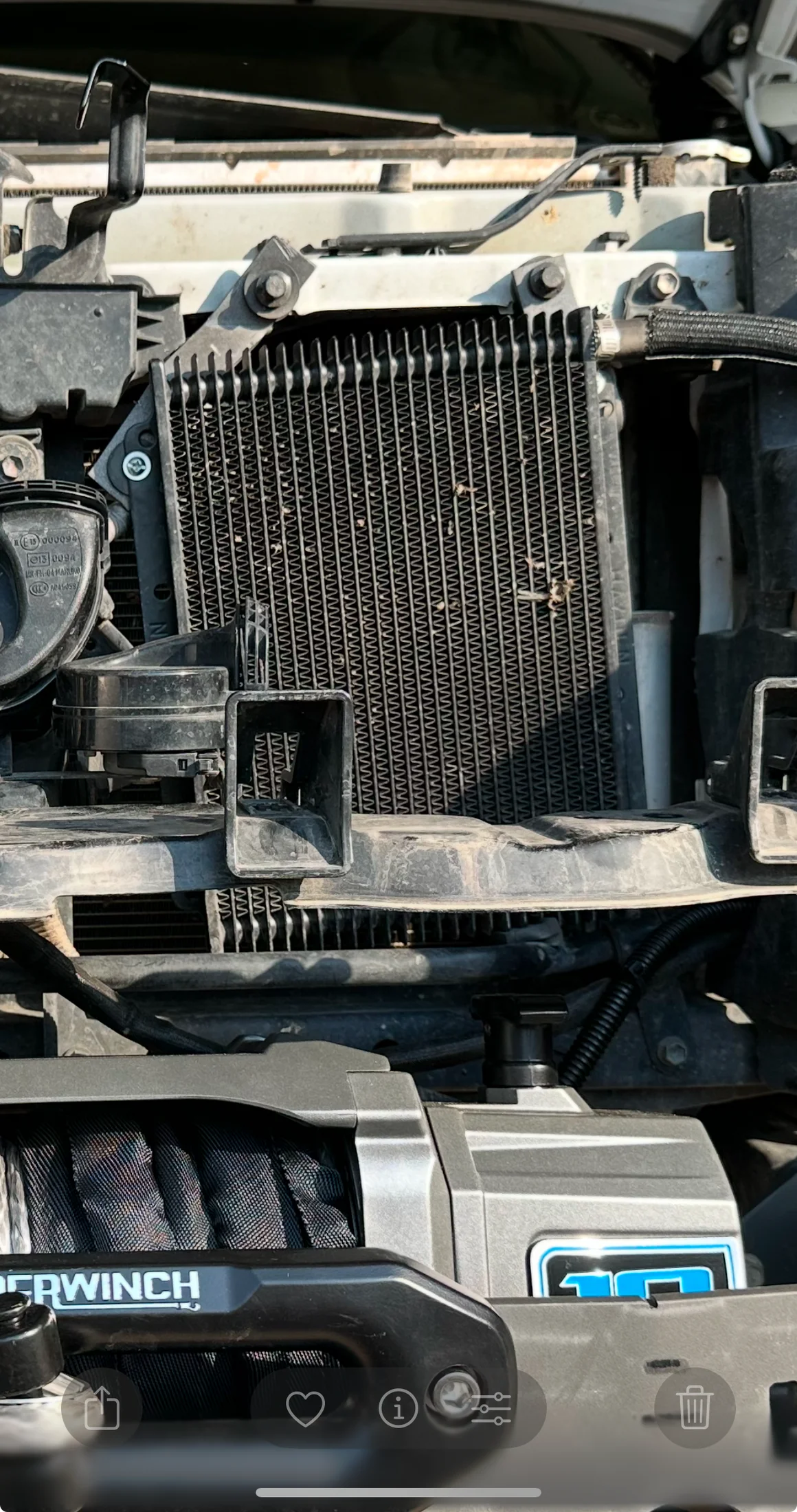

I have the OEM cooler installed and the factory thermostat pinned. 90+ ambient temp I have a pan temp of 190-195deg; it always matches the coolant temp.
I am aiming to get it around 175-180 tops.
I use the 678 w/o a thermostat. In the winter I block my cooler 2/3 of the way with a sheet of rubber. Otherwise, it will get down to a max temp of only 120F or so, which just seems to cold. In the summer with the TCC locked it usually runs ambient temp plus 80-90 degrees or so, so 170F is a typical summer temperature for it.

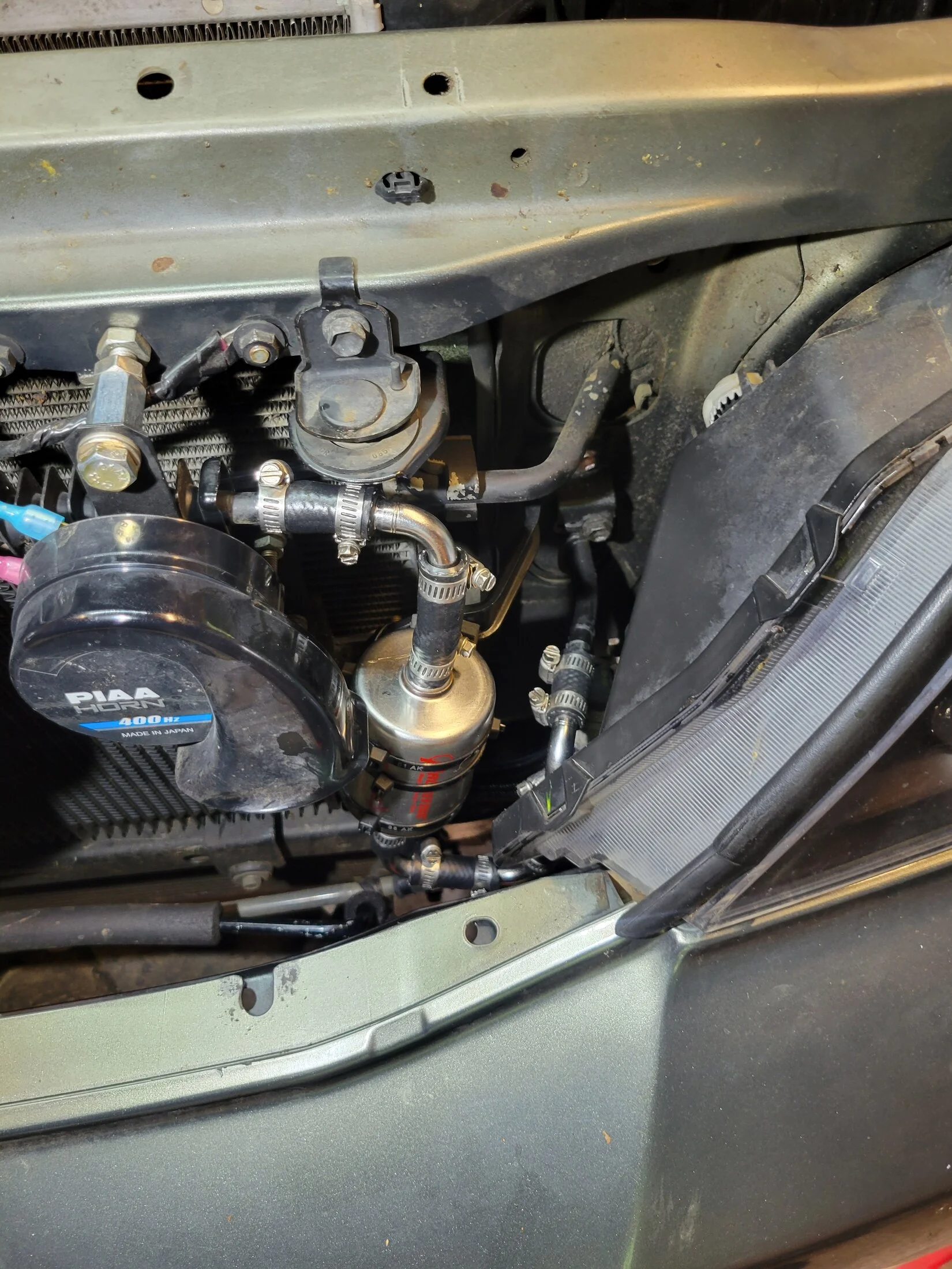

EDIT: This is for my 470 - not a 460 - but is how I plumbed a Magnefine filter into my rig. I had it ran with just 3/8 trans cooler line but didn't like that the line felt a bit "pinched". This uses 304 SS 90 degree hose barbs that I bought online. A better way to do this would be to have 2 pieces of custom-bent hard line and 4 short hose connectors to the cooler and the lines that go back towards the transmission. But, this works pretty good, and I think it should flow-freely inside the SS fittings. I'm hoping to keep my trans fluid cleaner and push changes out to 50K or so.

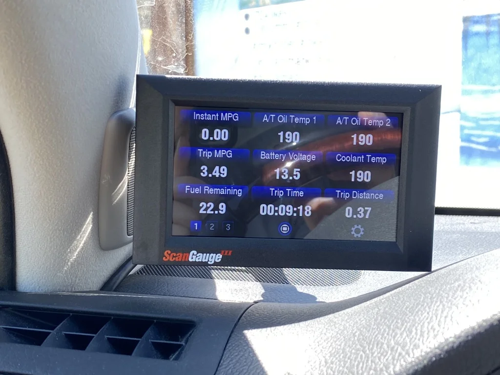

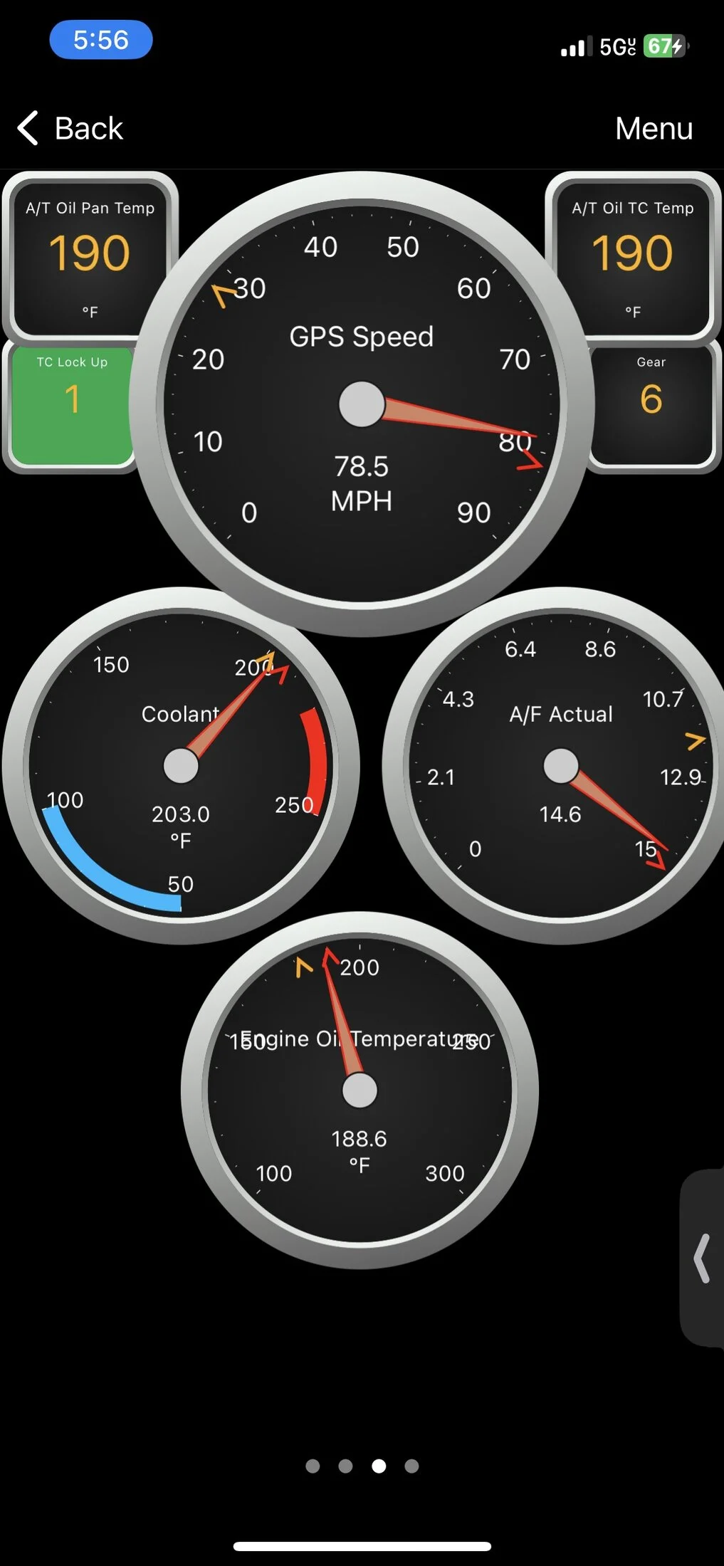

I use a scangauge 3 (scanguage 2 can do the same) and monitor transmission pan temp (AT temp 1), and torque converter tempt (AT temp2). it's based off factory sensors.
