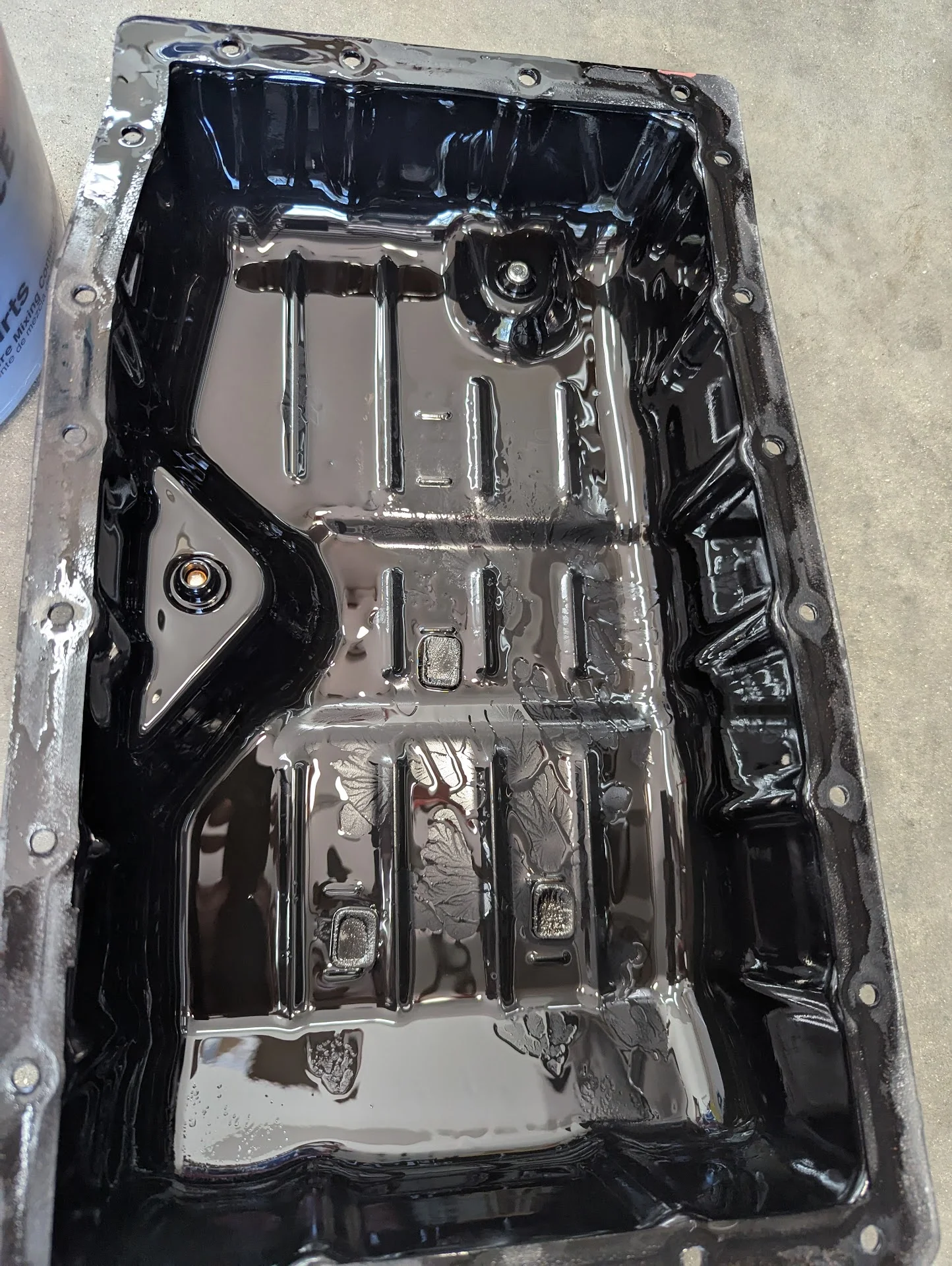

Here is a pic after removing pan. (This are 62inch-lb, Oil strainer was 7ft/lb or 84in-lb)
I use my 20-200 inch lb torque wrench for all the trans bolts including the drain and check plugs. (Fill plug gets good-n-tight spec :D)

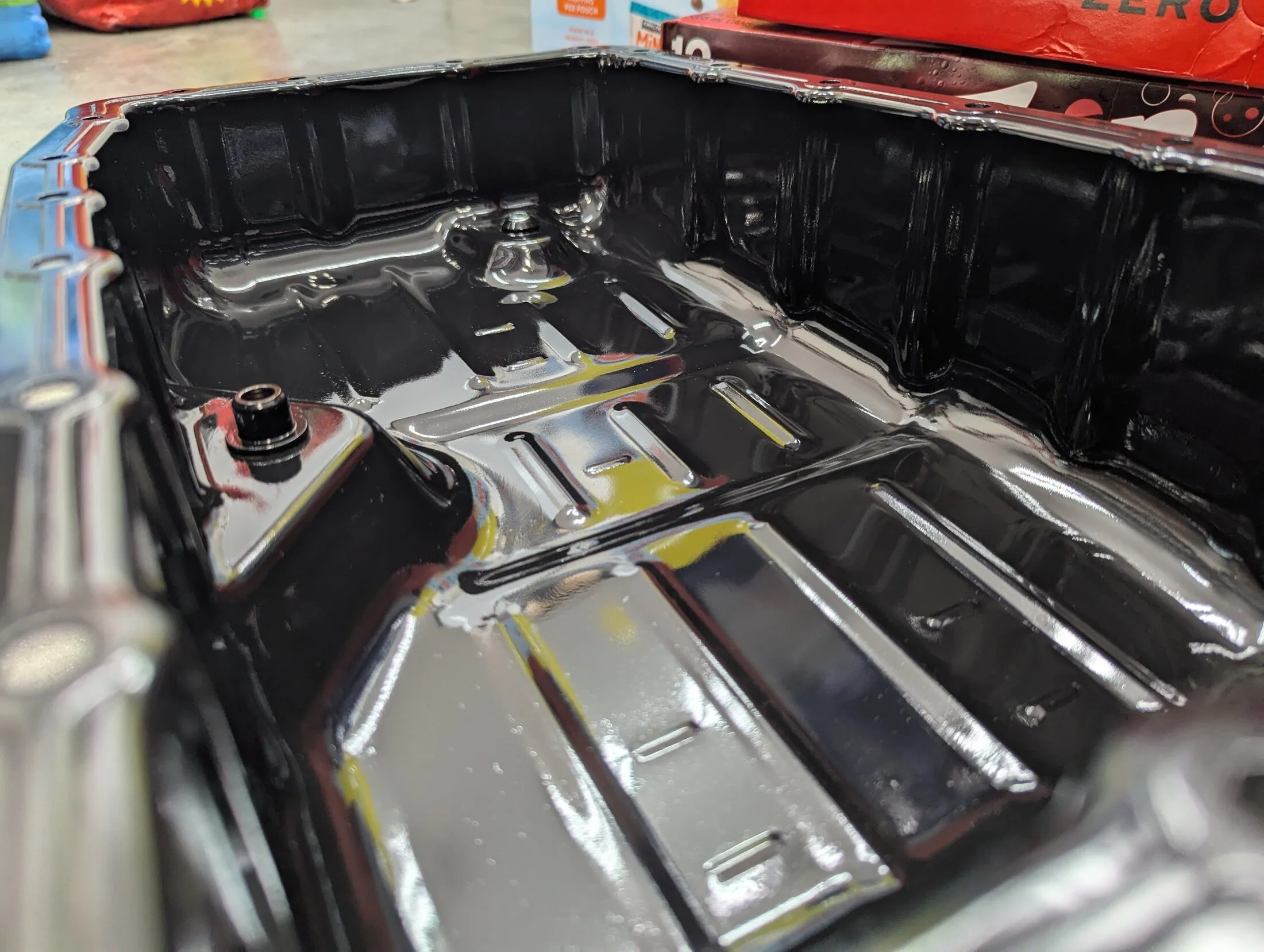

Pan has 4 magnets (I moved that one on top before I took the pic) they all had nice coating of metal to wipe off.
Something interesting to Note while I had the pan off. If I pull the drain plug I can only get ~2 quarts to drain out. The drain plug is elevated (One in the back) so its by design to retain fluid. The oil strainer sits in the middle ~1/2" from the bottom of the pan. This keeps the oil strainer/trans primed, pulling the pan and strainer I was able to drain a little over 5 quarts.

Well since the drain plug is located on the rear of the pan and elevated you have to just incline the front to get more of the old fluid out.
To maximize how much fluid you can get from a drain and fill just lift the front as high as you can safely lift. Can just lift from the front central jacking point.

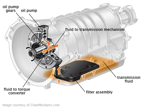

The transmission has a pump? Where is it and what drives it?
On most if not all automatics it's usually right behind the torque converter.
