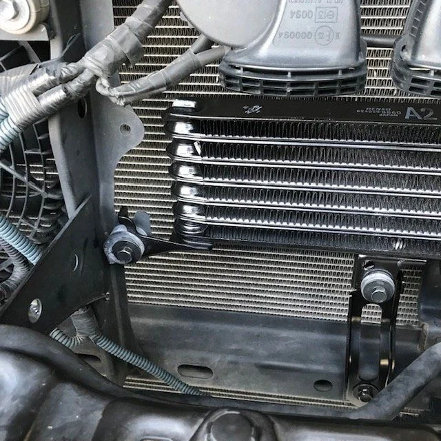

Here is mine during install of OEM cooler and what it would look like on a fully loaded Canadian GX 460.
Another note... only 3 zone HVAC 460s have the AC condenser fan in first picture. Two zone do not.
is it just me or is the factory cooler a bit underwhelming?
I'd have guessed something about double that size.

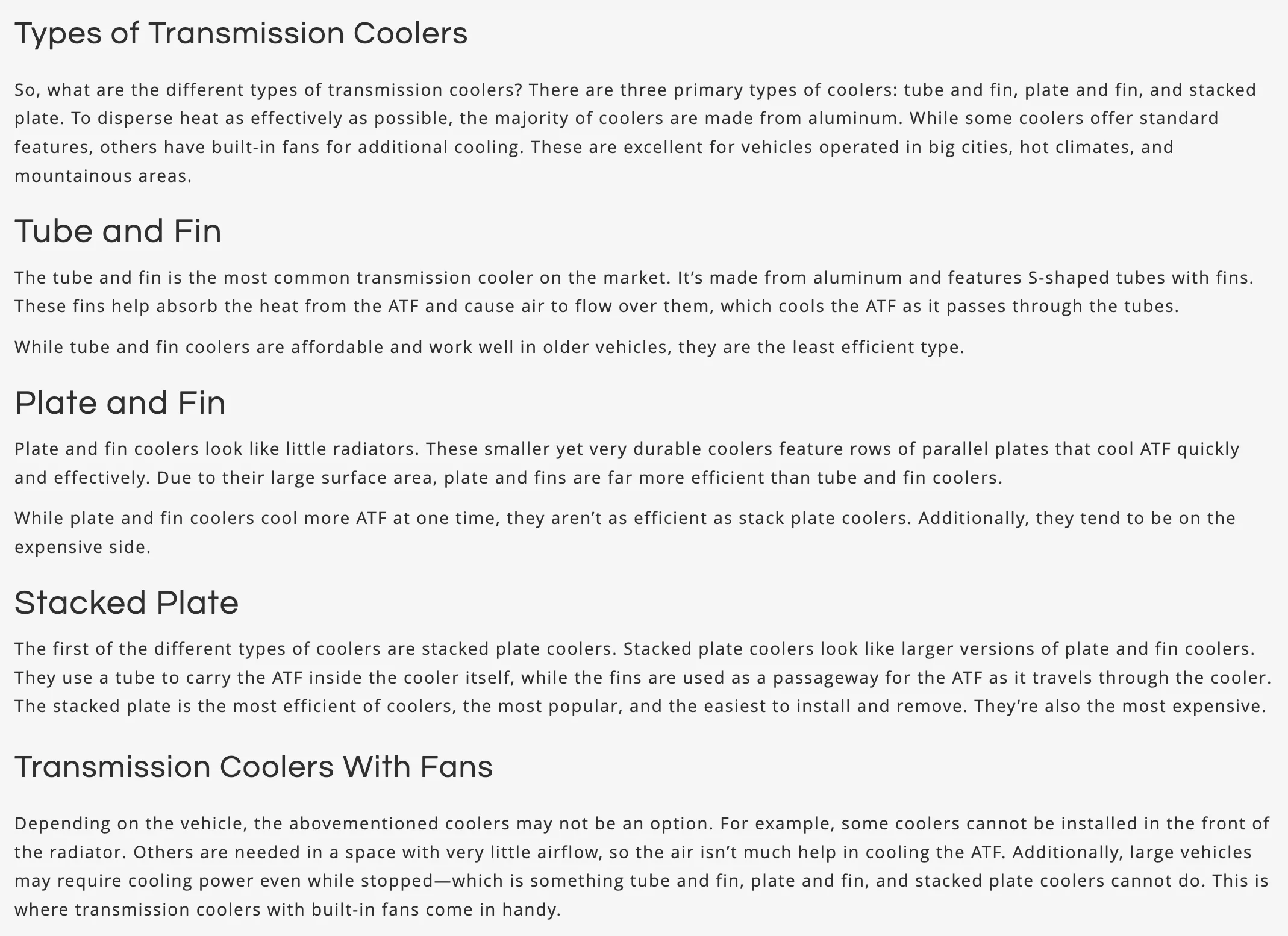

You also have different types of AT coolers to choose from

It's not you. I went with the factory cooler and all factory parts because it was factory. I did notice on a long road trip that transmission temps seemed to drop by about 10 deg F on average. I can still get to 200 F and above in stop and go city traffic. If I had to do the job again I'd probably go with a larger aftermarket. I think I put maybe 20k miles since the cooler install. I did a transmission fluid single drain/fill a few months ago and the fluid still looked pretty good.

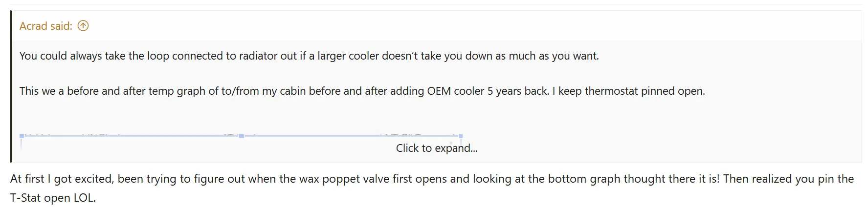

This is a before/after temp graph of to/from my cabin before and after adding OEM cooler 5 years back. I keep thermostat pinned open.

At first I got excited, been trying to figure out when the wax poppet valve first opens and looking at the bottom graph thought there it is! Then realized you pin the T-Stat open LOL.
Are these at the Torque Converter or Transmission pan?
Either way I would be pleased with those temps after the cooler install, very happy.
That’s a significant improvement even with the “small” OEM cooler. That suggests that maybe it’s not too difficult to keep temps in check if almost any cooler is added.
