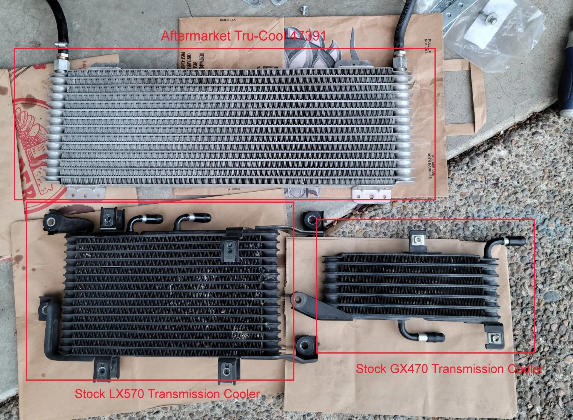

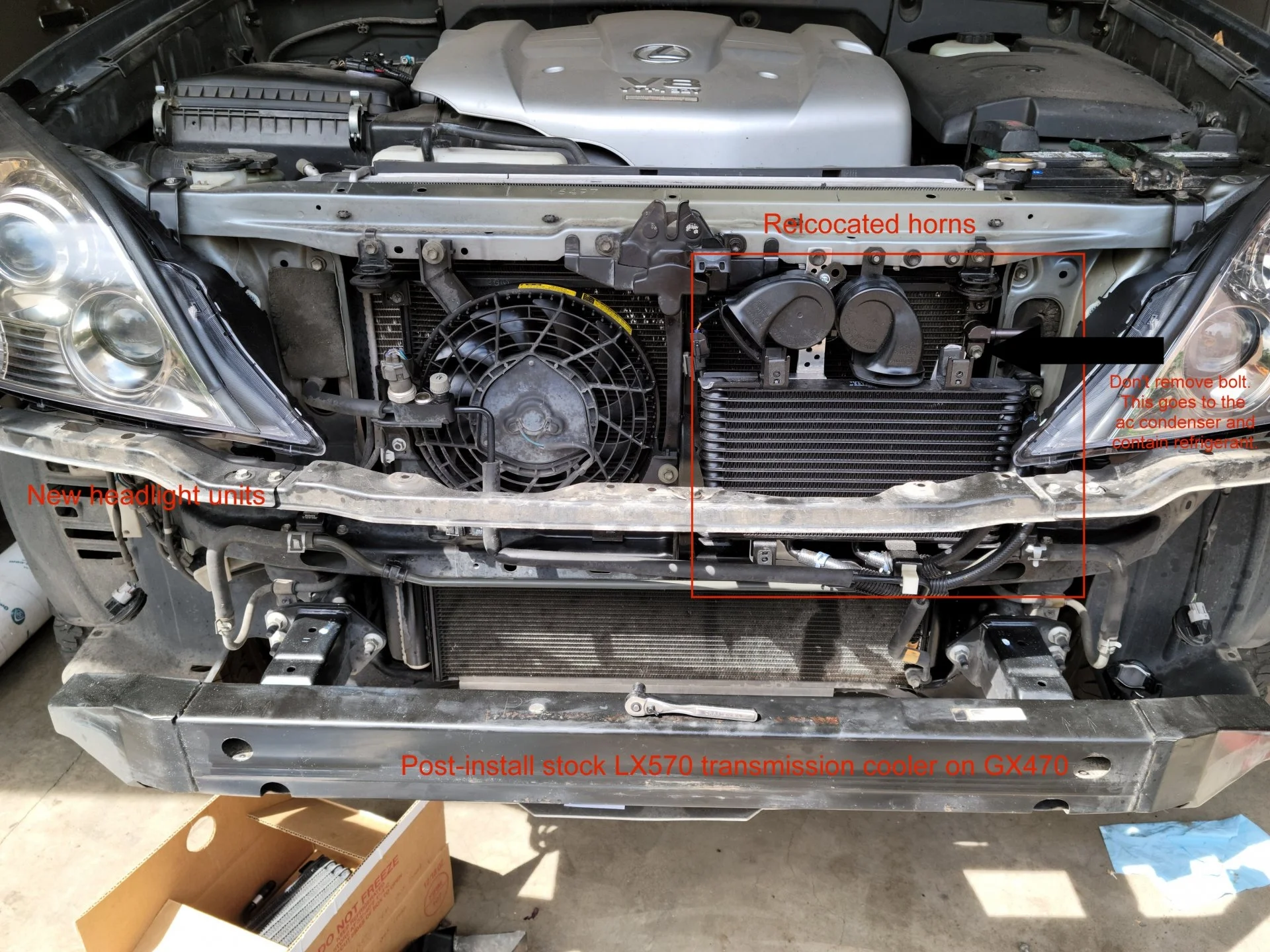

You can definitely put a larger transmission cooler in the OEM location. I had a large Tru-Cool 47391 (will not mount in OEM location) on the GX470 before I swapped it over to our LX570. Then I retrofitted the 200 series transmission cooler (which is about 2 times the size of the stock GX470/460 transmission cooler) into the OEM location for the GX470. Just go to the hardware store and get a couple of brackets or aluminum plates to fabricate your mounts.

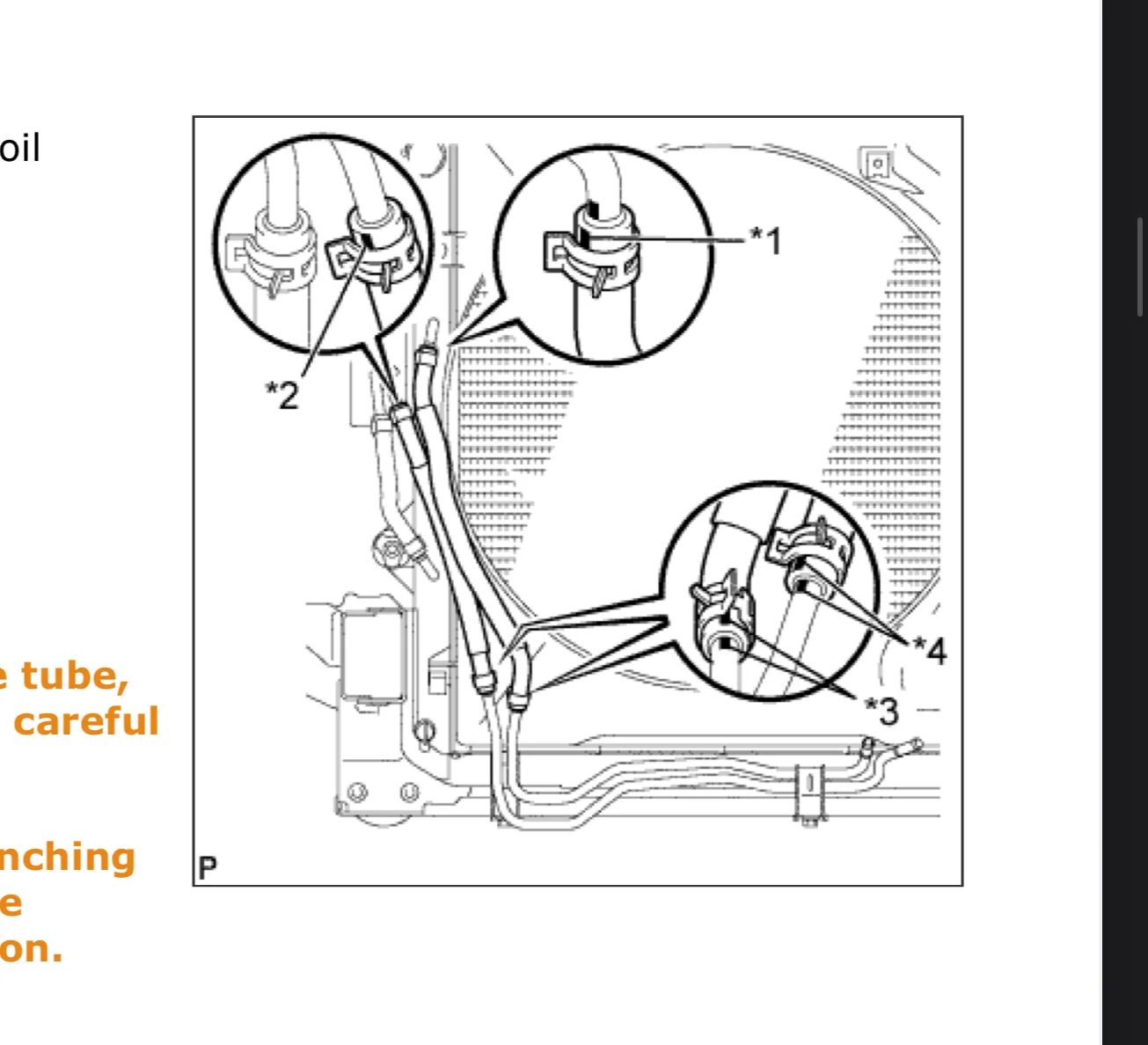

A few questions though - after watching a few install videos, I still want to confirm which of the hose nipples are the outlet from the radiator. It looks like the short, J shaped hose, with fluid leaving the radiator from that port and returning to the trans from there. From what I understand, the correct routing is transmission > radiator > additional cooler > transmission.

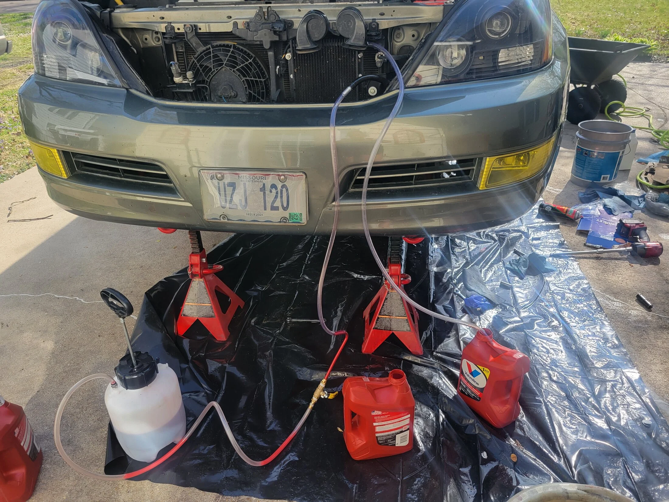

Honestly, I'd just do a full fluid exchange while you are in there anyway to avoid having to do it again in the future (with a pan drop too). You can do most of the fluid exchange via the cooler hoses that you will install for the 678. I obviously have a 470, but most of the process should be the same. Then you won't have to think about your trans for another 30-50K miles.

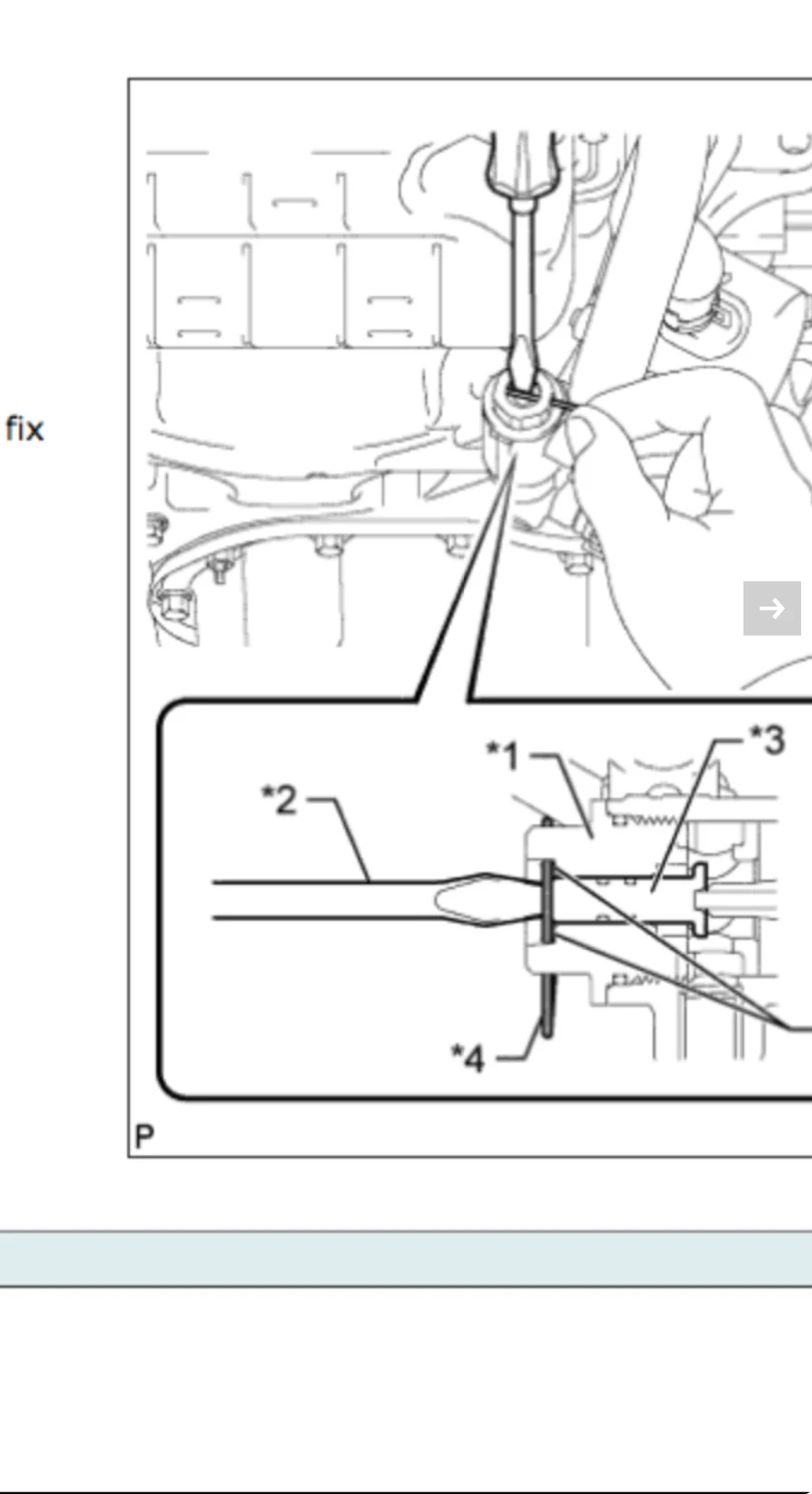

Make sure to pin the AT thermostat open when setting level
View attachment 3617657View attachment 3617658
Pin thermostat open with 1.5mm pin and idle until AT Pan temp is 115-126° in Fusion before removing overflow plug (one more new crush washer needed) to set ATF level.
Check. (and leave stat pinned open in my case) 👍

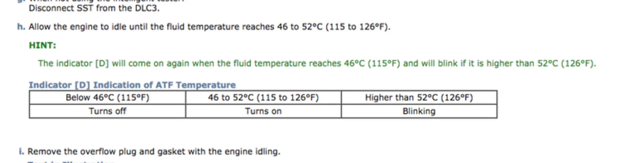

Great question and you made me look it up. Finally got the FSM for my 19 last night. Appears that is a yes.
Readers Digest version:
(c) Start the engine and idle it.
(d) Slowly move the shift lever from P to S, and then change the gear from 1st to 6th. Then return the shift lever to P.
HINT:
Slowly move the shift lever to circulate the fluid through each part of the transmission.
(h) Allow the engine to idle until the fluid temperature reaches 46 to 52°C (115 to 126°F).
(i) Remove the overflow plug and gasket with the engine idling.
(j) Wait until the overflow slows to a trickle.
(k) Install a new gasket and the overflow plug.
Torque:
20 N·m {204 kgf·cm, 15 ft·lbf}
