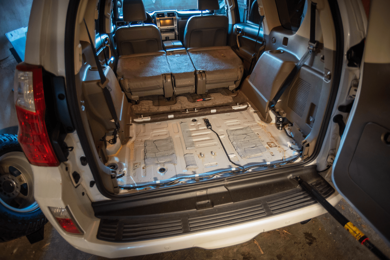

Like some other GX owners (and the original post), I was interested to recover some of the height and remove the weight of third row seating (that I could not imagine ever using)....
I like the Goose Gear solution, but didn't want to spend the money - and wanted the satisfaction of doing it myself (with talented son). I also want the flexibility to remove the platform and modify it as I learn more about how I use the truck. Driver's side will have oversized spare tire storage initially, and would be location for fridge enclosure mid-term.
There are a number of great resources, I referenced the work of Pachari Adventures on youtube for removal (he does a good job of sharing bolt size and showing locations) and then de Winj family (Australia) "Getting Liam's Boot Ready" 28 Feb 18 for install < Getting Liam’s boot ready >
Removal went pretty easy. The seat assemblies pretty heavy for being so compact.
For platform assembly, I bought 3/4 inch ACX plywood (sanded one side). Like the Liam build, I used one rectangular piece and used ribs underneath. I used three ribs (instead of four like Liam) : one just inside the rubber seal (3/4 ply in one inch strip), second across the four visible bolts (2x2 with cut outs), and third on carpet beyond the ridge (3/4 ply plus 1/2 ply). I took some time with a random orbit sander to get this smooth(er) and reduce chance of splinters when handling. At this point, four 2.5inch bolt in the second rib hold the deck in place.
Next steps will be to install the wooden vertical sides (probably with L brackets in a routered channel). Found some 5mm rubber exercise equipment matting at home depot that will likely go on top. I also have recessed L-track from US Cargo Control on order (and will router a channel for that).
If of interest to anyone, I can post more pictures once the rubber matting and L-channel are installed.
