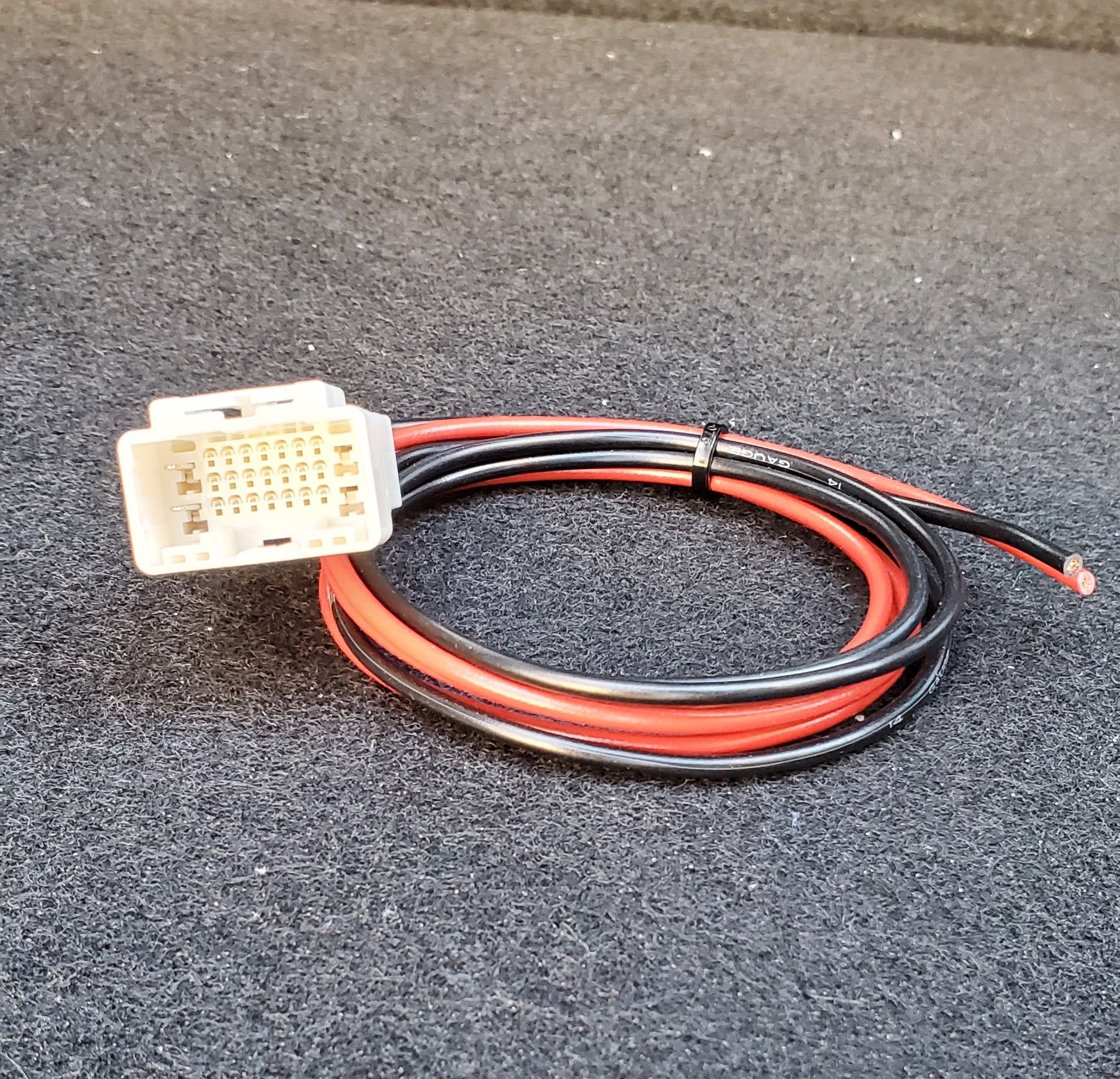

Nice! I make and sell these connectors. let me know if you have any questions or need a pair!

Already purchased two from you @THEOZMAN !!! Can’t wait to add the additional charging ports.
One thing about the seat tap is that’s it’s always hot. Wondering about a way to make it only on when keyd. The 12v panel
I got has a switch but that could easily get bumped by the dog or something.
I can see the utility, I’m just worried I’ll forget and drain the battery. More reason to get the duel set up going…
Understandable
