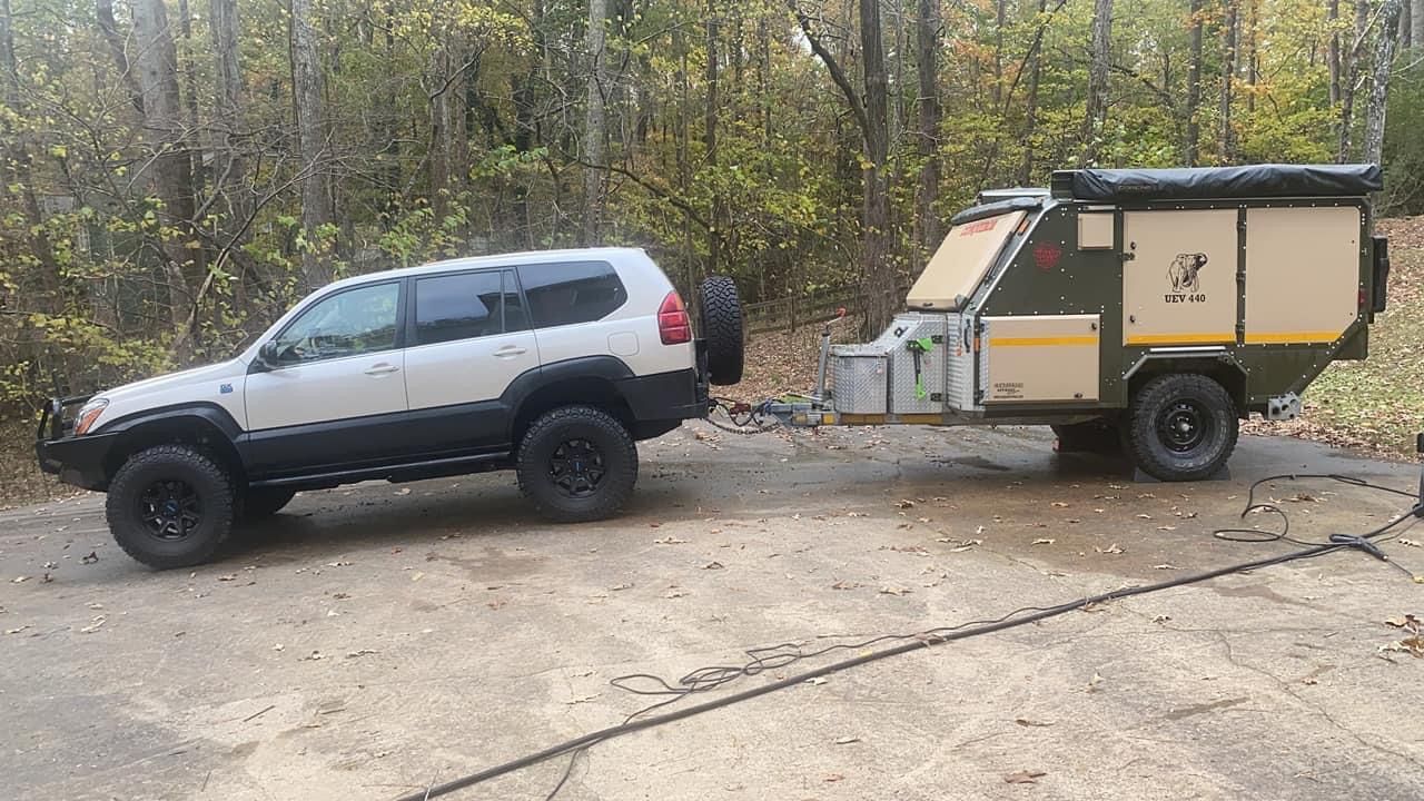

In July we ordered an 'Escapod' off road trailer
Built here in Coalville Utah...currently a 13 month lead time
We should have ours in mid April '21
Fully off road in mind...better suspension...dual 6 volt batteries...solar...inverter
My own 17" tire/wheel pkg....to match GX...heater....electric brakes...articulating hitch...etc
Color choice has been most difficult...but Military Green won out
Wife is more excited than me.......many many close 'Pod spots picked out to go camping
pic....'Pod spot

Very nice trailer! And I approve of the the OD (Olive Drab) color! 👍 And absolutely agree with using the same rims and tires as your pull vehicle!
One question, why dual 6 volt batteries instead of 12 volt?? I assume in series to create a 12 VDC system.
Because of solar?

Its a $275 option.......
my understanding the dual 6 volts will provide longer use time and more recharges
Correct me if wrong......sorta up in the air on this option

Two 6v batteries will usually give you more capacity (ah) than an equivalently sized 12v battery. More ah for the buck, so to speak. They are not cheap, though.
