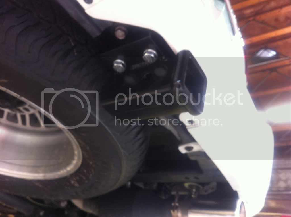

I went with the MetalTech hitch as I don't have plans to max out the towing capacity. It's a solid build as expected from the folks at MetalTech. If you have slightly larger tires in your future and plan to mount it underneath here's a heads up. My only niggle is the bottom flange of the hitch (mounts to the lower side of rear cross member) extends forward beyond the fore/aft width of the cross member. This extra material pushes the spare tire forward a half inch or more. I went from over an inch clearance with 255/75r17's (~32") to the panhard to approximately 1/2" +/- when I pull the tire aft when cranking it up. If you have a slightly larger tire go with the OEM bolt on, or plan to massage the MetalTech unit with a flap disk or grinder and some paint.
