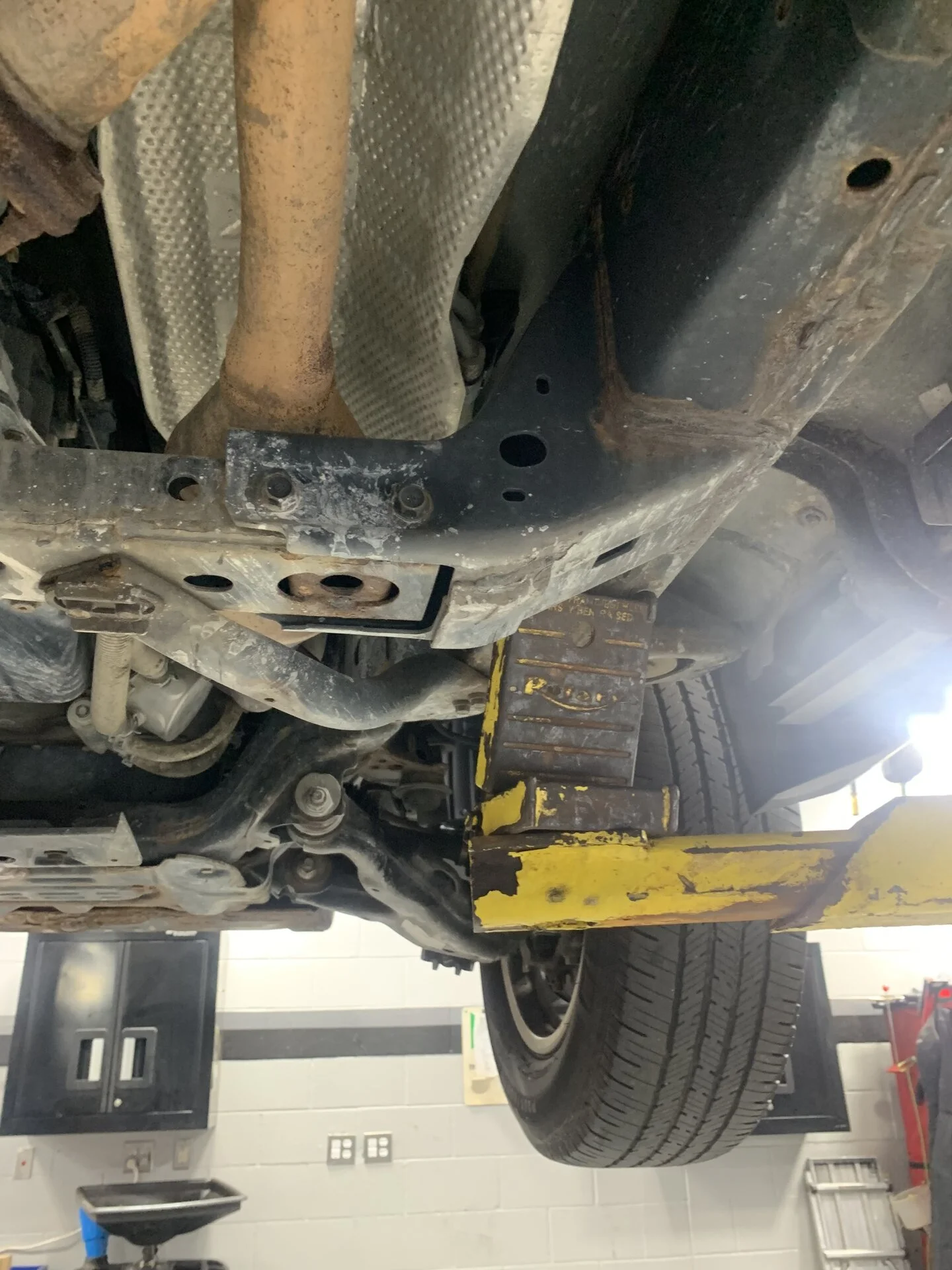

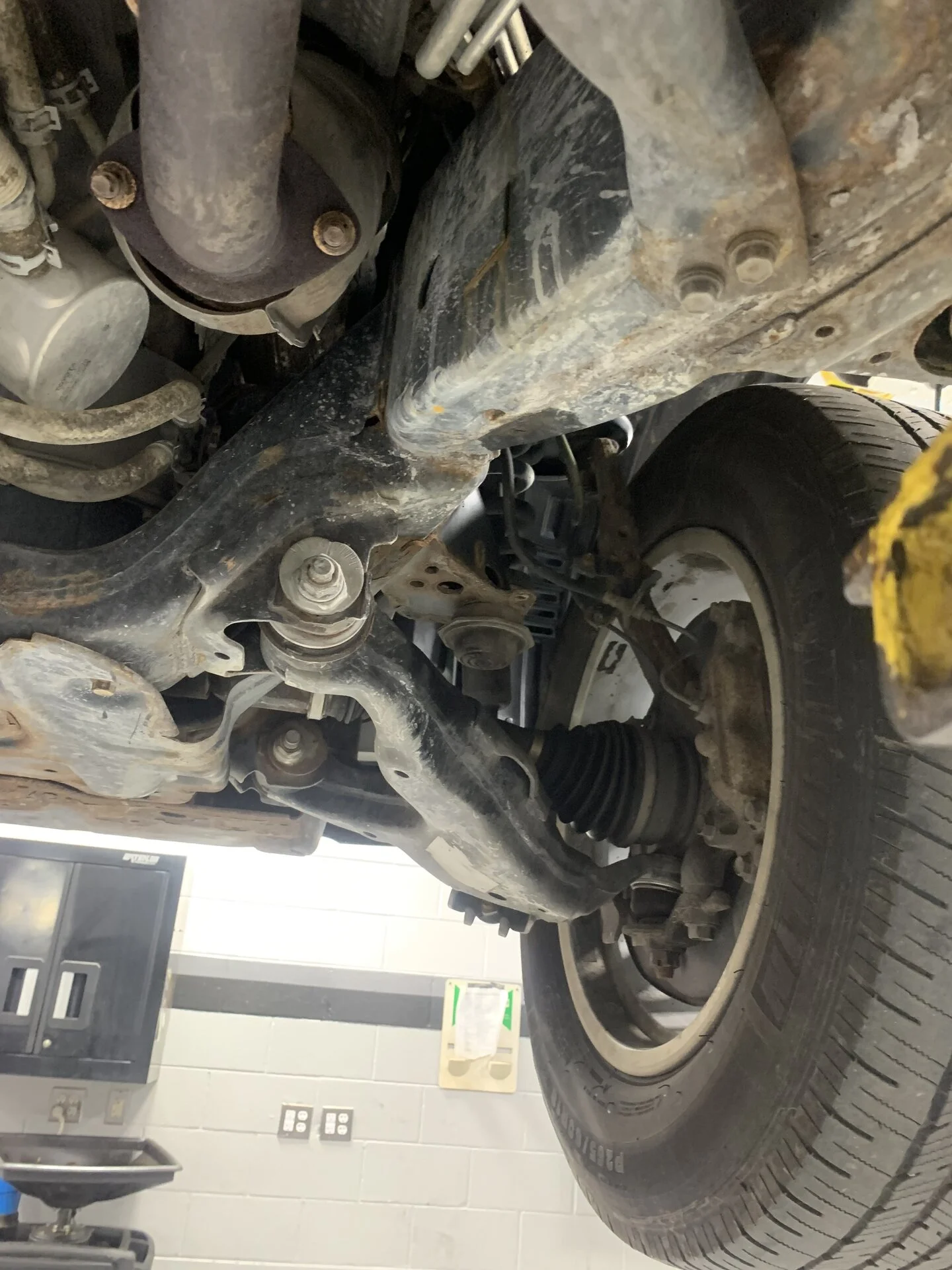

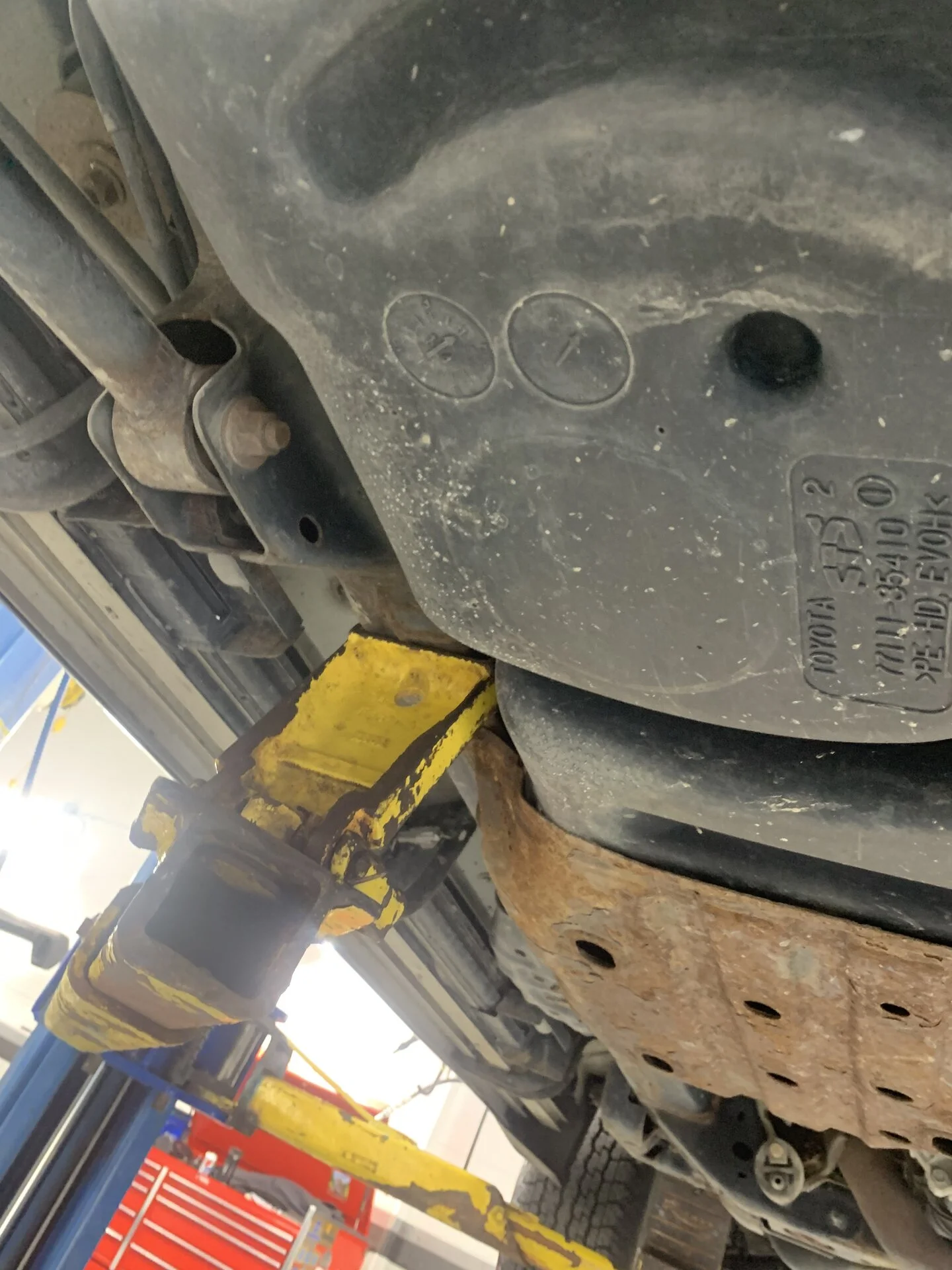

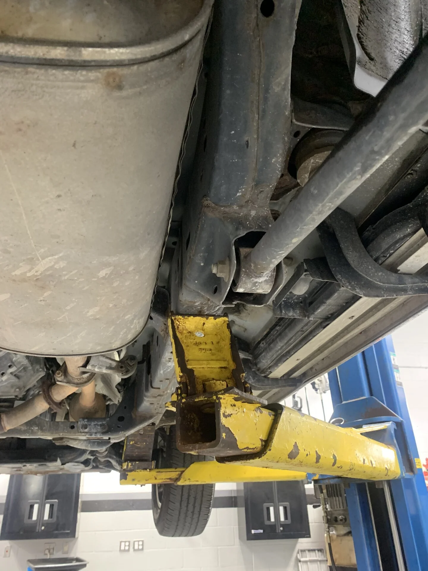

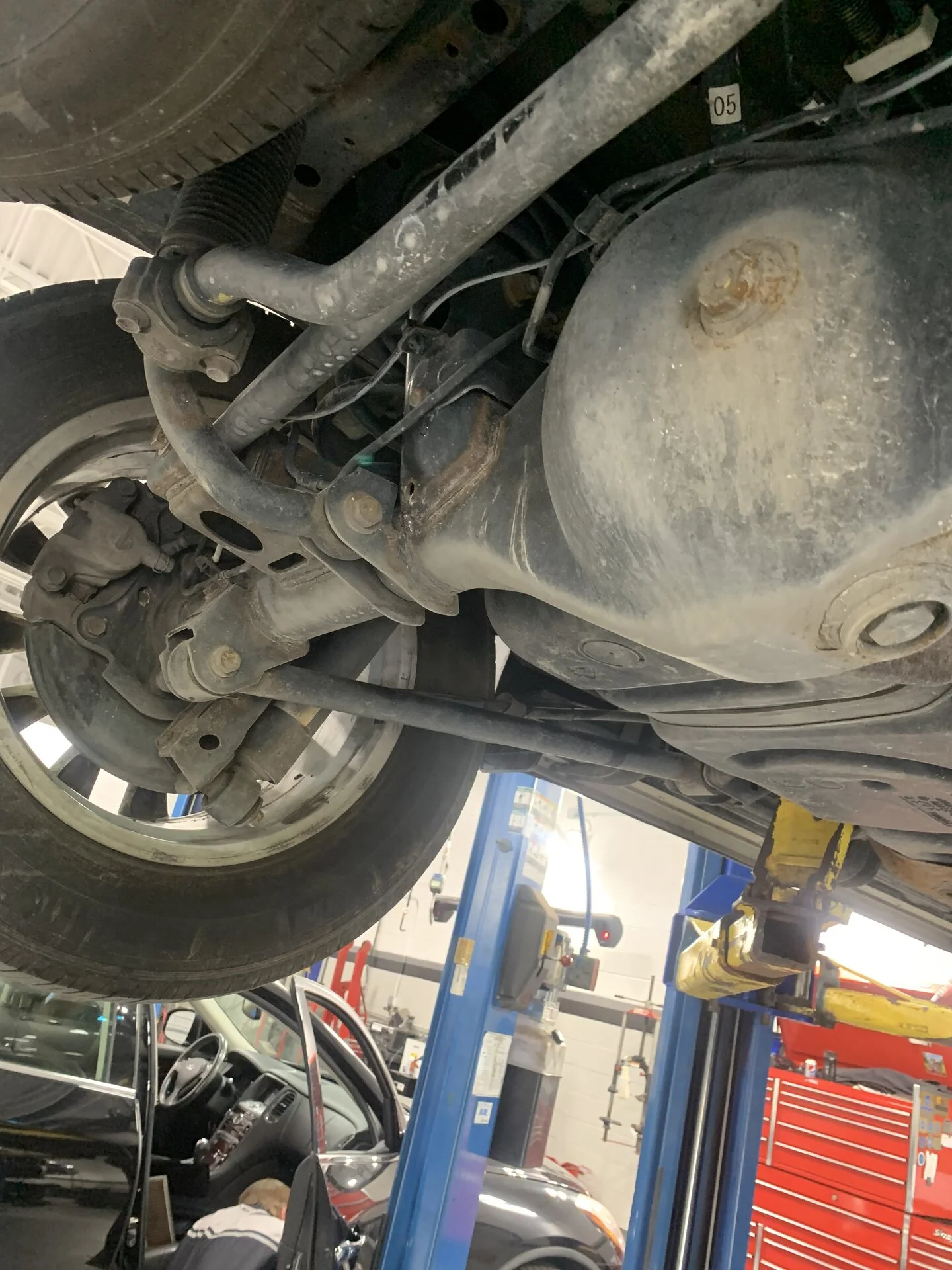

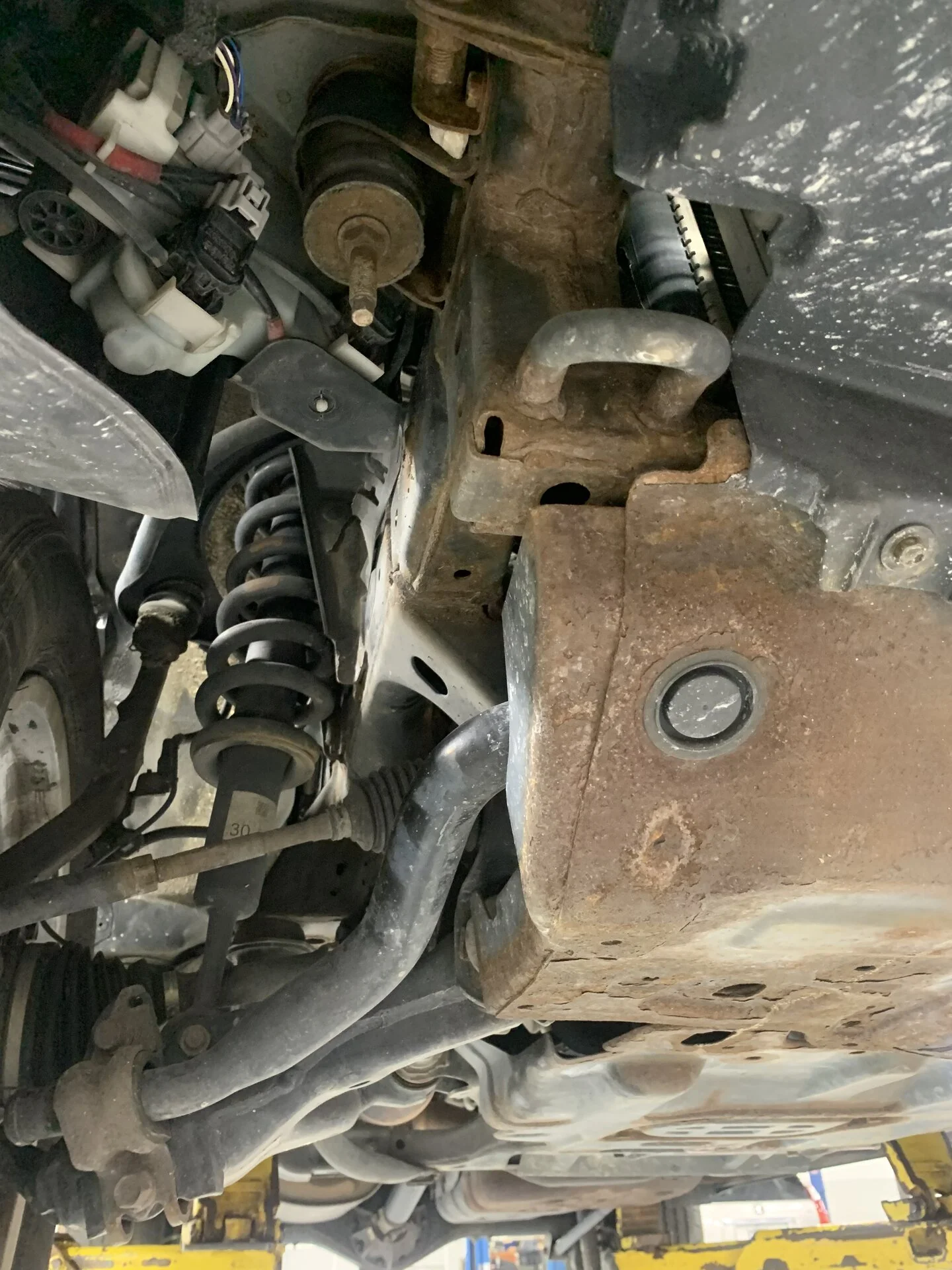

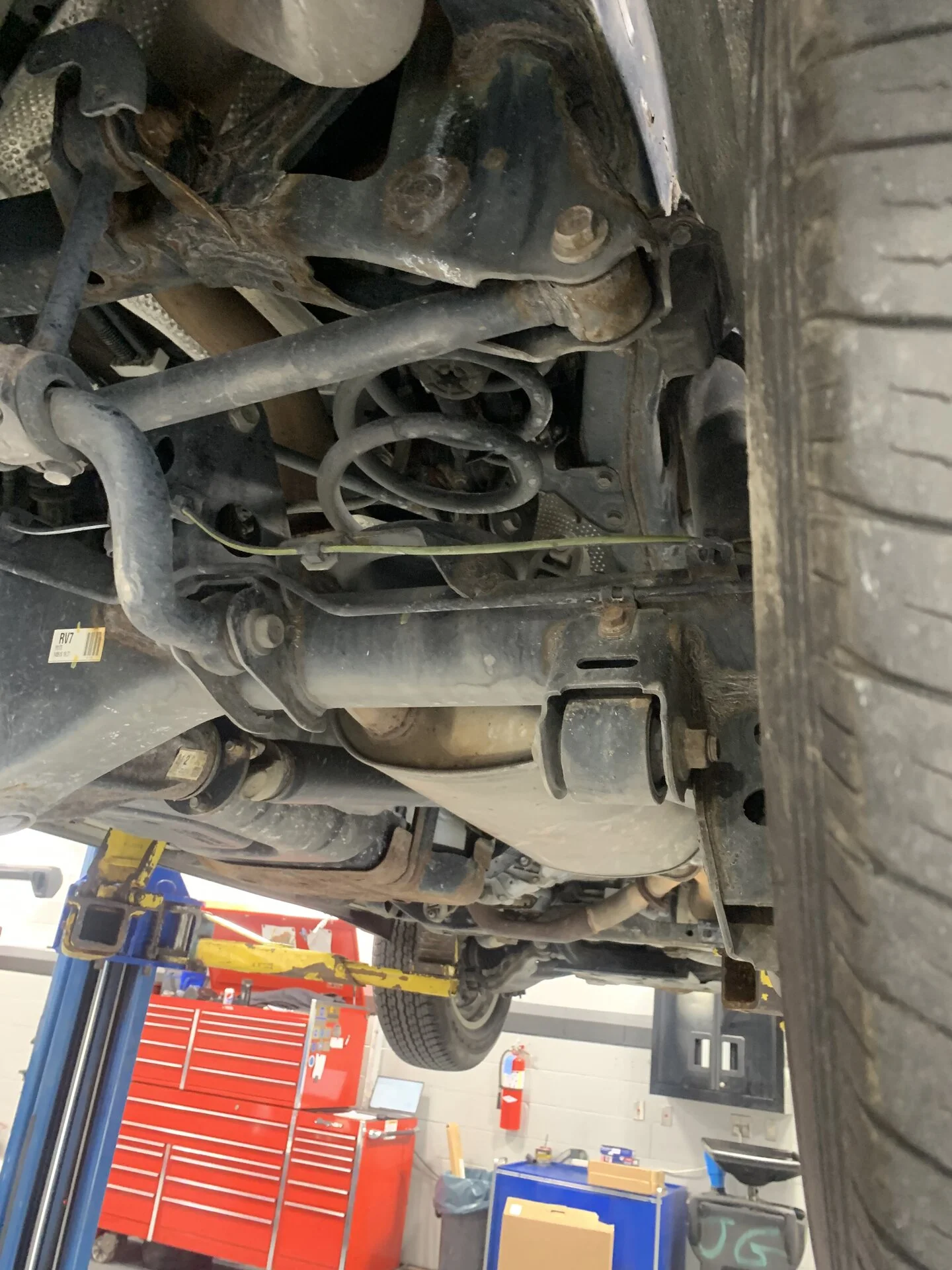

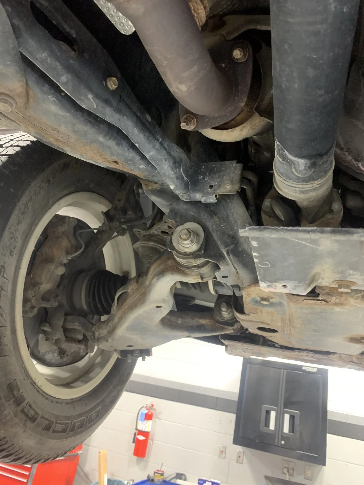

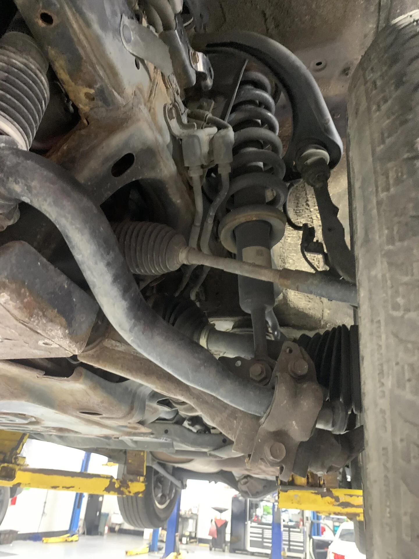

I have asked the dealer for undercarriage pictures. Should get them later today.
yeah, a NE vehicle with that many miles can easily be a rust bucket. What year is it?
Very good shape for a NE vehicle. Still, i would want to look inside the frame where the AC drip line discharges on it. And you'd need to give it a good undercoat (fluid film, woolwax, etc).
Damn he asked if I needed anything else before he took the vehicle off the lift.

With records of a trans flush 20K ago and an undercarriage like that despite being in the NE, it's telling a story of a P.O. who really took care of the vehicle. The only way the underside would be that clean is if they didn't drive it much in the winter or washed the underside regularly. I would say that based on the pictures and info you've provided on the service history, it seems like it could be a good buy (if the price reflects the likely need to replace most suspension components and probably other engine consumables due to wear). If the price is good AND you have a chance to drive it and it checks out I'd personally pull the trigger on it.
Do keep in mind that there is cost with shipping a vehicle 2/3 of the way across the country to buy sight-unseen - plus the risk of it not being what you were told when it shows up, and having limited availability to fight with a dealer located so far away in a different state. It's a risk/reward you'd need to balance with the GXs you have available locally and what they are selling for. There is value in going to look at one in person that doesn't require shipping, even if it is a few K more, as the transaction will always be lower risk. You could always fly out there to look at it, but there is also a cost involved in that.
Man, I HATE rust after buying a PA/MD/VA car (that wasn't even that bad). I just don't want to deal with it at all. But that doesn't look TOO bad (unless it's like a 2018 or so). If you're a DIY guy, get an induction heater gun. Oh, and fly-and-drive it. Take your wife, and make a NE fall colors trip if it don't work out...
