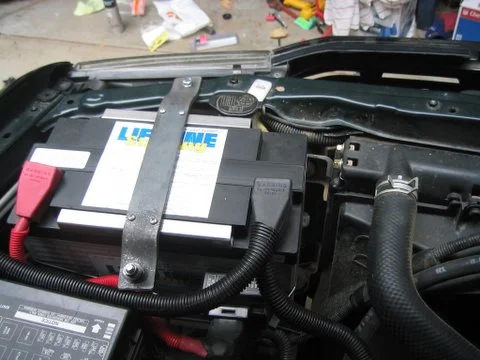

  11. norcal '99
    norcal '99
    Messages:
    24
    Likes Received:
    Joined:
    Mar 25, 2005
    Location:
    SF Bay Area, CA
    Lifeline Group-31 Battery Installed
    I got the Lifeline battery in. It fits great and the LC turns over really well.
    [​IMG]
    I built a new hold-down from 1/4" steel and 3/4" square tubing as spacers.
    I extended the positive cable by removing the battery clamp from the starter cable/fuse holder that normally attaches to the battery post. It's just one bolt. Then I attached a 15" positive battery cable. The fuse holder assembly was then strapped to the battery with some really long zip-ties and double stick tape.
    The negative cable is long enough to connect directly, but the grounding wire to the body needs to be disconnected. I replaced it with a 19" heavy gauge cable connected to the top of the battery post. The battery posts of this battery are
    dual purpose so they are threaded on top.
    I've attached a picture of the final result. If you want more details let me know.

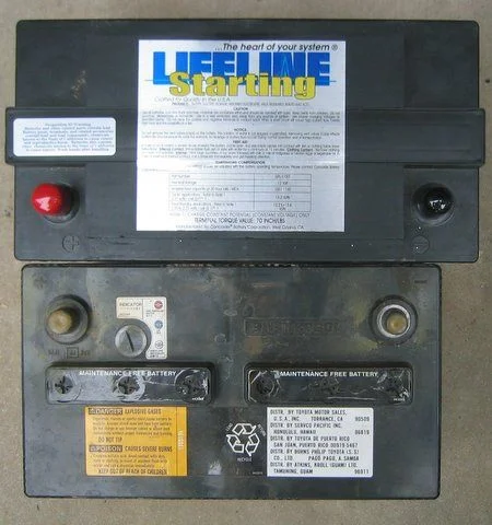

  12. norcal '99
    norcal '99
    Messages:
    24
    Likes Received:
    Joined:
    Mar 25, 2005
    Location:
    SF Bay Area, CA
    More pictures
    Some pictures of the old and new battery.
    Also the original hold-down and the new one.
  13. norcal '99
    norcal '99
    Messages:
    24
    Likes Received:
    Joined:
    Mar 25, 2005
    Location:
    SF Bay Area, CA
    Before and After
    Here's the old battery and the new one.
