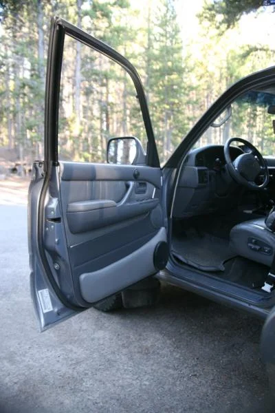

This is one I saw that I liked. I'm hoping to have something like this eventually, except I'd still have speakers in the stock location, and I wouldn't have the tweeter down by my feet.
