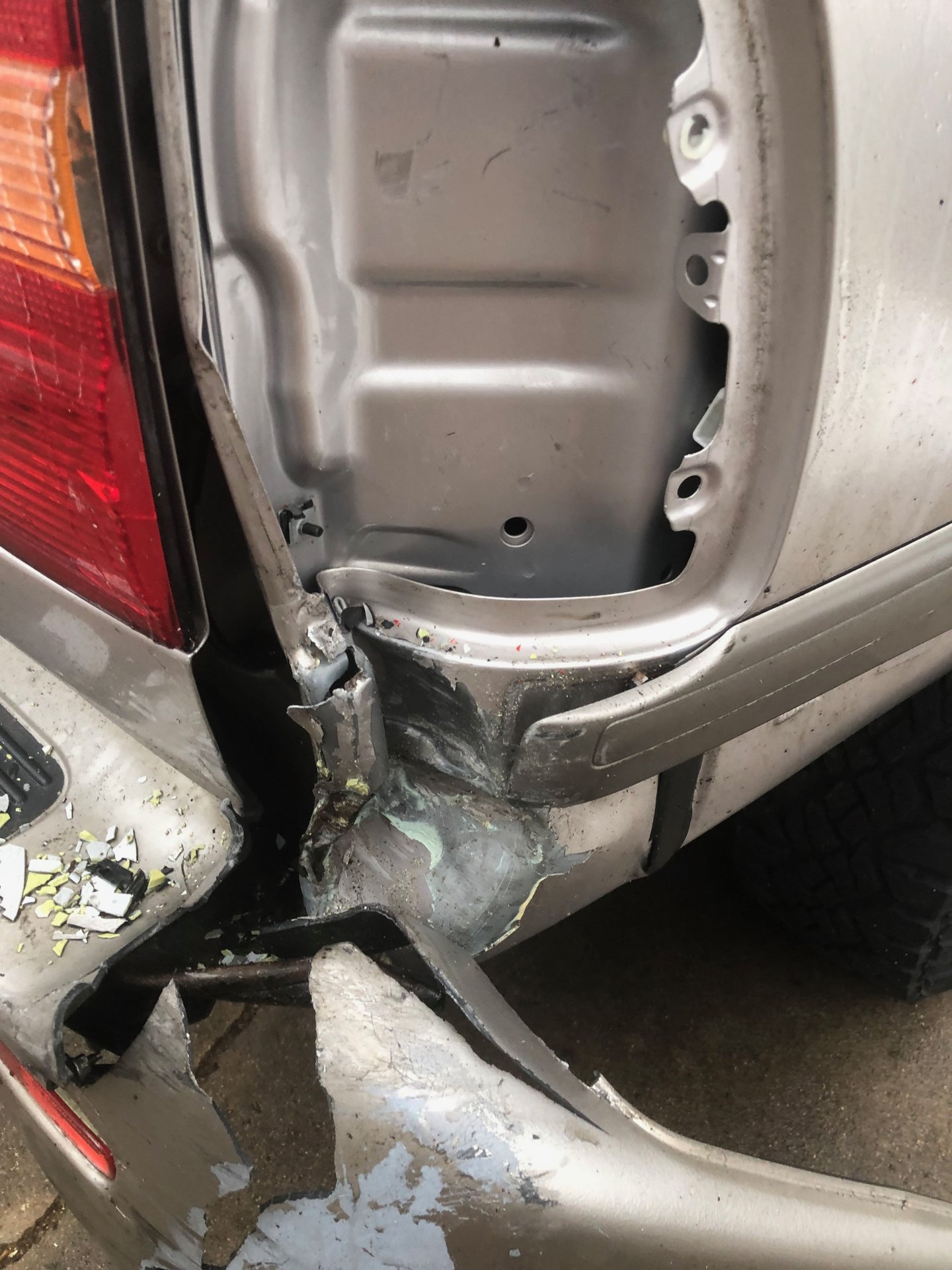

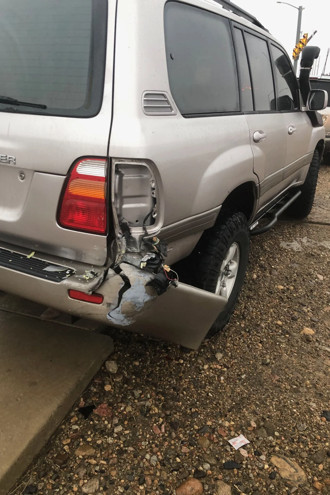

Another car lost control on ice and clipped the right side of the bumper and rear quarter panel on my 2000 LC. Most of the damage was to the bumper (which I am going to replace with an aftermarket) and to the rear-tail lamp housing. It's folded in on itself pretty good. Their insurance (Root Insurance) has accepted fault and sent an estimate and check for repairs based on pictures that I sent them. I have gone to a body shop and they are not sure that they can pull out the damage. If they can't pull it out, then they would have to replace the entire rear quarter panel. I am not to excited about this option.
I have been building it up to use as a trail rig, so I don't really care if it looks perfect. I just want to be able to fit the tail lamp housing in there and paint it so it doesn't rust. All the body shops I have talked to only seem geared to making it look new, which feels like overkill for what I want. I am temped to try and pull it back into shape myself and then have it painted. Is that a bad idea?
Anyone have any input on how to fix this cheaply so it's functional and doesn't rust? It would be nice to use any leftover insurance money for other mods. Thanks!

Hammer + pliers + paint.

I am on the fence. I am really tempted to start working on it to see what I can do. However, because it has a large fold I am worried it is going to start tearing if I start bending it back.

Anybody tackle body work like this by themselves? Or should I leave it to the pros?

I have, and if you are making a trail rig this is a great way to learn. Just go slow and use the replacement light housing guide you as you shape things.

4. Rust prevention requires essentially perfect body and paint work. Good body and paint isn't just to make it look nice. It's to repair the barrier between your rust-prone steel and the elements. I've done extensive DIY body/paint work. It's a ton of work no matter what. Shortcuts aren't tolerated if you want it to look anything close to normal. The body shops refuse to do half-ass work because they know they'll just be doing it over.

Very important to have a good seal at tail lights (Especial tail light on RR, where exhaust tail pipe is), tail gate and hatch. Exhaust can enter cabin. Even having rear wing windows open while engine running is dangerous, and warned against in 100 series OM.
If just doing a low budget, bang it out! Consider filling cavity with closed cell spray in foam (window & door), to create air barrier. Even rust or drilled holes in quarter tip, need sealing.
Root initially came back at a little under $4K, and that is just for pulling/bending back. Majority of that is body and paint. The back lower gate has a small scuff and is a little sticky, but I am guessing that is from the rear quarter panel getting pulled away. I think there is a slight increase in the gap between the tailgate and the quarter panel on the side that got hit.
All the body shops I have talked to are on the fence of whether it can be pulled or not. Right now I have it scheduled to go into Longmont Autobody and Glass, who came highly recommend. They are going to try and pull it out. If that doesn't, work I think it will likely become a total fight with the insurance, given that just the rear quarter panel is around ($1200-1400) plus a massive amount of labor to replace. I am really pushing them to try an pull/bend it back.
Thanks for all the responses. If it was in a different location or less severe, I would have tried to pull myself. 2001CL makes some a great point on needing to have a good seal. I am defiantly intent on keeping this car as long as possible.
