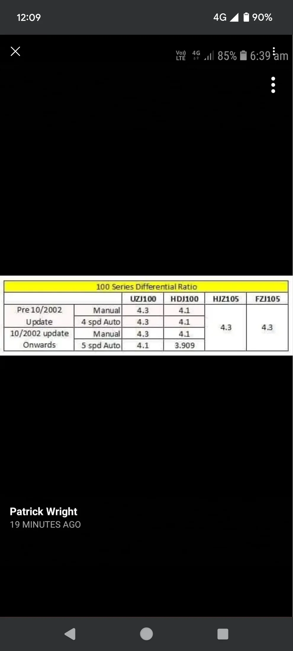

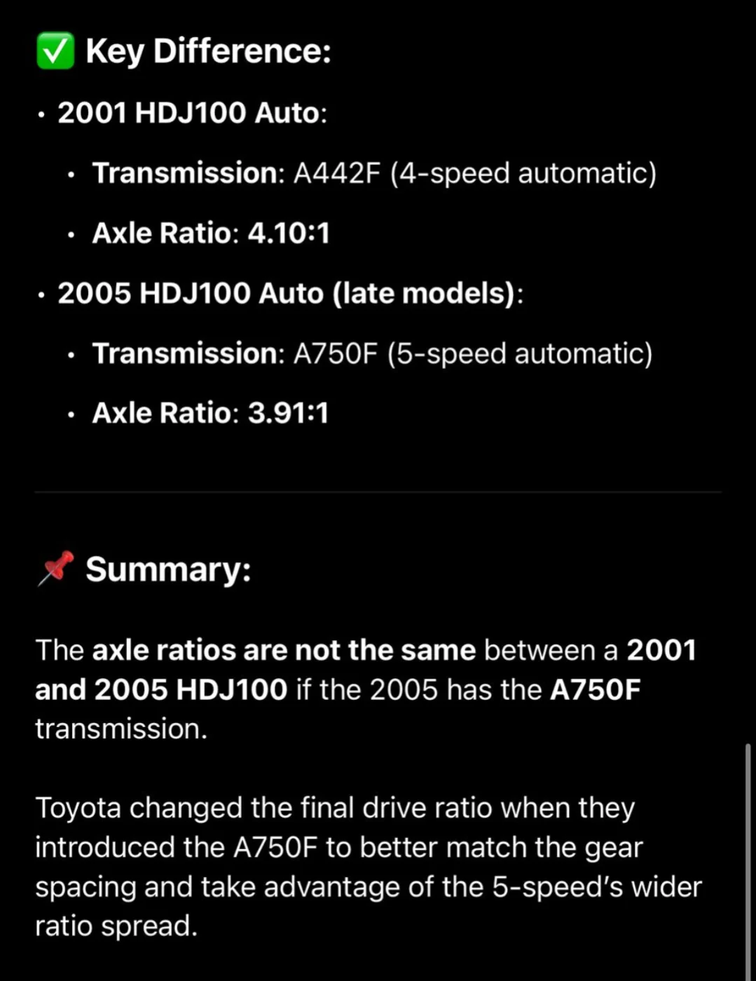

I've had it on good authority that 4 speed diffs had a different ratio, but there are various threads contradicting each other. I think the complicating factor is this the difference between petrol Vs diesel!
Can anyone categorically confirm what ratio mine is so I can source a correct replacement?
Pics attached of various contradictions!
