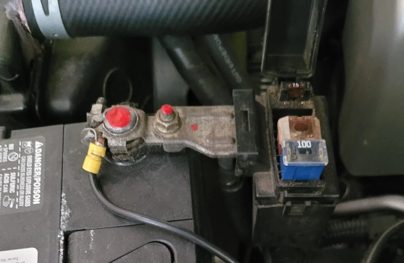

Just wondering, is it possible one of these could cause a No Crank issue but allow Horn and Headlights to work?
This is a photo of my my 2002 LX. I'll go to Charlotte tomorrow to check it out.
Is this the AM2 fuse you mentioned?
It is possible since there are about 5 branches of link inside the black box. I am not in front of my computer with wiring diagram so I can't confirm the answer for you.
The AM2 is inside fuse box behind the battery.
Fusible link for 2004 is different from what you showed.
The problem could be loose connections, bad connections due to corrosion, or low battery charge. It could be bad starter too but I know it has low miles.
