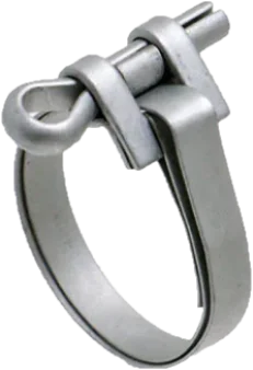

hi,
For fans of the 60 series and those who love original parts to return their old trucks to their original condition, I present to you a part compatible with part number 90460-24039, and the compatible part number is 87124-28030, note: ( attached pdf) ...... Good luck old baby.

have you test-fit the new clamp part # ? 87124-28030
I just ordered it and if it arrives I will test it and let you know to confirm.

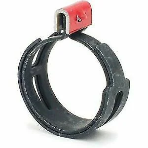

Why not just get the correct supersession? 90467-22004 which is significantly easier to install and remove.
The clamps above are good for factory installation but they are terrible for anything else (except a true concourse restoration).

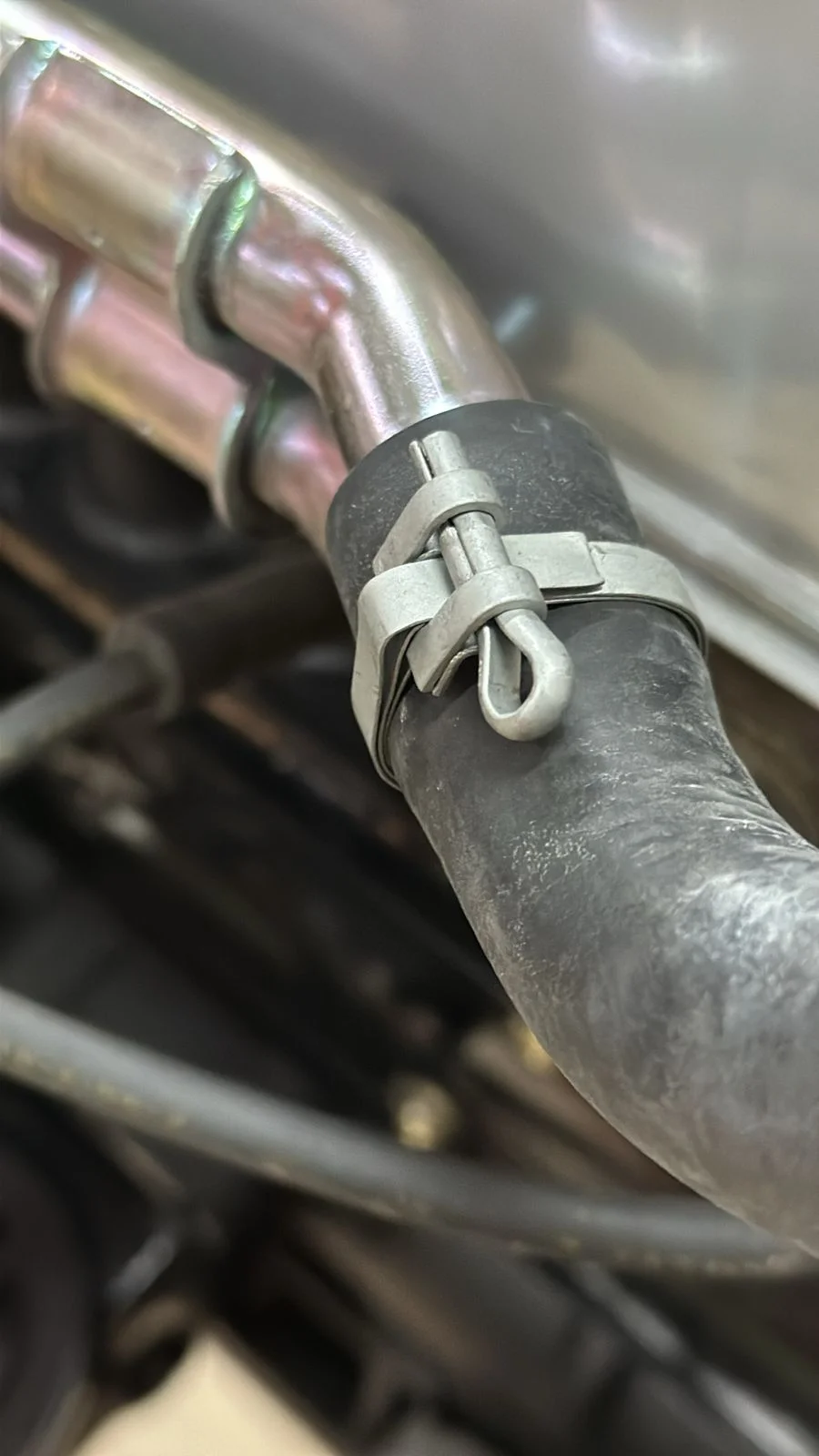

Just I want it to be the same as the original 😉... and this is the first time I've to replace it after about 35 years.

your doing a true concourse restoration here ......
nice work :) 🍻🍻 :wrench::wrench::wrench::wrench::wrench:
That's right, buddy...you have a power of observation to be thankful for 👌
How do you tighten those? I've only ripped them out, never installed one.
Hi,
very easy.... The hardest part is getting the clamp 😅... The method is to pull the staple out a little, then insert the clamp into the hose, insert it into the tube, then apply a little pressure on the clamp and push the staple clamp into place... I hope I was able to explain. Good luck

Backtracked to this while researching replacements for the other limited & NLA clamps originally called out for the FJ62; specifically the front & rear heaters, oil cooler and thermostat bypass hose. I also stumbled on 90467-21010, which appears in images to be a little more stout given the "double" band it has. Am I correct in presuming that allows better retention of the spring force over long term heating and cooling cycles? Would this also be an acceptable spring clamp to use, do you think?
Edit: this would be for the 16mm ID hoses in the system. IIRC there are a couple that are 13mm. Gotta crawl underneath my 62 and check to be sure.
