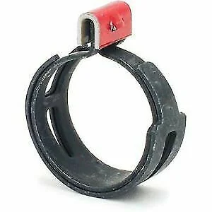

Backtracked to this while researching replacements for the other limited & NLA clamps originally called out for the FJ62; specifically the front & rear heaters, oil cooler and thermostat bypass hose. I also stumbled on 90467-21010, which appears in images to be a little more stout given the "double" band it has. Am I correct in presuming that allows better retention of the spring force over long term heating and cooling cycles? Would this also be an acceptable spring clamp to use, do you think?
Hi,
I believe that Yes, I think you are right, as its design is more practical than clamp No. 87124-28030, and as I mentioned previously, it is only for those who wish to preserve the original parts from the factory in addition to ease of use without the need for a specific tool. Good luck and thanks for your mention of me.

Just as a little more info for anyone coming across this thread, I just found out that the 90467-21010 is listed as a viable substitution for both the 96112-10250 and the 10250 wire style clamps (applicable to BOTH the 16mm ID and the 13mm ID heater/coolant hoses). Seems a little odd, but I guess if it covers a wide enough diameter range with sufficient clamping force that it'll work for both, that simplifies it a great deal for someone doing their own hoses and wanting to go the spring clamp route.
Though they are considerably more costly than the wire style clamps, being $1.85 through Partsouq and $3.74 through ToyotaPartsDeal :oops:
EDIT: As it turned out (and I had forgotten to come back and clarify after the fact), the 90467-21010 will NOT work on the 13mm ID hoses due to not holding tight enough. They work great on the 16mm hoses, but I've not yet found viable spring clamps for 13mm ID hoses. I simply haven't taken the time to look again yet, since my rear heater is removed in hopes of refurbishing the hard lines.
