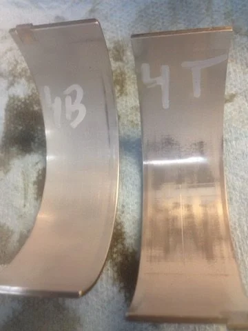

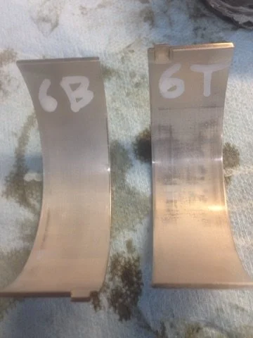

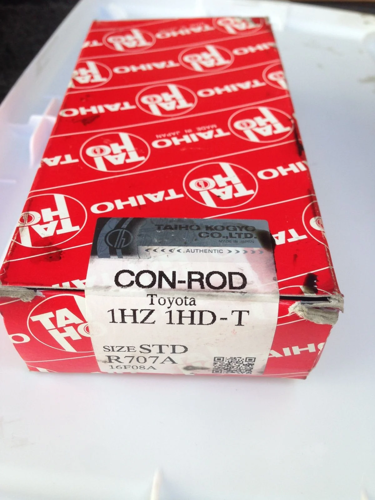

Completed replacing the BEBs (Big-End Bearings, aka Connecting Rod bearings) along with the connecting rod cap bolts, since the old ones do stretch a little. It took me 5 hours to complete it. I also let the oil pan settle and FIPG to form over night before I filled it with oil.
Also, plastigaged and numbers were within range, crank looked real good. I also had retired Toyota mechanic swing by and take a look at the internal, journals, crank and the bearings, and he thought the engine had 10-15k miles, he was quite amazed at its condition.

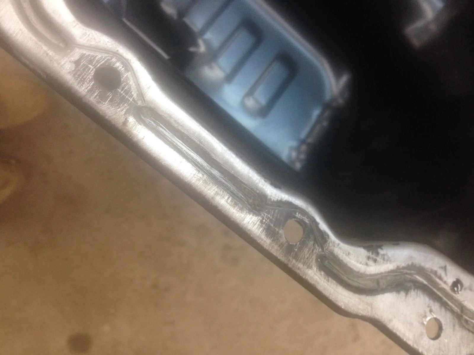

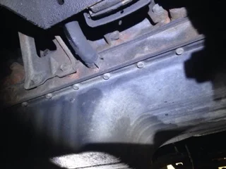

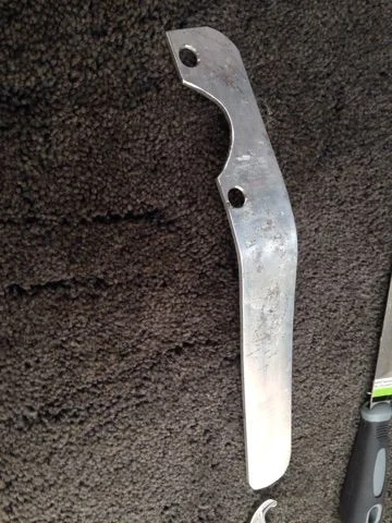

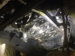

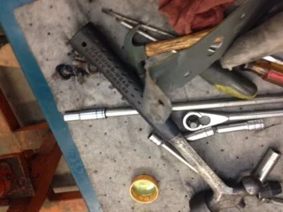

The oil pan had never been removed as far as i could tell, the FIPG was whitish/beige color and it looked like it wasn't applied manually. I also took a blow torch to the pan after I cut the FIPG with my awsome tool pictured below. Its a 20ga AL Simpson timber tie, angled at 90 deg. Another mud member had used it and it worked beautifully. I also removed the two transmission brackets on either side of the oil pan, made life much easier.
32mm socket to be used on the front of the crank to turn to get to the other bearings, have to remove the small inspection/bash plate.
Also, when installing new cap bolts, its a good idea to mark the bolt with a dot with a paint marker so that the 90 deg (27 ft. lb. + 90 deg) turn part is easy to gauge.
Here are pics of the pan before and after removal.

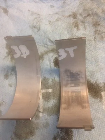

BEBs, T for top and B for bottom.
None of the marks had any depth that I could feel with my fingers, they were pretty superficial and look worse in pics. The tops were much worse than the bottoms.
Wire wheel on the oil pan removed all of the old FIPG. If you use the OEM FIPG, make sure it comes with the extracting tool, its a small tool you place on the end of the tube and rotate which forces ~100% of the material out of the toothpaste type tube, I shall use it on my actual toothpaste tube.

This is the tool I made out of a flat Simpson timber tie to cut the old FIPG in place. once inserted, it can be easily hammered down the length of the oil pan.

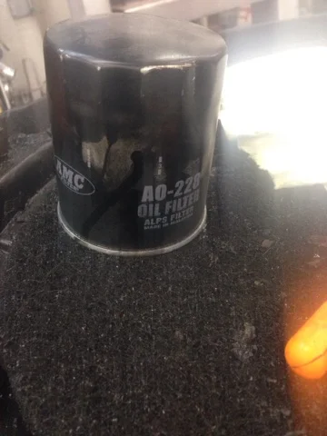

90915-30002 is NOT the same as the 90915-30002-8T (made in Thailand), search and you will find the details. Also, this is the oil filter what came off of it, maybe it was the one used in Japan. I can't find it online anywhere but its build quality was quite nice, I should have cut it in half.
AMC brand, AO-228, made in Malaysia.

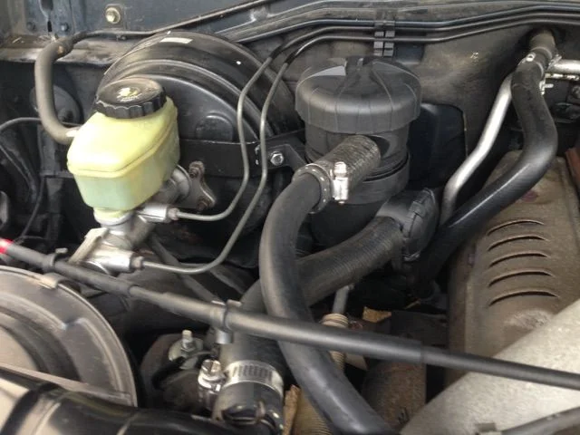

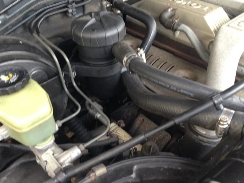

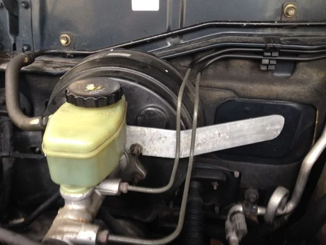

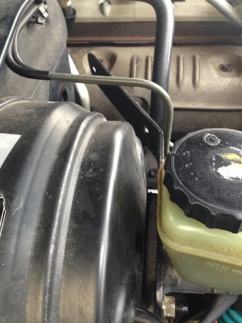

Installed a Provent 200 this morning.
I thought this would be a nice spot for install, right where the brake master cylinder mates with the brake booster.
1/8" AL flat plate with some holes, cuts and a bend. It's a little tricky to squeeze the bent piece behind the reservoir and to get the studs through the holes, but with enough patience and iterations, it is do-able. I had to re-bend the AL 4-5 times to get it right. It's awfully close to the brake lines, but its quite stable.

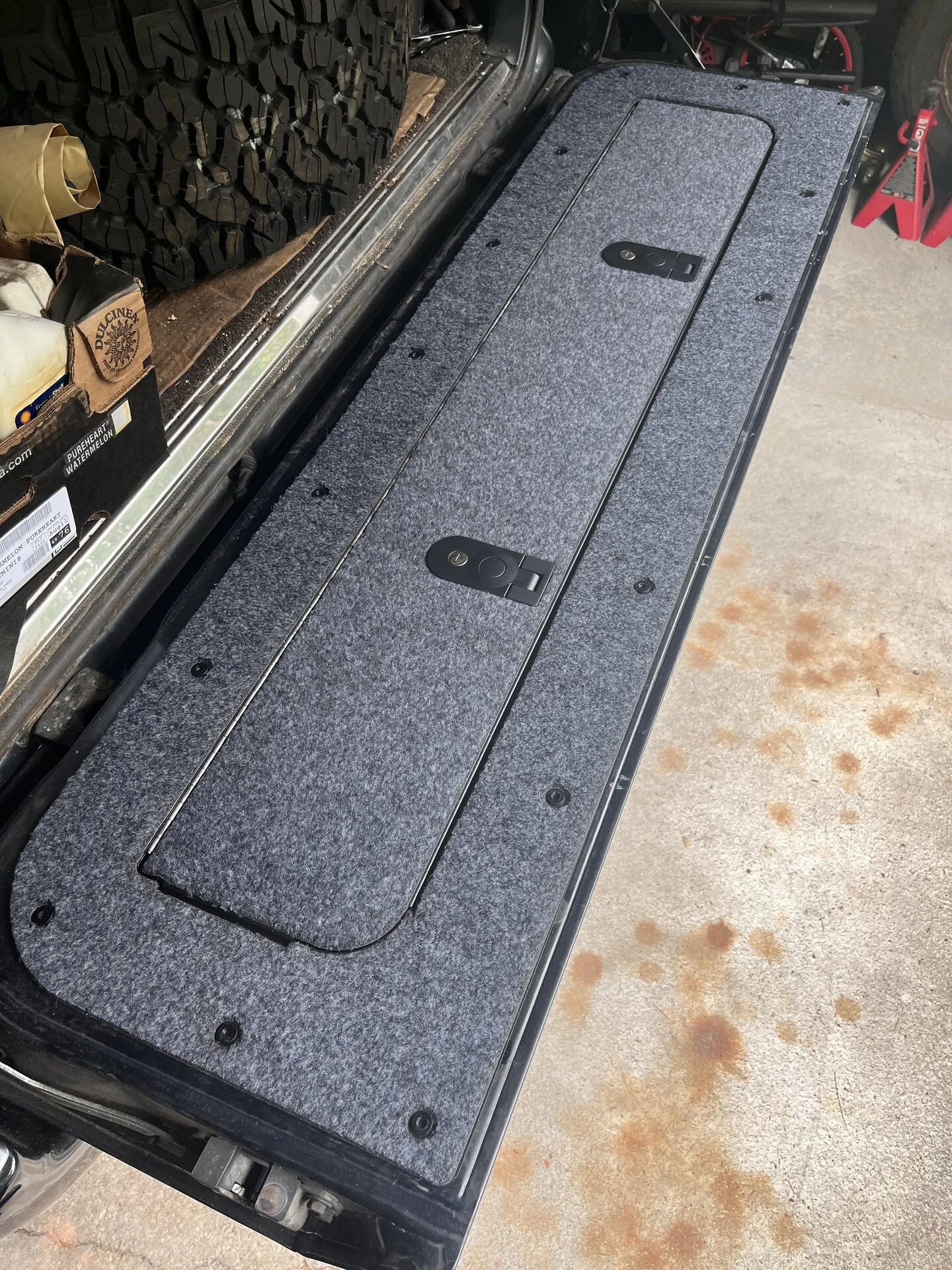

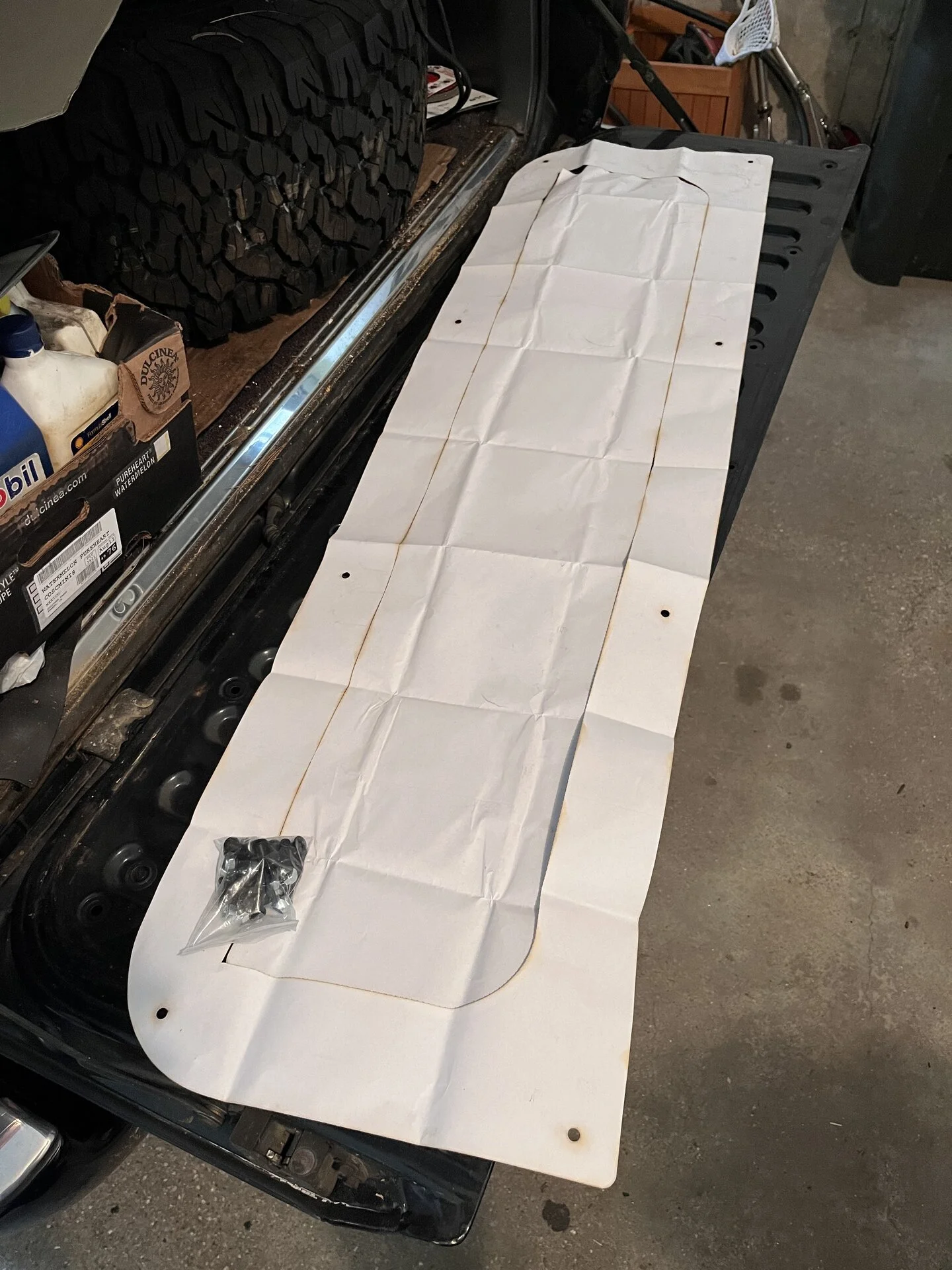

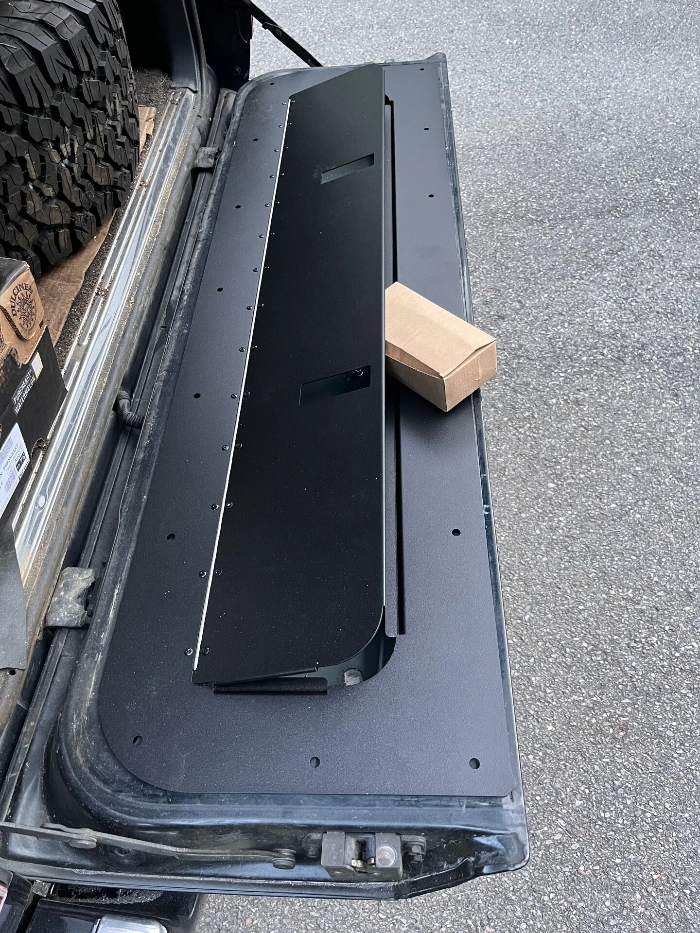

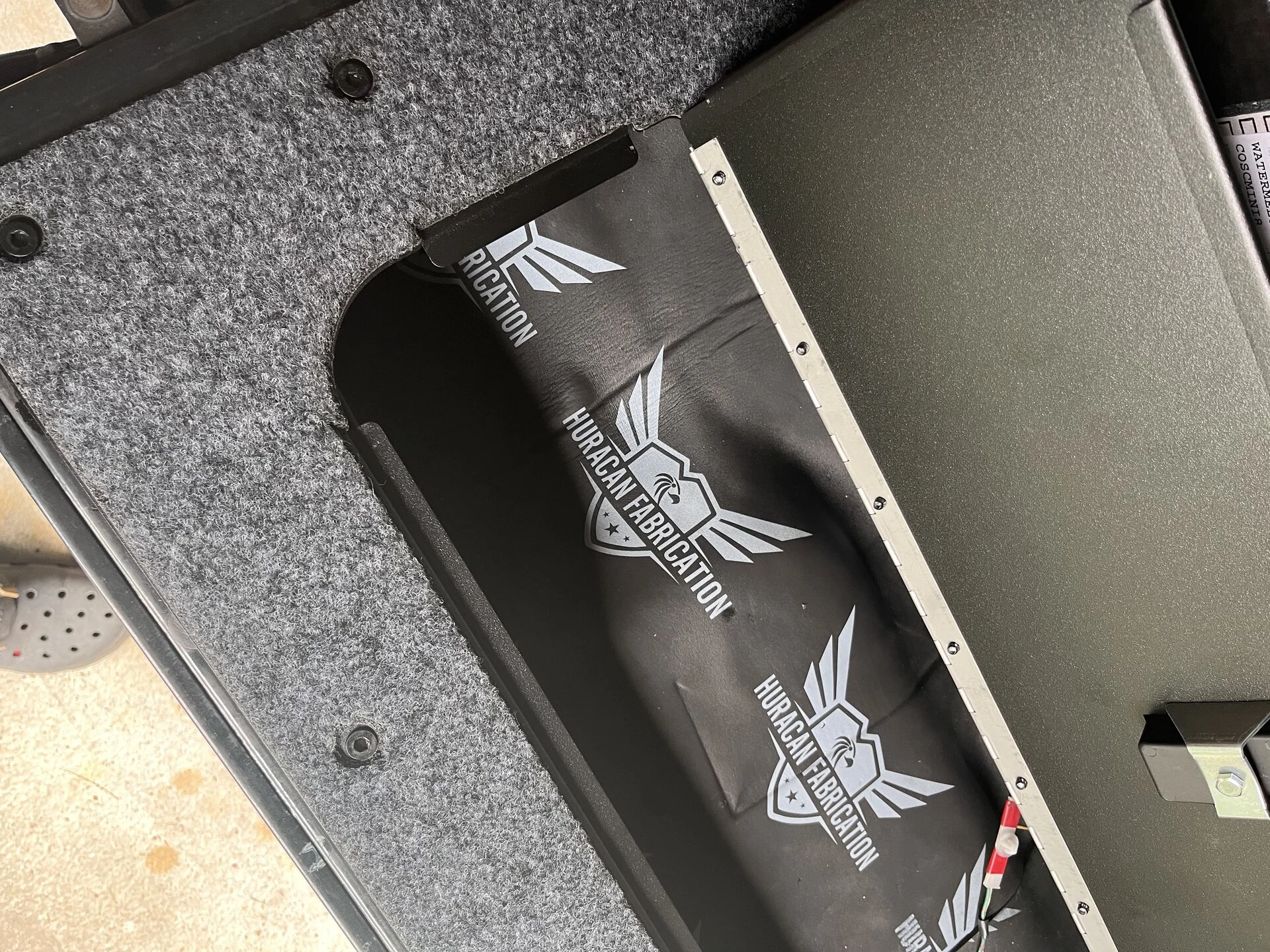

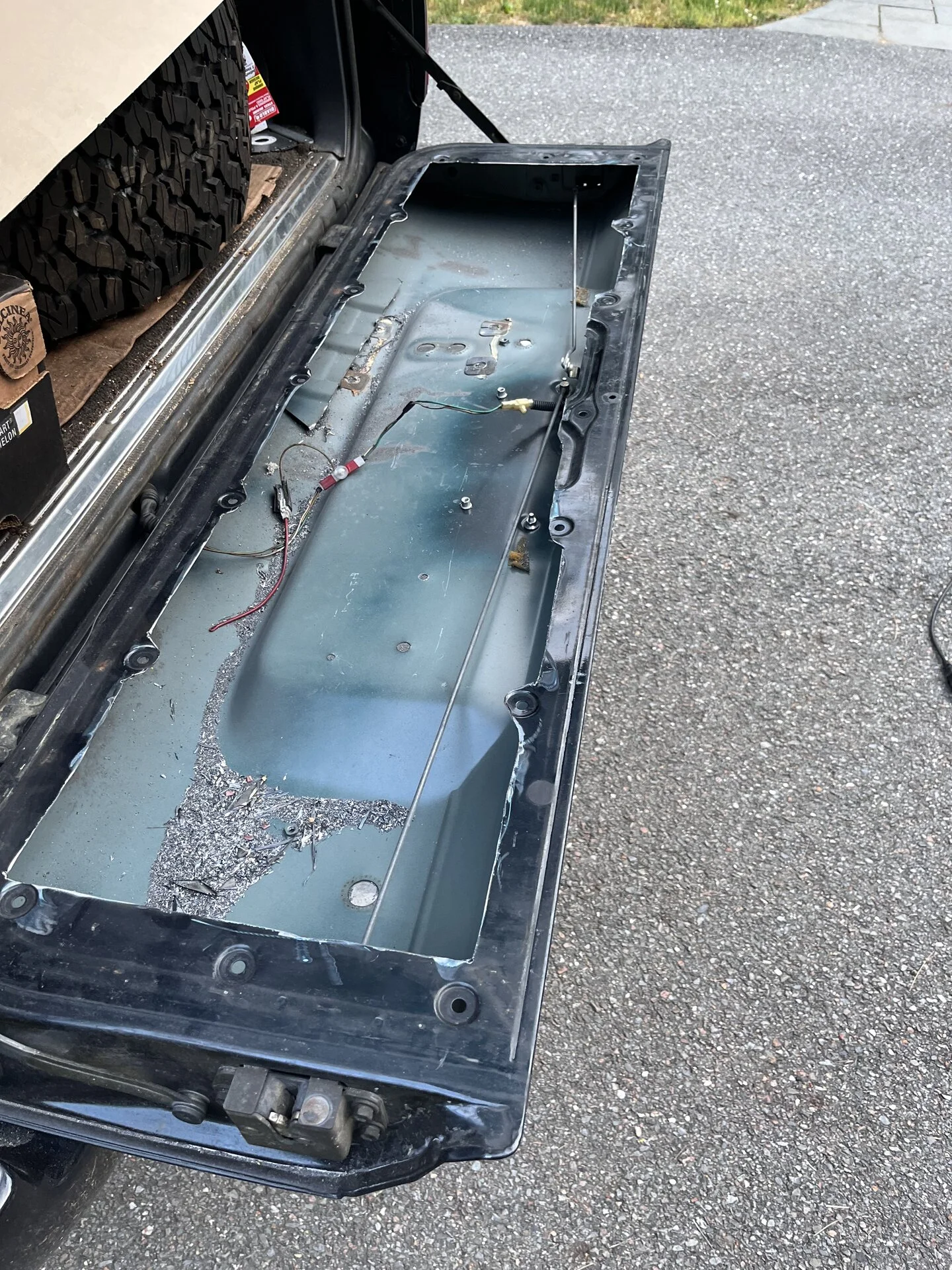

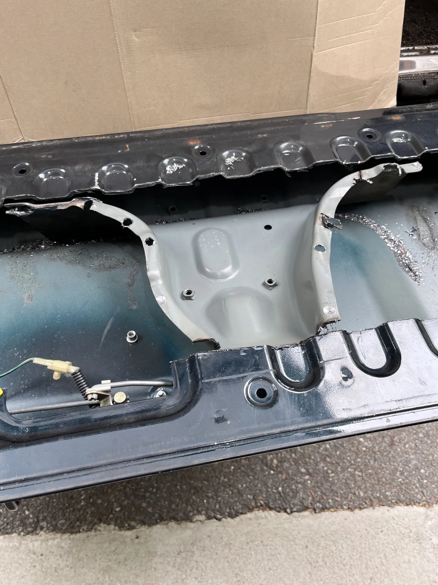

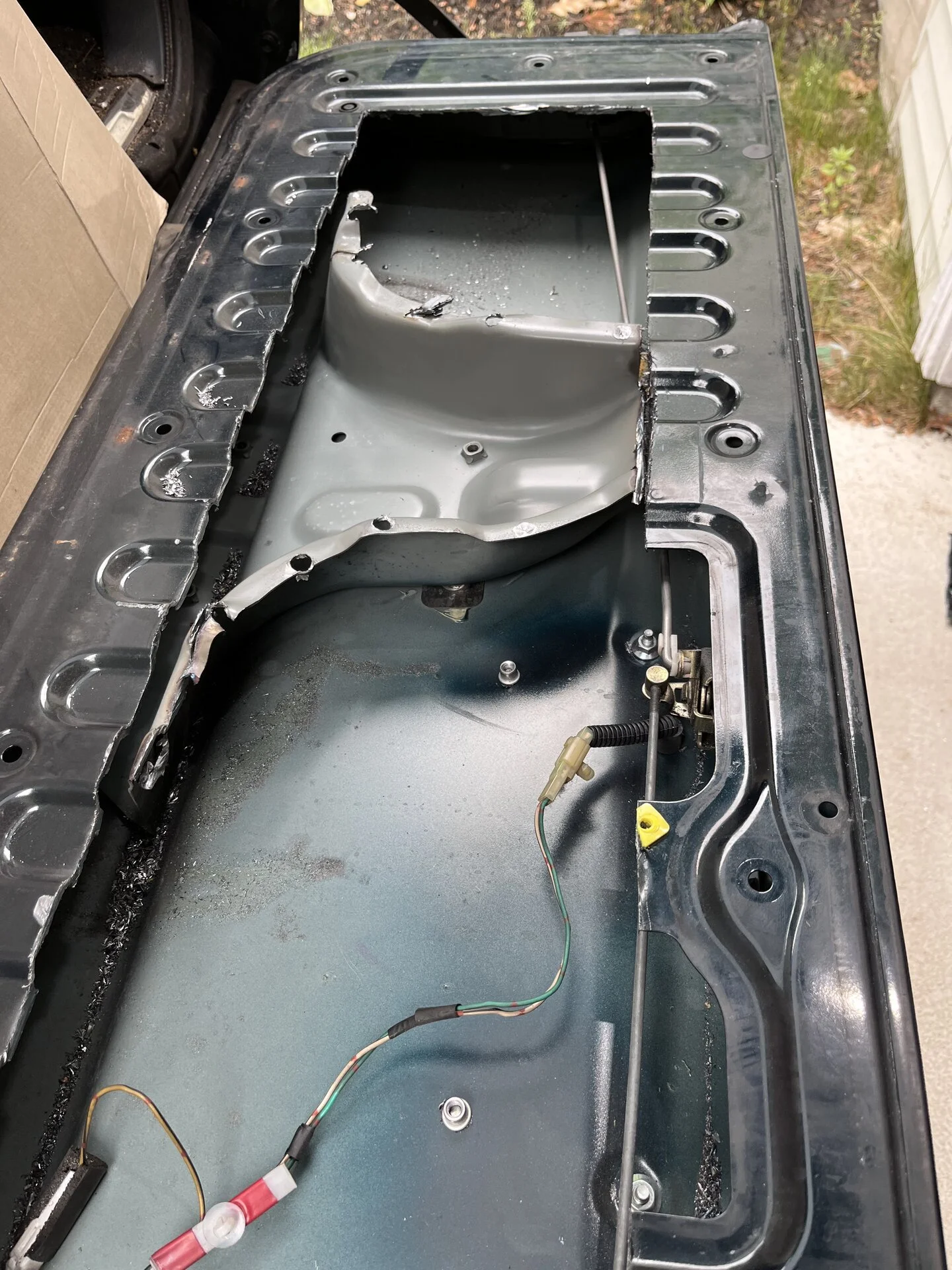

Installed the 80 tailgate storage mod
being a HDJ81, the previous owner removed the spare tire carrier and you can see the reinforcement piece inside the tailgate which I had to also cut off and remove.
