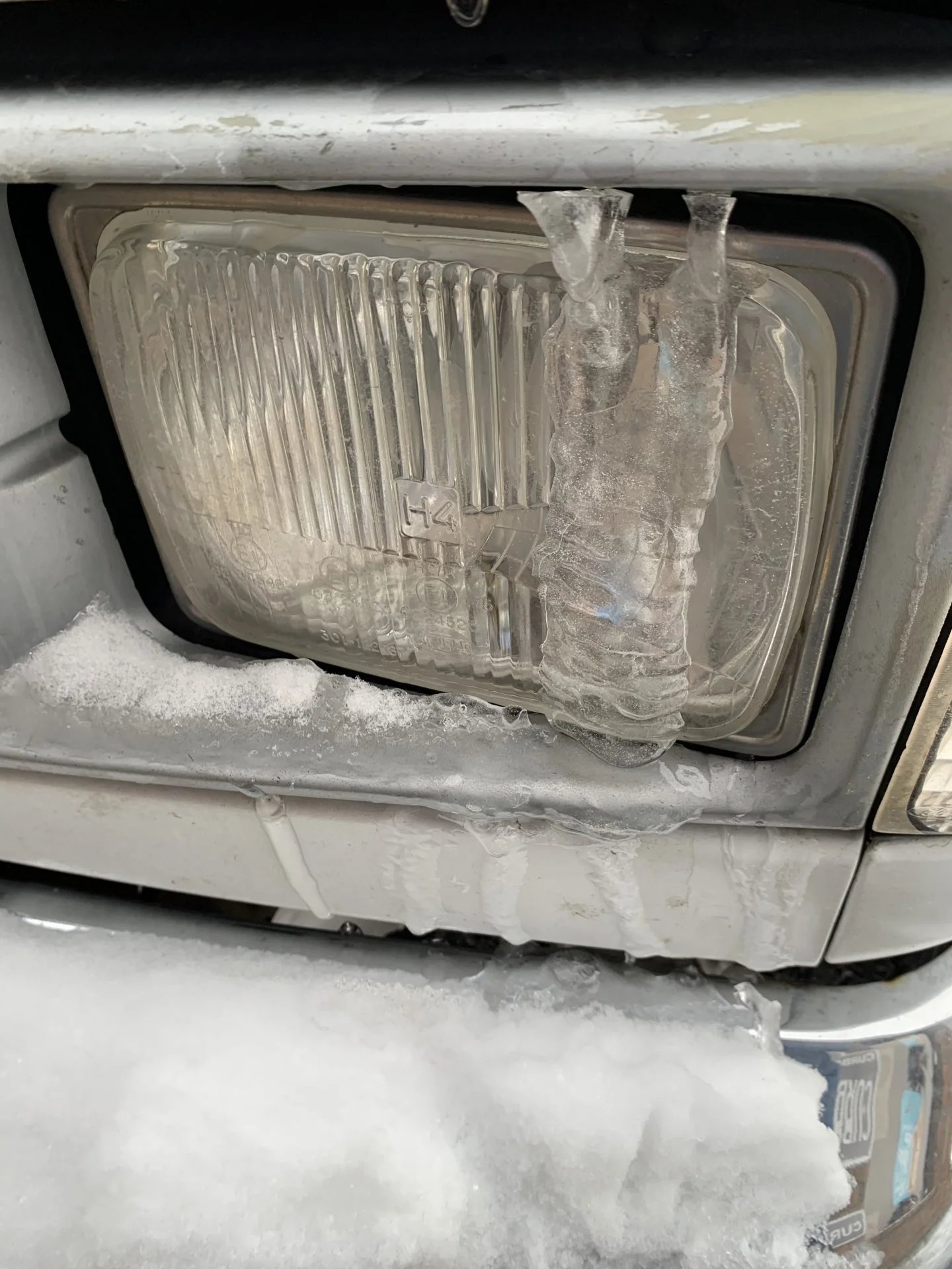

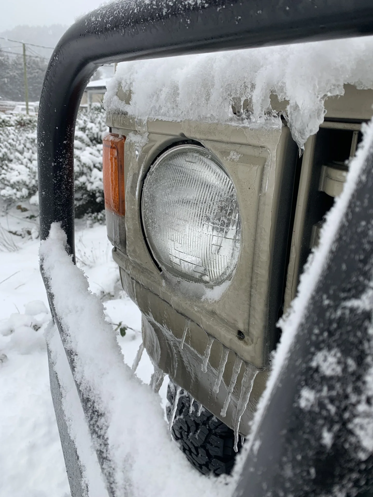

My H4 Headlight and wiring harness kit has arrived and looks great! I like how it’s double relayed and fused so if your having a problem your less likely to lose both lights.
Seeing as the company won’t buy winter tires I phoned in snow today to stay home unbury my 60 and install some retina burners and snow melters.

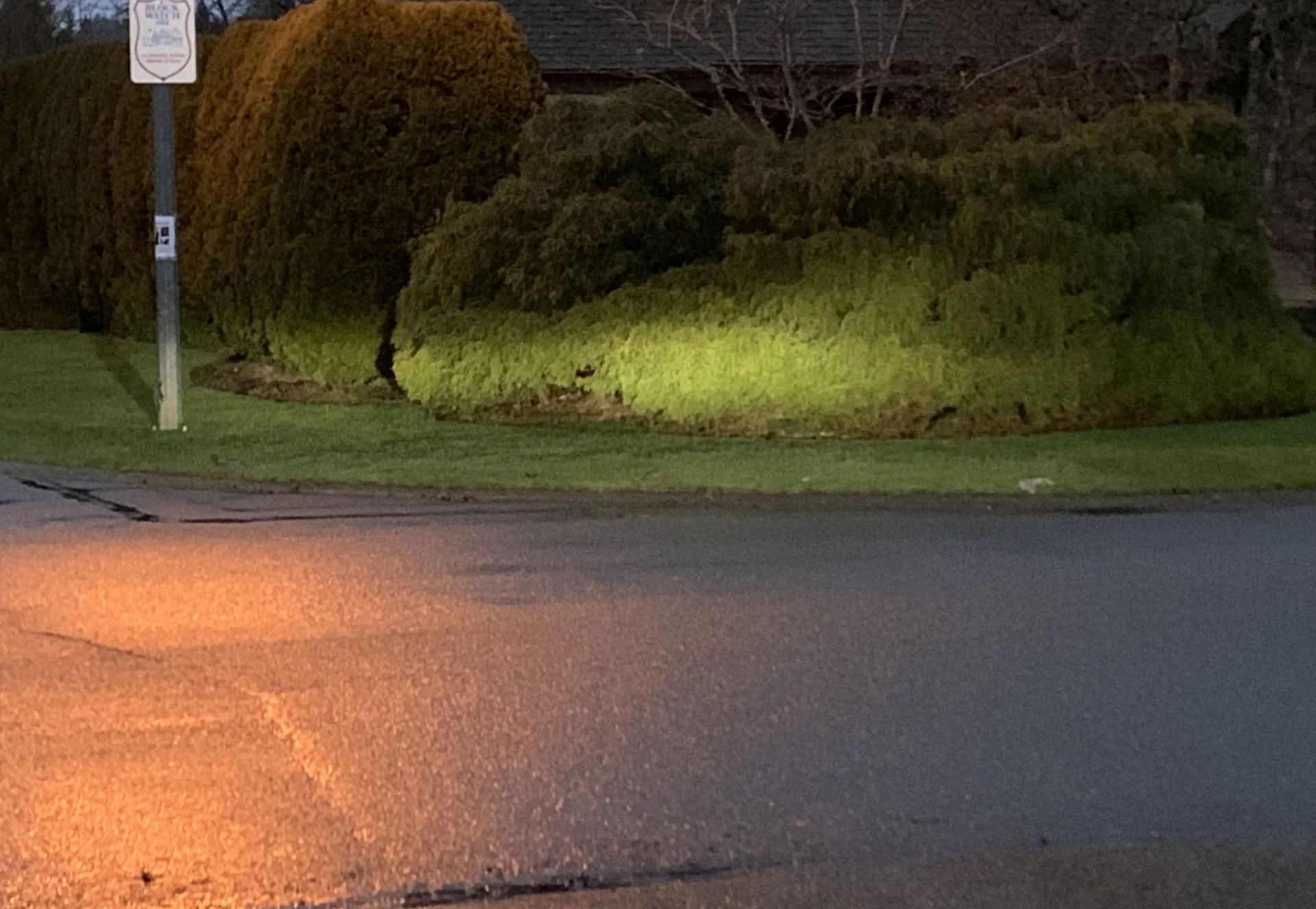

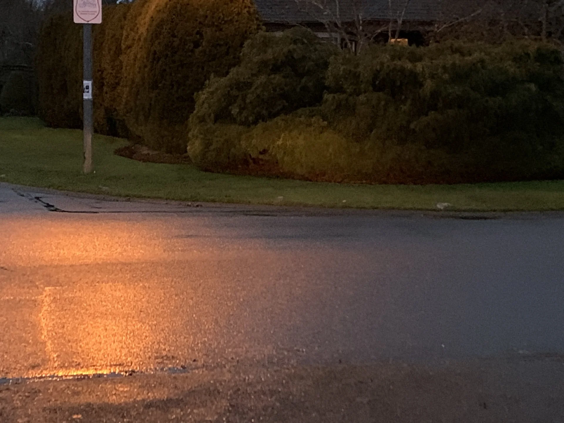

Before with Hella halogen bulbs in E Hella house;
7am.
After with XULED:
Still 7am on the same day. Can you see a difference? The light is on in the first pic btw.

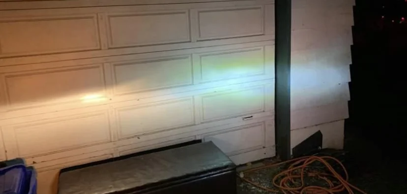

Halogen vs cheaper LEDs:
No focus, and effectively dimmer.

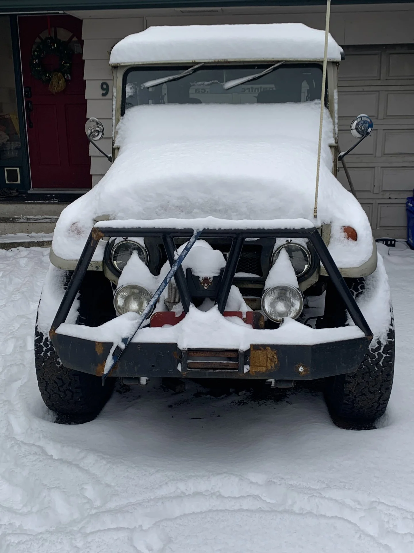

Can you get a light pod/mount to mount a standard headlight to a bumper?
Might be a good use for my old h4s when I install my kit.
Or hell for that price buy a second kit.
