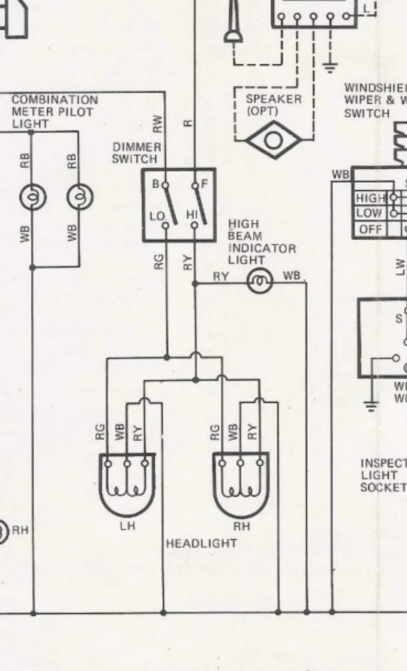

4x series are not wired like a 6x series. It’s wired simply and as most would wire a system. This seems to be a 60 issue as they are wired in reverse with the switch grounding the lights causing the high beam indicator issue with the new harness.
