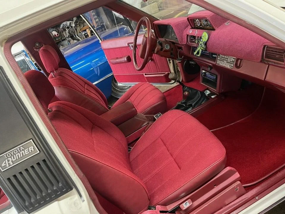

Building this one for my Parents who live on St. Augustine beach. You can drive on the beach there, and my parents keep getting stuck in their weak AWD Honda. I want to give then a fun 4x4 that works great and looks great with that top off. Porn star red perfect interior with a slamming sounds system sold me on this 2 owner rig.
