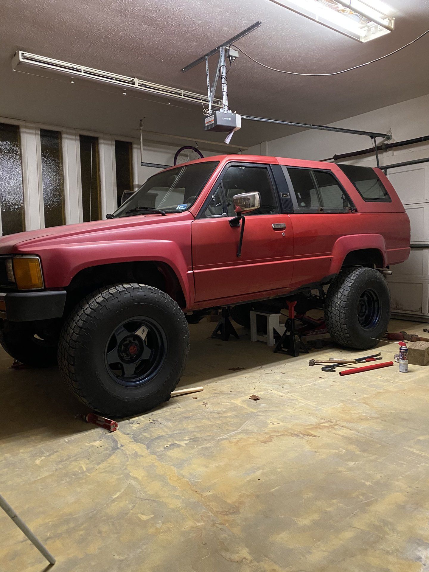

Welp, I’ll agree with ntsqd. Removed the short OL spring and mounted the springs and set weight on the axle. Right out of the box they lifted the rear about 4.5”. I went from 3” between tire and fender to 7.5”. I have the hardtop, no spare tire, and the back is empty. All I’ve done is set the weight on the springs, but I can tell this is too tall. I’m going to remove the shortest non OL spring and see what happens. I feel like a may need to replace it with a leaf from the OEM leaf pack to maintain spring rate - maybe not though.
Pictures just cuz.
Before
After
I would bolt it down, put your spare in it and whatever else you would likely carry and drive around for a few months to see where they settle. maybe it's just the angle of the after pic, but it doesn't look that bad.
It’s the picture. I was shooting for 5” between tire and fender which would give a slight forward take. The gap in the picture is 7.5” which is too raked for me.

I pulled the bottom 3 leaves out of the CS009r packs and replaced them with the long overload from the factory pack. This dropped me about 1.5” and relaxed the shackle angle a little. I’m going to bolt it back together and run it around town this way for a week or so and see how it feels. I’ve got new bushings, a ubolt flip kit, and lower shock mounts to go on but I don’t want to install the new ubolts until I have it right.
Here’s some pictures with the leaves removed/swapped.
Looking good man! What size tires are those? It's got a good stance.
Here it is all bolted together. Tires are 295s on 16” wheels. Not the sure the width or backspacing but they stick out a bit. I think the front is stock height IFs. That’s the bottom 3 OME leaves pulled and replaced with the factory overload leaf.
It’s sitting pretty level in the last pics. How is the ride? Are those 33 x 12.50s you’re running?

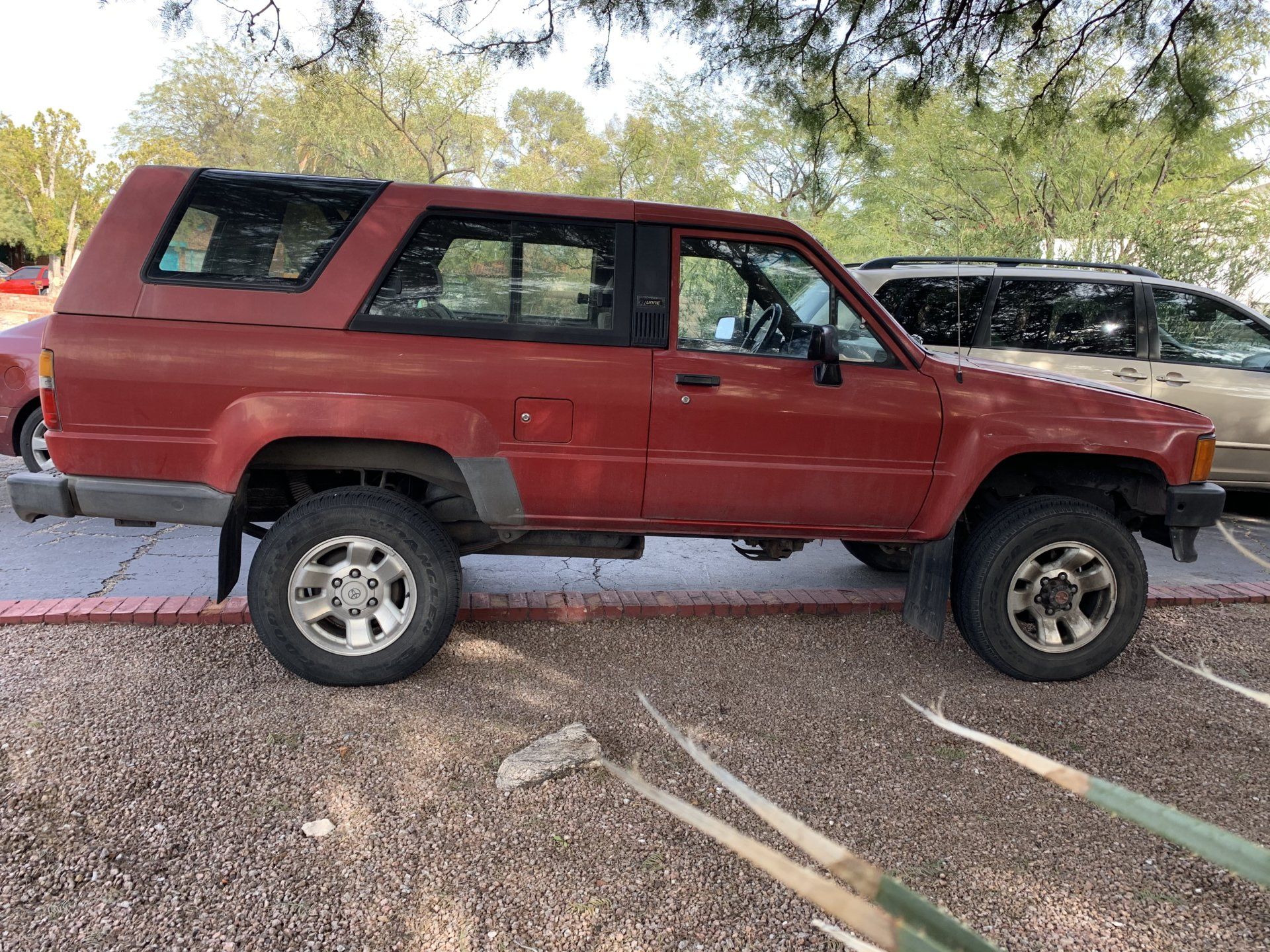

Went on an impromptu wheeling trip and the first ever for me in this 4Runner. First impression - the lack of “flex” on these IFS trucks is seriously hilarious. A locker is almost a must if you don’t want to bump/floor even the most minor obstacle. That said, careful line choice and driving can make up for much of the suspensions shortcomings. Here’s how it sits after about 15 miles of fire road and some very mild wheeling. It has about 150-200lbs in the back. The shackle angle looks great.
