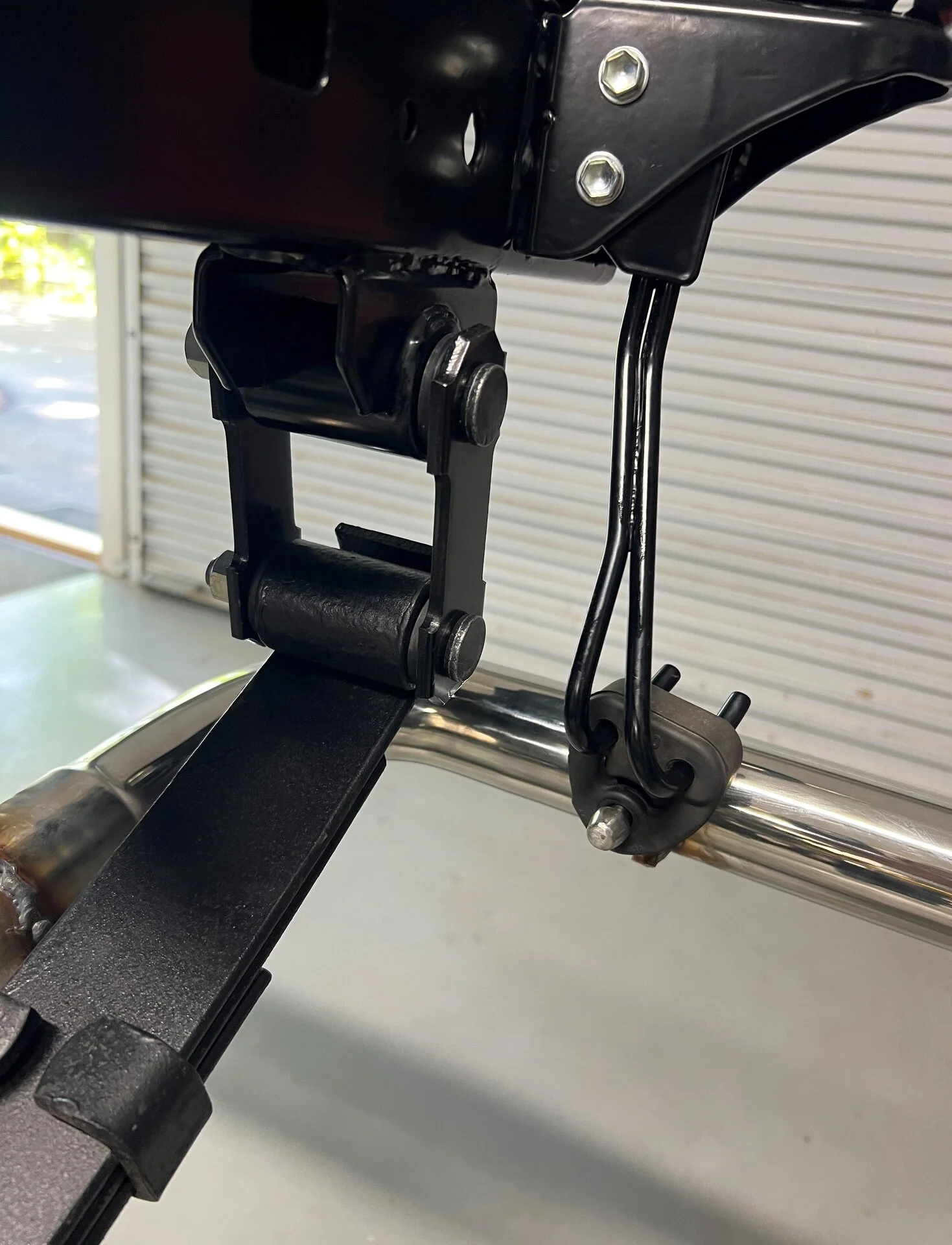

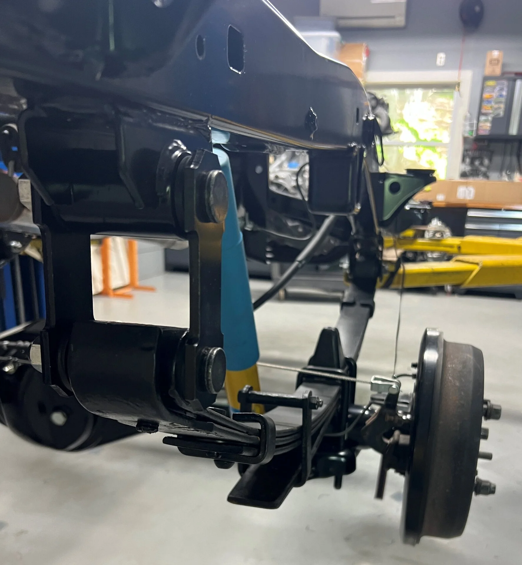

I went with LCE springs, the rest was OEM. Toyota still carries all shackles, bushings and hardware. LCE springs came with bushings installed so I have pair of those if you're interested. Pics and parts list below. Sadly I don't have a driving experience yet, but getting close.
S.
DescriptionPart NumberQtyCost (each)
Spring Shackle Kit4483-350402$71.52
Shackle Bolt90105-140252$6.28
Bushin90389-140042$37.87
Washer, Plate90201-140254$2.51
Washer, Sprint94512-014002$0.99
Nut94115-514002$2.99
LCE Spring Set40300321495.95

By U-bolts I assuming you mean the large pair that mount the spring to the axle. Yes, they came new with the springs from LCE. I was not happy with them, they did not have the correct spread to fit over the spring and engage into the lower plate. I eventually got them on with a lot of effort, then the nuts didn't really want to torque to full spec (80 ft-lbs). I pulled up to 70 or so and called it good, we'll see. Bisteins, yes. I'm not usually a brand snob, but after a few decades I've had only two leak on me, and after many many miles. Both replaced with no argument, at no cost. Oh, and they ride great too.
