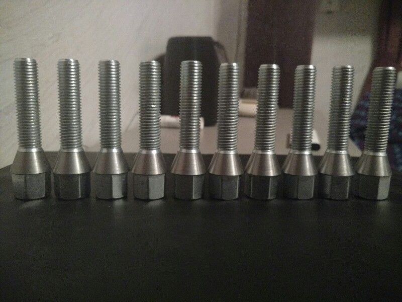

I can't hold back any longer! Time to start the reveal.
Here's the line up of the progression of prototype "studs".
...And here is the first production run.
...Ready to get installed on the Gecko.
Another day or two for the other piece and install can begin. I can't wait to see if this works!

It's a simple solution for sure. I'll admit I still have my doubts but let's see how they work and I'll happily eat crow if needed.
