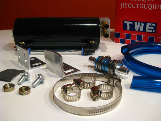

So I've been doing some research within the 'MUD regarding PVC Oil Catch Cans via these threads:

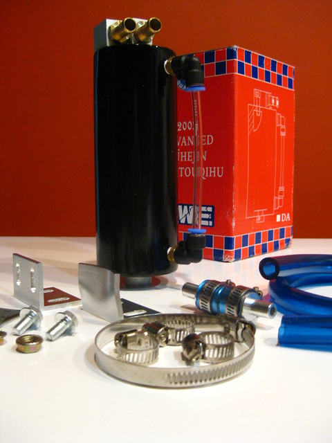

I found mine of "fleabay"
BLACK TURBO OIL CATCH CAN TANK RESERVOIR 750ML JDM ALUMINUM

Now the trick is, for the 3FE engine:
I have a few additional hoses to deal with... Anyone have any input?:meh:
Mount it to the very front of the air box. Its sturdy enough and its close to the intake ports.
Regarding the catch can, do you like the quality of the hardware and the can? the price is right but I need confirmation that its not junk.
Hey Flow, Thanks for checking out thread and the input!
I have only visually inspected the Oil catch can and looks decent, especially for the price. Hopefully I will get time to put it in this weekend and will have a better perspective on its workmanship.

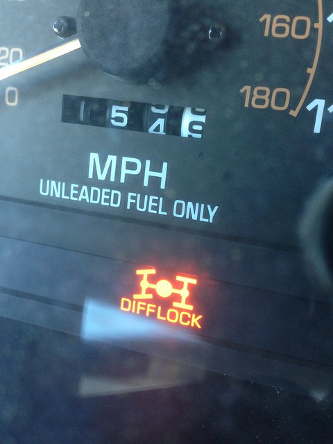

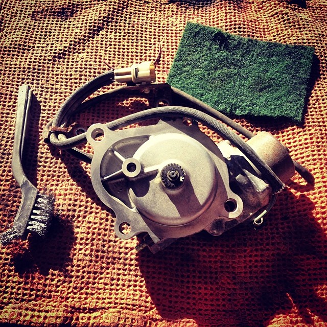

Day before XMASS - CDL center diff lock warning light & busted thumb
So my rig tossed me a nice holiday surprise! A day or two before XMASS my DCL DiffLocker warning light illuminated on the dash in a nice warm orange'ish color while commuting to work. Upon attempting to entry my works driveway, the steering was very tight and the radius was very short. I had to back up and try it again to get the rig to turn in without too much force on the traction heavy tarmac.
This issue came about once before while on a business trip back in June as stated back in thread post #296
During lunch I did the same as last time and disconnected the transmission computer located in the driver side kick panel. Jumped in and backed up and forward and repeated the process to see if I could get the CDL to disengage. But this time, no avail. So, with time pressing I took the front driveshaft out, but during the process I added some particle coloring to my thumb. I disconnected the front portion first and while disconnecting the rear portion, breaking it loose also meant some extra forward momentum. As the rear portion came off the front portion that I was already holding came down and my thumb was perfectly aligned between the propshaft and front sway bar. BAM and thank you! Thats going to leave a mark...
But that is not going to stop my daughter and I from having fun! The ADV80 is rendered back to 2WD for the moment and will have to get it back in the shop soon as I will need the rig for service work again for King of the Hammers in February.
Made a plea to find a new or used CDL solenoid in the main 80-forum section:
https://forum.ih8mud.com/80-series-tech/789667-1992-center-diff-solenoid-who-has-i-need.html

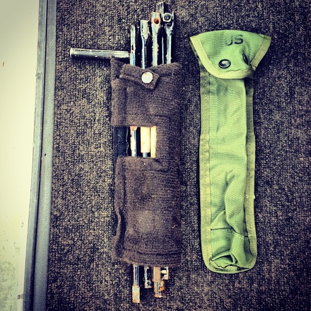

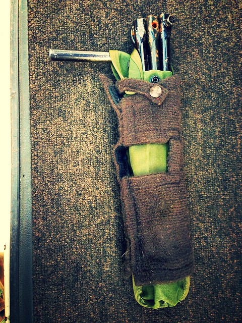

Visited my local Army Navy Surplus store the other day... Does this buggy remind you of any particular movie?
One of the items I picked up was the long green bag on the right. My tools seem to rattle around a bit in the stock sleeve, in the stock location.
I will still keep the stock sleeve but put the tools inside the mil-spec bag first and see if this eleviates any noise.
I will get plenty of noise testing in a couple of weeks while working at King of the Hammers.

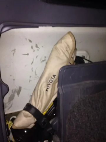

I hate to tell you that carpeted piece is not the stock sleeve for holding the tools. That piece covers the brackets that hold the third row seats. The attached picture shows the SOR version of the tool kit pouch, the OEM being tan in color.

I got this 1992 CDL Solenoid and a couple of other parts from 'mud-member superstan26 as he is parting out a '92 80-Series in this thread: https://forum.ih8mud.com/parting-out/777476-parting-kansas-city-ks-area-complete-92-fj80-white-ext-grey-int.html. I got it to replace my finicky SDL-S. I will get the front drive shaft back in and get the Transmission computer hooked back up. I will get the speedo-sensor gasket replaced at the transmission as its currently leaking past my homemade exterior gasket sealant attempt. It worked for a little while... then a general PM service check up.

The "tire tool wrap" just never seemed right and I have never seen a factory tool bag and where the factory tools are suppose to be! I guess I have not cared enough to look into it and or asked the members here... Never really been that big of an issue other than I would just like to get them quiet.
But while we are on the subject, can you show me where the factory tools are suppose to be?
Thank you again for sharing your insight!
THANK YOU PPC for commenting!
I have to admit you are creative and resourceful !!!
The tool kit gets stored with the jack with the rubber strap snugging both down so nothing rattles. I don't have a picture of that and its to cold to go out to the garage tonight and snap a picture.
Hey PPC, based on what you are saying, my tools are in the right spot. Thanks for confirming!
I have learned a lot from your thread so I am glad I can contribute. Here is a pic of the factory location and bag. I can't swear that it is hung in there correctly but you get the general idea. This is my 1992 TLC.

THANK YOU for the kind words Copenhagen1 and thank you for snapping a shot of your tire tool location. That is what I thought and how my tools where placed when I bought the rig, minus the tool bag as you have. I just though it was interesting to have the strap on the lower part of the tool with the majority of the weight up at the top. But who are we to question Toyota engineers.

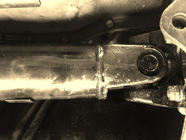

Best thread Ive followed on MUD by far.....loving it as I have a recently purchased '91.
Question, replacing the front and rear ujoints resolved your drivetrain clunk?? I too have the clunk.

I would have to say yes. My rig had a ton of miles on the factory u-joints when I replaced them so I know that was the single largest contribution to driveline slop or clunk. And it got a lot smoother replacing them as well! Click the pink text below and they will take you directly to the Yotamasters webpage for each of the U-Joints you will want to get.
Front U-Joints:
Trail Gear / Matsuba U-Joints:
These stock OEM Replacement U-Joints have been tested to 3700 ft-lbs of torque before failure. These U-Joint fit most 1979-1995 4wd applications. Does not fit CV assemblies. Includes four install clips and Zerk grease fitting (not shown in photo). Made in Japan.
Rear U-Joints
Toyota OEM U-joint 100048
Due to the massive and or odd size of the rear U-Joint OE is the ONLY way to go!!!

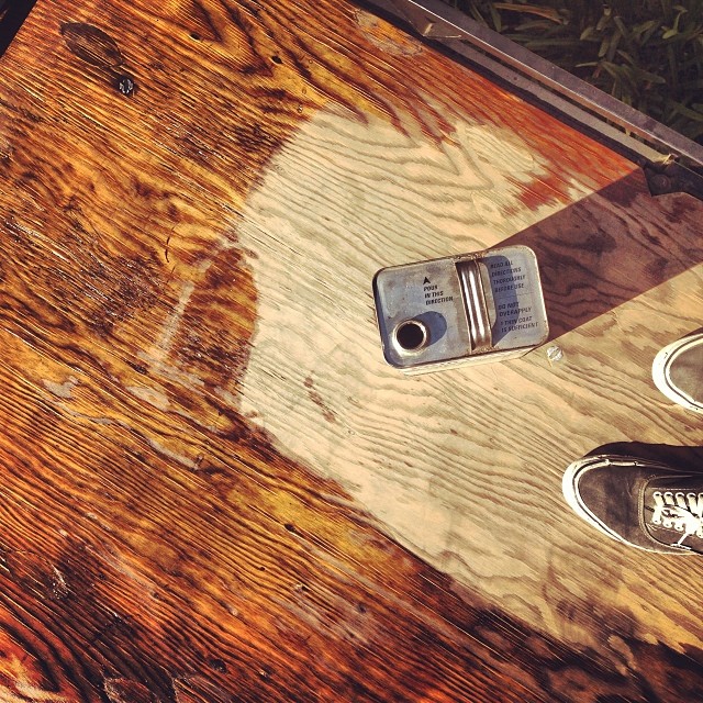

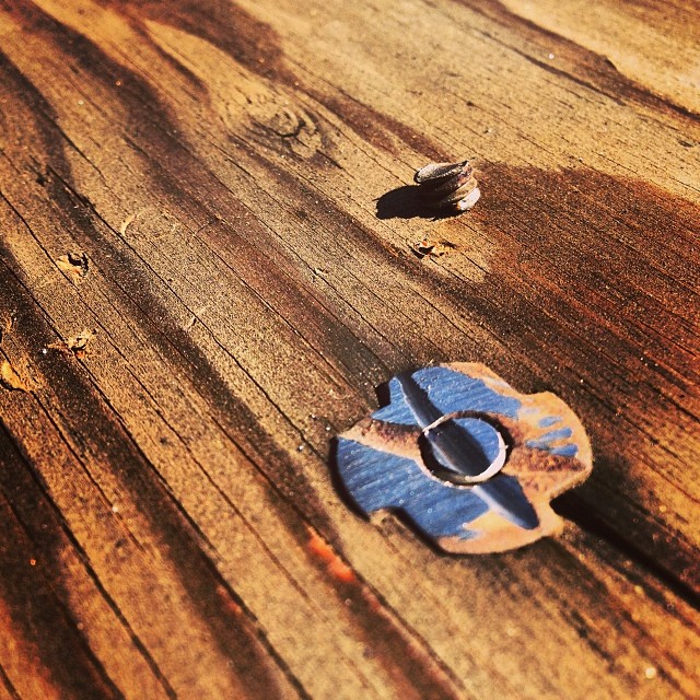

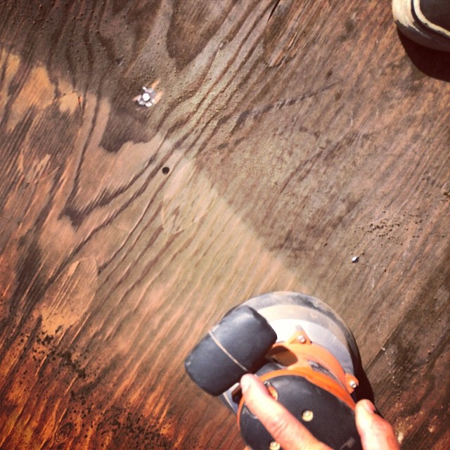

It is time to work on the deck around the house this weekend. Wife said our prepper home off the grid observation deck was of no use if she was going to stub her toe on these bolts sticking through the floor.

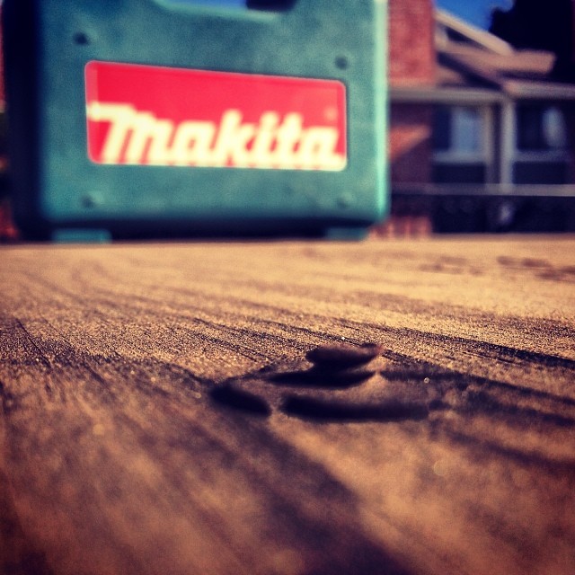

So its time to buzz off the bolts that I was suppose to do last year...
BUZZZINGED!!!
While I'm at it...
A quick sandy wipe with the orbital sander to knock off a years worth of crust. At lease I did put a coat of Thopson's Water Seal on the observation deck when I previously built it.

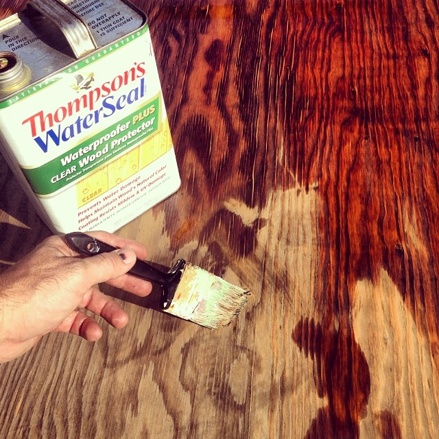

Now for the annual application of Thopson's Water Seal. Got to keep it nice for the visitors that will be making use of its awesome views.
Doing deck work in my OG-work Vans sneakers. I've been wearing Van's since my first pair in 1977! AHOY-SAILOR!!!

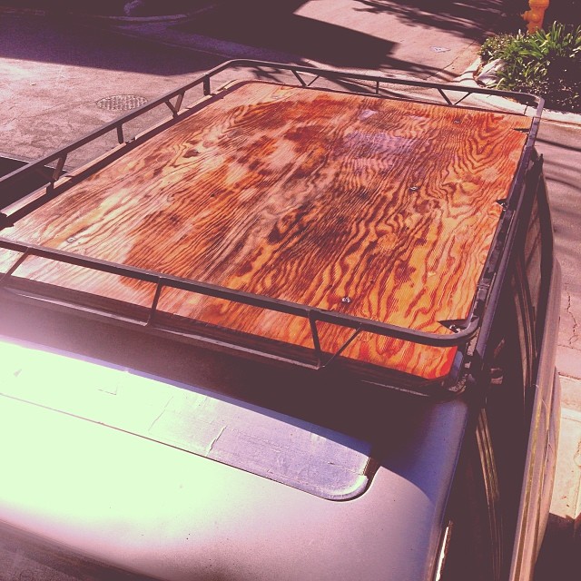

The observation deck / roof rack on the ADV80 has now had its annual KOH / King of the Hammer preparation for Heavy Media Media remote field-ops service. The DAILY PURPOSE for this piece of plywood on the roof rack is for a radiant barrier between my rigs roof and the SUN!!!
I learned about using wood on the roof rack from Africa4X4 Cafe with this seriously cool Toyota 4Runner and link it in my original roof rack post:
