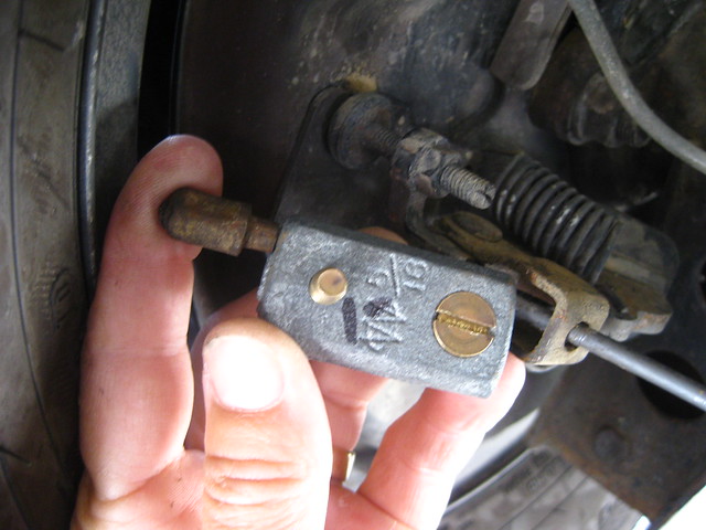

E-brake cable too long...

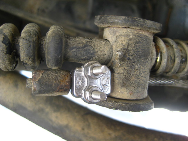

I have no idea why my E-brake cable is so extra long? After doing the FF rear axle swap [post #227], seems the cable I got is for a longer wheelbase 80?
Regardless I needed to take up some slack. Near my home here in Costa Mesa, next to Newport Beach, located on Newport Blvd is a boat salvage place that has all kinds of cool stuff. I find a lot of stainless bolts and stuff there. So I went digging and found this block that will hold the slack until I figure this whole mess out.
PS: this is with the cable tightened all the way at the E-brake handle too!
Added this little item too.
I tested the E-brake and it does activate, just all the way at the end of the E-Brake handle as it is standing almost straight up and at the end of the handles sweep cycle.

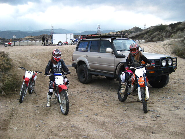

Dirt biking with my daughters at Wildomar OHV Park as that is the closest place to dirt from my house. It's good prep for desert riding and the season is upon us!
Its been all play and NO WORK on the ADV80!!! Sorry it's been a while since I have last posted!
My daughter has been loving the riding and I can not deny her riding especially during her time off from weekends softball and now rugby. We spent Turkey Day weekend in the desert with friends and the ADV80 was just transportation to and from the desert to go riding.
Another day for the ADV80 getting used and abused with now play...
You see three dirt bikes here... My daughter's friend rides too and her dad was not able to make it out and we all wanted to ride bad!

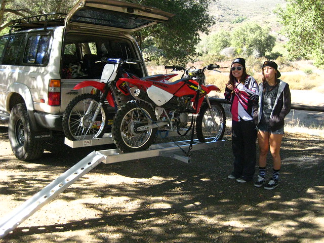

So how do you load three bikes up in the ADV80 when the rack only holds two?
Stuff one inside!
Good thing my daughter and I are riding little Honda XR100's! I am having much fun with the little bikes.. and I have an Honda XR400 & ATK 605. No reason to spray my daughter with large rocks and the again, the little bikes are just plain FUN!

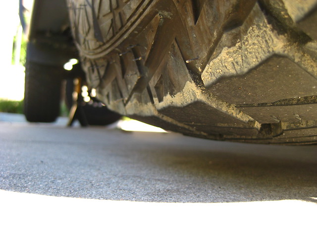

TIRE ROTATION TIME!!! Use that spare in the rotation!
Ok, time to do a little work on the ADV80.
It's tire rotation time!

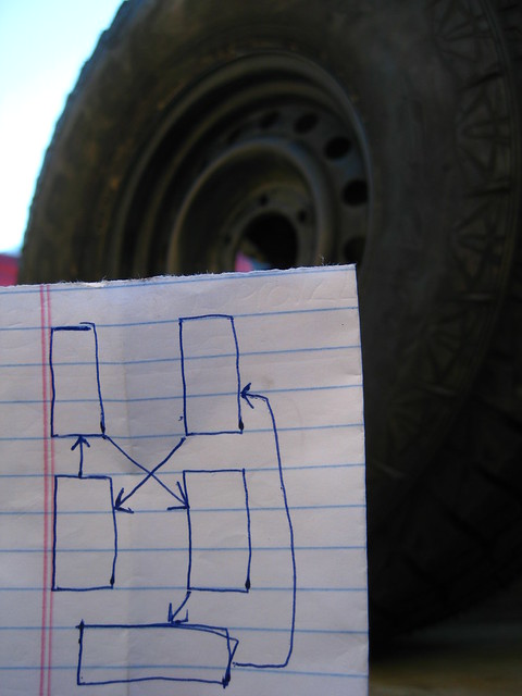

How many of us actually use the fifth tire or spare tire to extend the life of the four tires being used? Tired of having an odd freshy? Or one that is the new, but is now a leftover from the other four, that is if you are switching tread patterns...
My buddy Randall Davis, co-worker at Axial and RD Adventures blogger showed me his five tire rotational pattern to put that spare tire into rotational use and extend the overall miles!!!

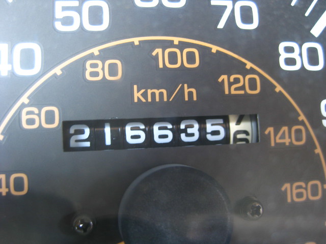

I'm a little behind on doing my rotation as these tires went on at 211,817 miles
on Sept 1, 2012 putting me 1,800 and change over my desired 3,000 mile mark.
I plan on rotating these tires every three thousand miles so with 216,635 miles now on the clock, 219,600 miles next target rotation. Simple math really...
Now for the fun part:

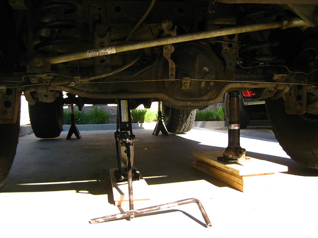

Limited funds means more work with budget tools, like with the factory jacks VS. a nice big shop style floor jack. Dare you say a cheapo Harbor Freight one. I hate to spend money on cheap tools and I will usually go without only to make more work for myself! But rotate we must!
The barrel jack on the right is from my Land Cruiser and the scissor jack is from the wife vehicle. With the 34" Falken Wild Peaks, I needed some wood to get the jacks off the ground enough to lift the tires off enough so I could rotate them. Going to have to add this wood into my daily hauled EDC kit! Could use for emergency fire if it cracks... hehehe

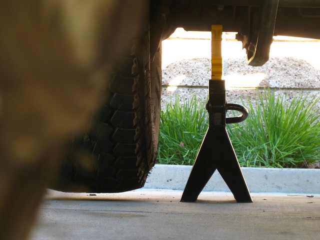

Yes, I give the wood some thought about it cracking... I lifted the front first and use the two heavy duty jack stands as this side of the vehicle is the heaviest.
Friends... My buddy has my two other stands! I need to go get those from him!

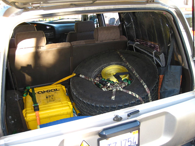

Still running the full size 34" spare in the rear cargo area as it does not fit in the underneath stock location and I have yet sorted my rear bumper / tire hauler.

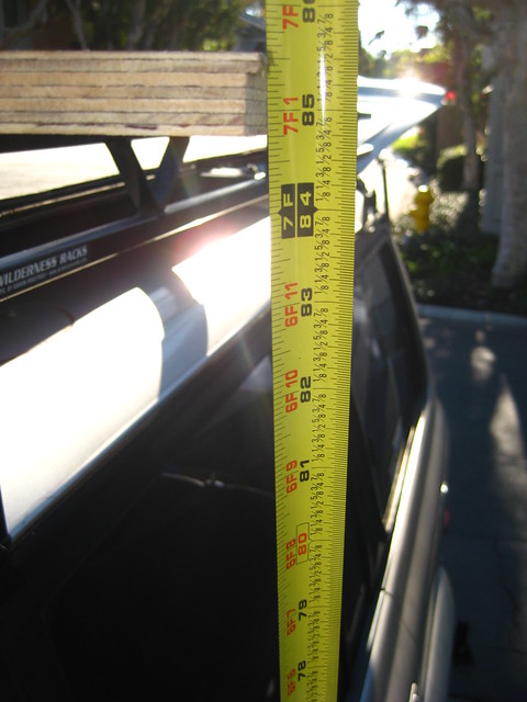

I measure just how tall my rig sits now on the 34" tires with 4" TJM lift springs. Seven foot one inch to the top of the rack.
