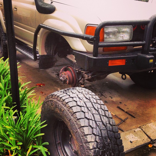

Its that time again to rotate the tires as I am going on a little road trip for the week!
This is my 5-Tire rotation chart for extracting as many miles as possible and taking the best care possible of the Falken Wild Peaks that are currently in service.
I originally had this on a little piece of paper that was floating around in the rig and finally figured I would put it in the top of my tool box so it would be there every time I needed to reference it. Its the simple things in life...
Getting busy doing the 5-tire rotation in the driveway as the rain falls on Southern California. Its drastically overdue rain! But a road trip is a road trip and thrash-prep is in order today, even in the rain!!!!

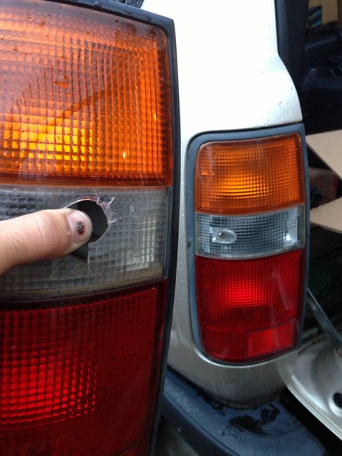

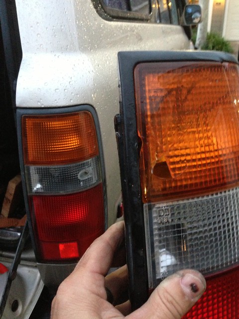

I finally got some new tail lights as this one was broken like this when I bought the truck a few years again...
I may as well..
change the other side too as it recently tool on some small damage... I'm going for clean points! hehehe

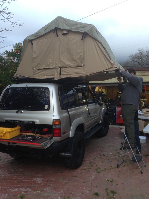

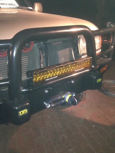

And I finally broke down and pull the trigger... and popped up a RTT as TJM was having a BLOW OUT SALE! I took advantage but the timing was not the best to be spending all this money right now, but you can never plan these things...
Especially when I just pulled triggers on a light and winch!!!! Now these are items that I really wanted!!!
So yea, Friday after work [Noon] was a massive thrash-prep as I would be leaving in the morning for this trip.

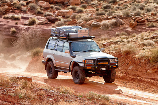

FrontRunner Slimline II ADV80
Im sure some of you will wonder as to the RTT on the roof rack, I changed it all up and with like this:
This is the FrontRunner Slimeline II Roof Rack system. Yes, it's Gucci - yes its worth it - yes its awesome and yes, I will come back and show you more in detail, but for this week my thread is going to go trip orientated and a I will come back and give your all the specs and tech and full thoughts on the rack as this is my new centerpiece of equipment. In the mean time you can trot over to FrontRunners page and check it out at the bottom of the page - look for the L/CRUISER 80 SLIMLINE 2138MM X 1345MM: http://www.frontrunner.co.za/roof-racks/slimline-roof-rack-kits.html

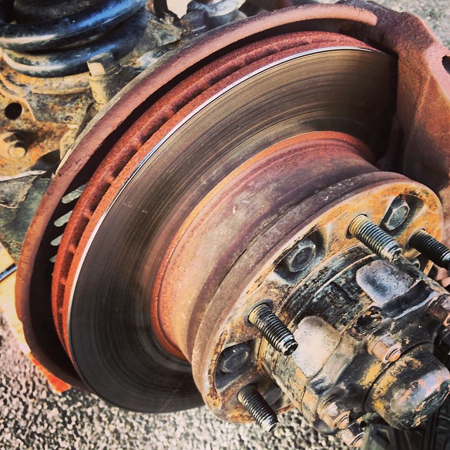

Brake check in Vegas as I heard some weird mystery noises I've never heard from the ADV80. Check for wheel bearing movement and all that. I think its brake pads so I picked up a set and will possibly change once we get there. errrrrrr.....

As for your grinding, is it doing it all the time or just when you brake? I had a similar problem when breaking and found that the lower caliper bolt had come out on the right front wheel!
Hey CTRJ,
It only does it randomly... Only did it twice today...

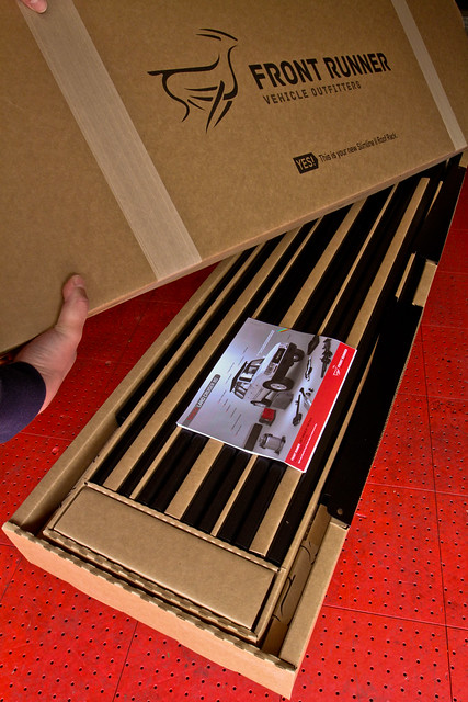

Just from the point of delivery, the Front Runner packaging is clean and elegant looking from the outside. Could this elude to the interior contents?
I get the Front Runner box into my garage to start the contents inspection process. My 5.11 Tactical Alpha Scout Folder does the job of carefully cutting the heavy duty paper-banding strips.
From the moment you open the Front Runner box you immediately notice how organized and well protected the contents are. This is a true sign the company cares about its products!

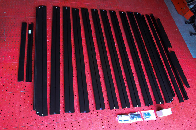

I like to get everything out of the individual boxes and start laying things out to see what I will be working with. You can see the individual bags as EVERYTHING is ORGANIZED!

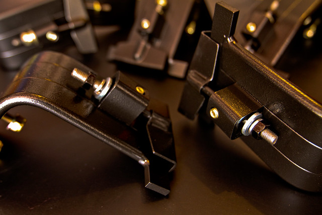

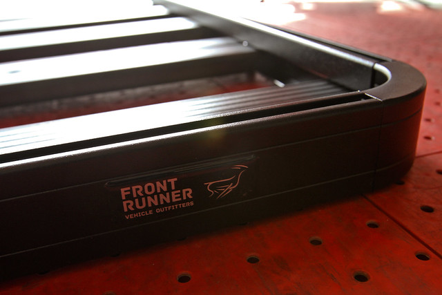

Quality workmanship exudes from the Front Runner side clamps.

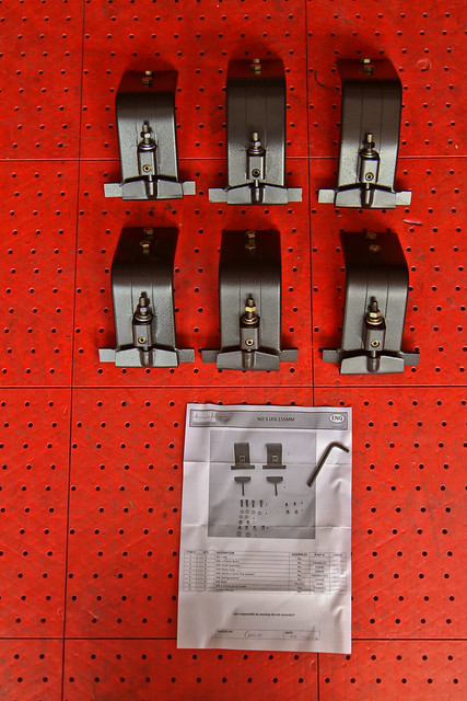

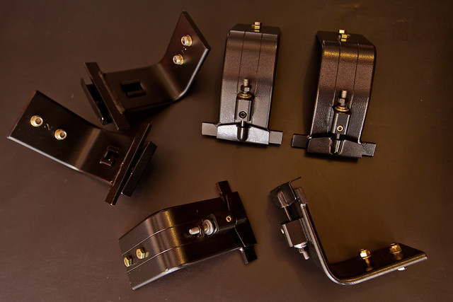

Lay out and organize the roof mount claps. There are two sizes for the 80-Series. The longer ones go on the front of the rack as the front cab slopes down toward the windscreen.

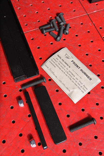

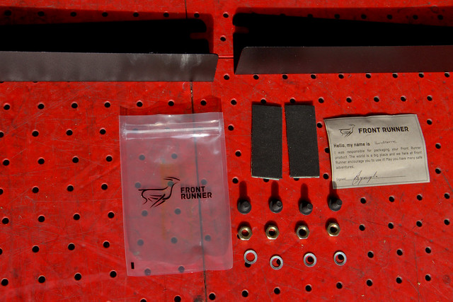

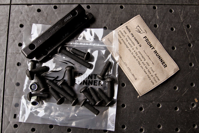

All of the Front Runner hardware is individually bagged. This is the hardware for the side rails, note the extension slugs.

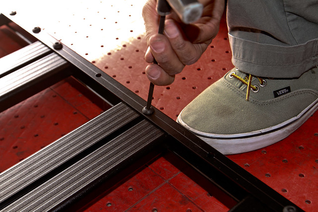

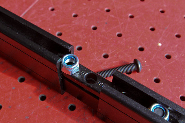

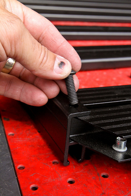

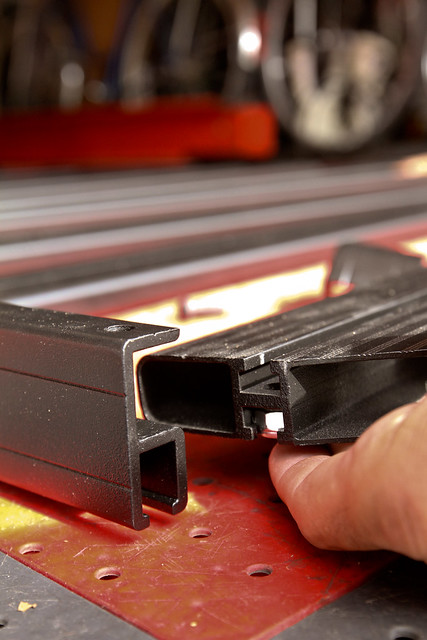

This may give you a better idea of what the slugs are for as we will be connecting two channel sections for the full length of the Front Runner roof rack.

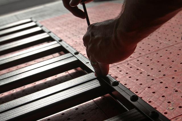

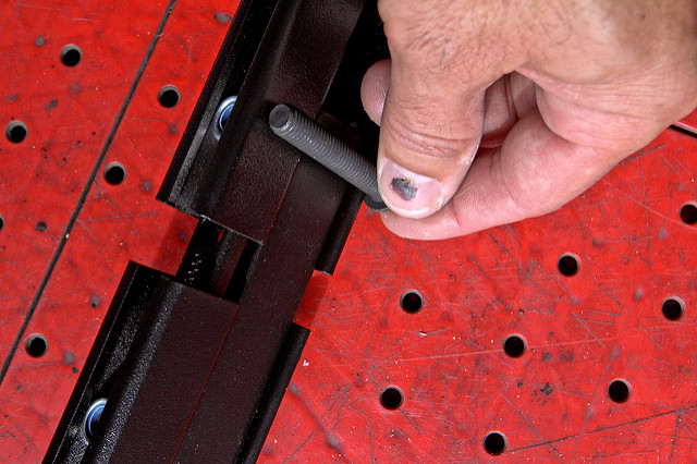

Once we have the two sides put together, we side in the cross beams. Everything about this rack is modular and bolts together but all of the nuts are nylocks to relive that worry. All of these bolts are actually on the underside of the rack. Now we are ready for the end plates.
The end plate corner intersections can be a little tricky when sorting orientation upside-down - right side up, but with patience and referencing the instructions its rather easy. This is from the bottom of the rack. Familiarity and patience comes ease. Its one of those deals that you just do not want to be in a rush! Don't try to install this rack 30-minutes before you leave on a trip. Enjoy the craftsmanship!
Now you can flip your roof rack over right side up.

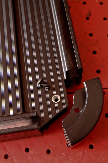

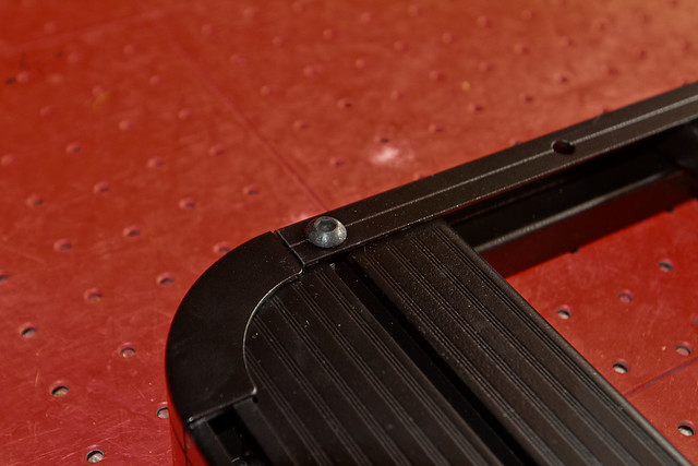

These are the corner caps and it is important to note that you will be taking these off when you add Front Runner accessories to you Slimline II roof rack. I did bore the hole out a little bit as it was very snug and if I will be removing these later, I didn't want too much stress on the bolt. A side note here as you can see more of the racks rails, you will note the deep channels in the aluminum rails, these channels hold the locking nylock nuts. Also notice the cross beams also have a slot in them. Because of the unique T-slot mounting system, “basket style” side rails are not necessary for securing gear. I will come back and show you more on that later.
Front Runner Slimline II Roof Rack Installation
Corner piece installed.

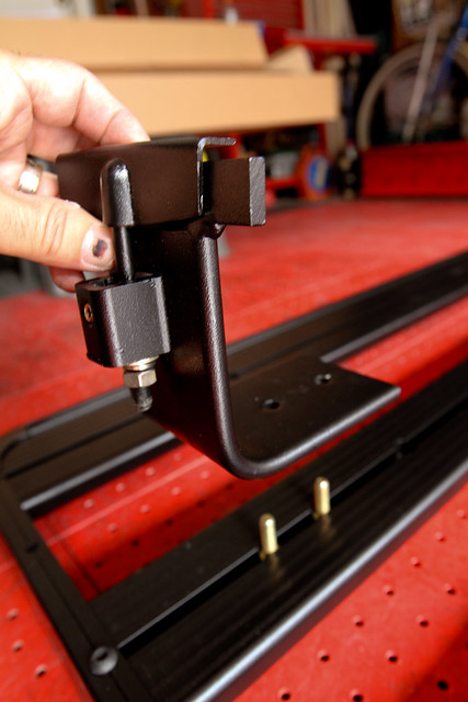

With the corner pieces installed I flip the rack back over - under side up so we can install the legs. You can see the sturdiness of the rack with its load support slats and double walled aluminum extrusion channel side profiles. This patented design creates a joint support that is stronger than usual for a roof racks and the L-shaped rear and front slat design increases the strength of the entire rack, making the Slimline II the lightest and the strongest roof rack available.
Part of what makes this rack so cool is the slots in which the bolts slide into and are infinitely adjustable.

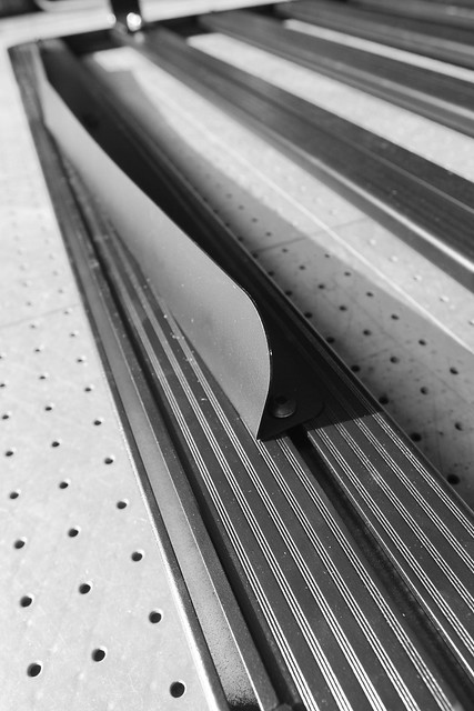

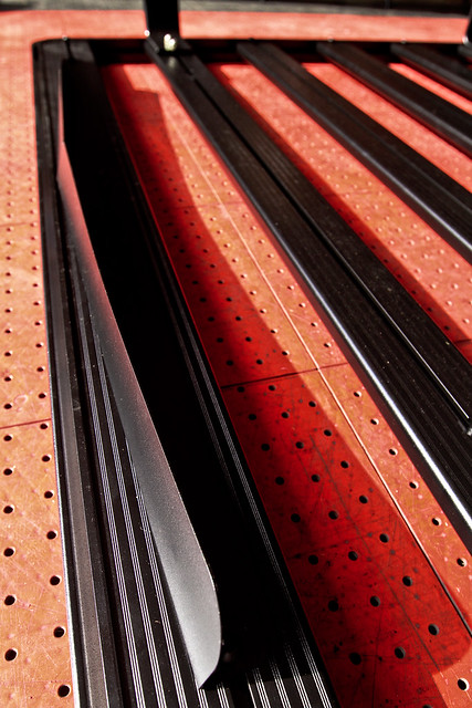

The final bit of installation is the wind deflector, again tidy packaging.

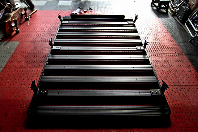

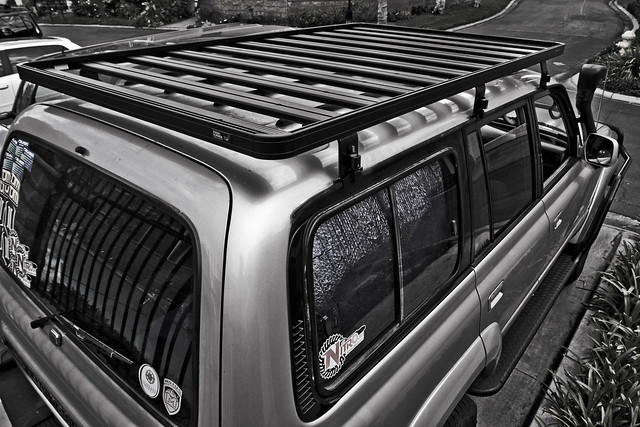

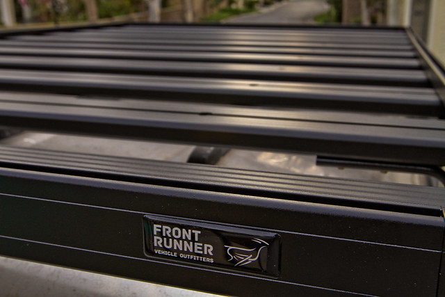

Now the rack is complete and ready to install. Unlike most roof racks, the Slimline II was designed and built specifically for off-road use. Manufactured with high density aluminum and rated to carry up to 660 lbs. Yet the aluminum design is on average 30% lighter than steel making the best strength to weight ratio of any roof rack at 1/3rd less the weight of a traditional steal roof rack.

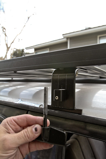

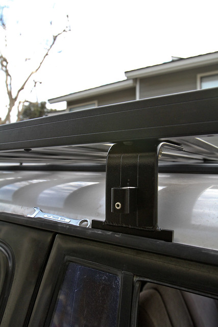

I get the rack onto the roof and start getting everything fine tuned minus the clamp bolts as it is easier to set the main portion of the clamp onto the pinch mold with out them.
Another cool feature of these clamps are the small set screws that are limiting bolts to keep the clamp bolts from slipping over the edge of the pinch mold, but with them backed all the way out, it is also easy to get them into the clamps when they are are ready sitting on the roof. For those who has messed with roof rack pinch mold style clamps knows this is a bit tricky when you are trying to install them, so you will appreciate these more than someone who has not fiddled with roof clamps.

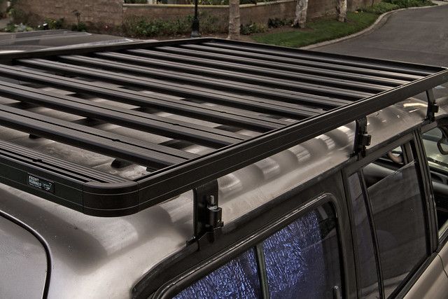

Now we have the Front Runner Slimline II roof rack fully installed and ready to add accessories!
Its almost a shame to add anything as it is so clean, simple and even elegant looking.

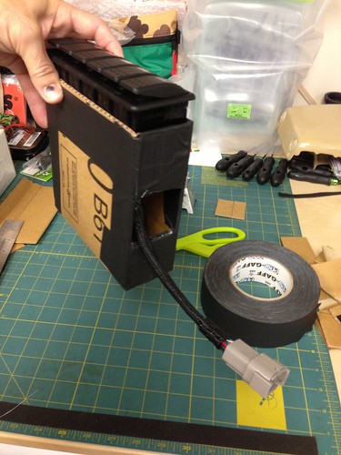

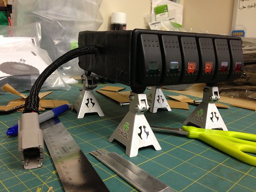

How to make my sPod oh-so-functional! Hook the switches up!

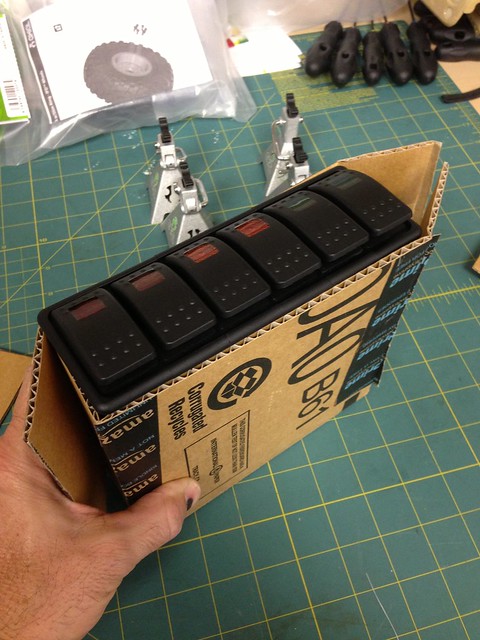

While hooking up the brain of the sPod system was easy the switches is just ONE PLUG to plug in SIX SWITCHES!!!
This is going to be EASY-PEEZEE!!!

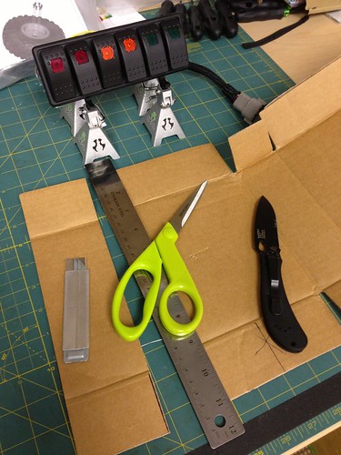

I started with some cardboard for a template and to test fit into my rig. If I like it I can make a pattern from it.
Plus I am in a major rush as I was about to leave for King of the Hammers and just wanted to get the lights working. So this little switch box would allow me to get the switches in quickly. I cut the hole on the passenger side and run the ONE CONNECTOR through as this is the side my sPod brain is wired through on the firewall. (scroll to the top of this page for the sPod installation if you missed that part).

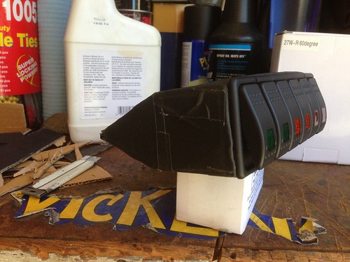

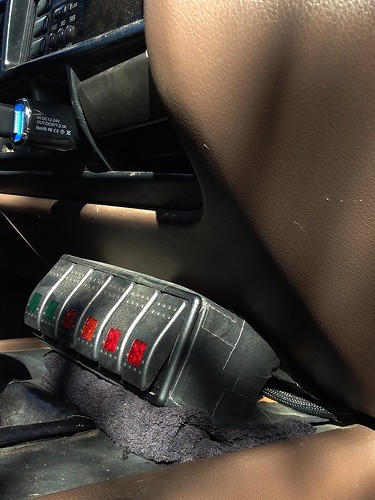

The switch box is upside down here as I was looking at how the switches would look flipped.
Ergonomically they work better the other way around...
And then when trying to place my switch box on center console I then saw the need to wedge it to fit it closer in line with the dash, so I had to make some adjustments on the fly!
So it would temporarily fit like this. And it is still currently mounted as such as time is still on backorder for super-duper custom mounting!
