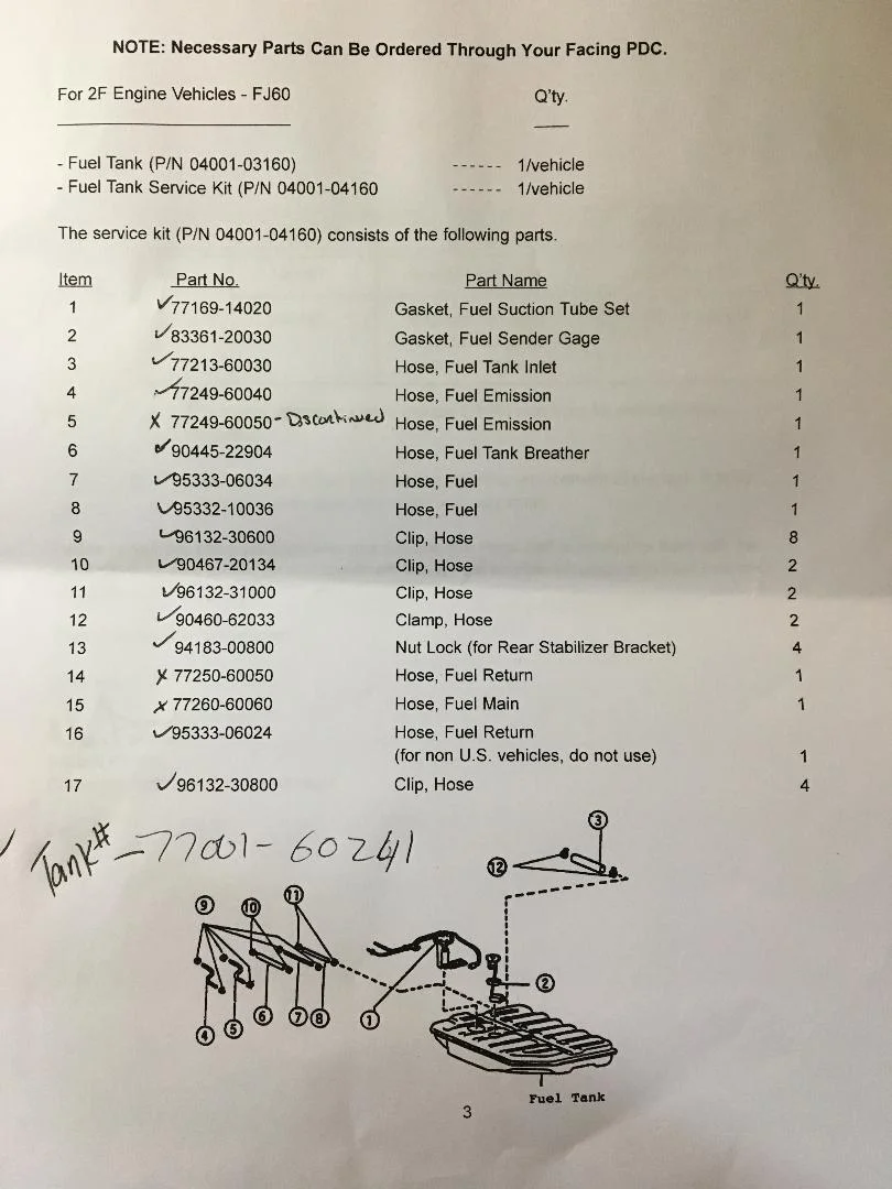

below are the part numbers for the kit that was sent out with the 1991 recall. There are a few hoses that are NLA marked with an X. I just picked up my 60 from Fred Haas Toyota in Spring TX. They replaced the tank and fixed the rear seatbelt guides per the recall. Since they were replacing the tank I had them go ahead and replace the fuel pickup on my dime.

Thank you @Skeet
To verify from your post this is what is needed?
"The discontinued fuel hoses are 6mm and 8mm ID. Picked up 10ft each of Gates 1/4" and 5/16" ID. This should be enough for new rubber on everything fuel related."

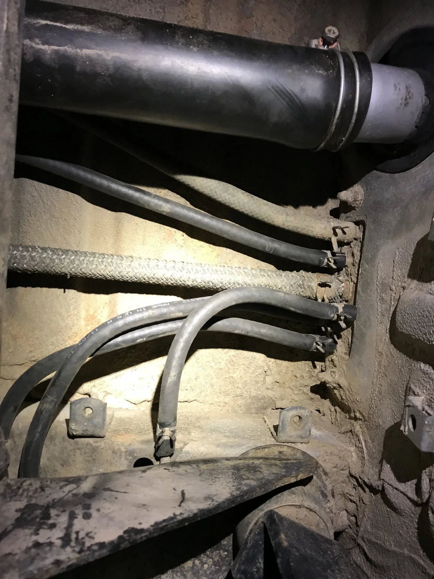

So I swapped all the 1/4 fuel lines and then I go to swap the slightly larger lines only to find out the 5/16 hose doesn't fit anything.
I need to get the last few replaced before I can breathe easy on this weekend's upcoming trip. Next post shows the used hoses I am looking for.
These are the exact lines I need.

Yeah, those last few are weird diameters. I got to the same point you did. We might need to find something off another OEM.
I am almost to the point of pulling the hoses this evening than travelling over to NAPA and any other place I can think of to simply try and match. The 5/16 hose is sitting unused as I cannot find a use for any of it. Maybe the 2F had them and not the 3FE? confused on that part.

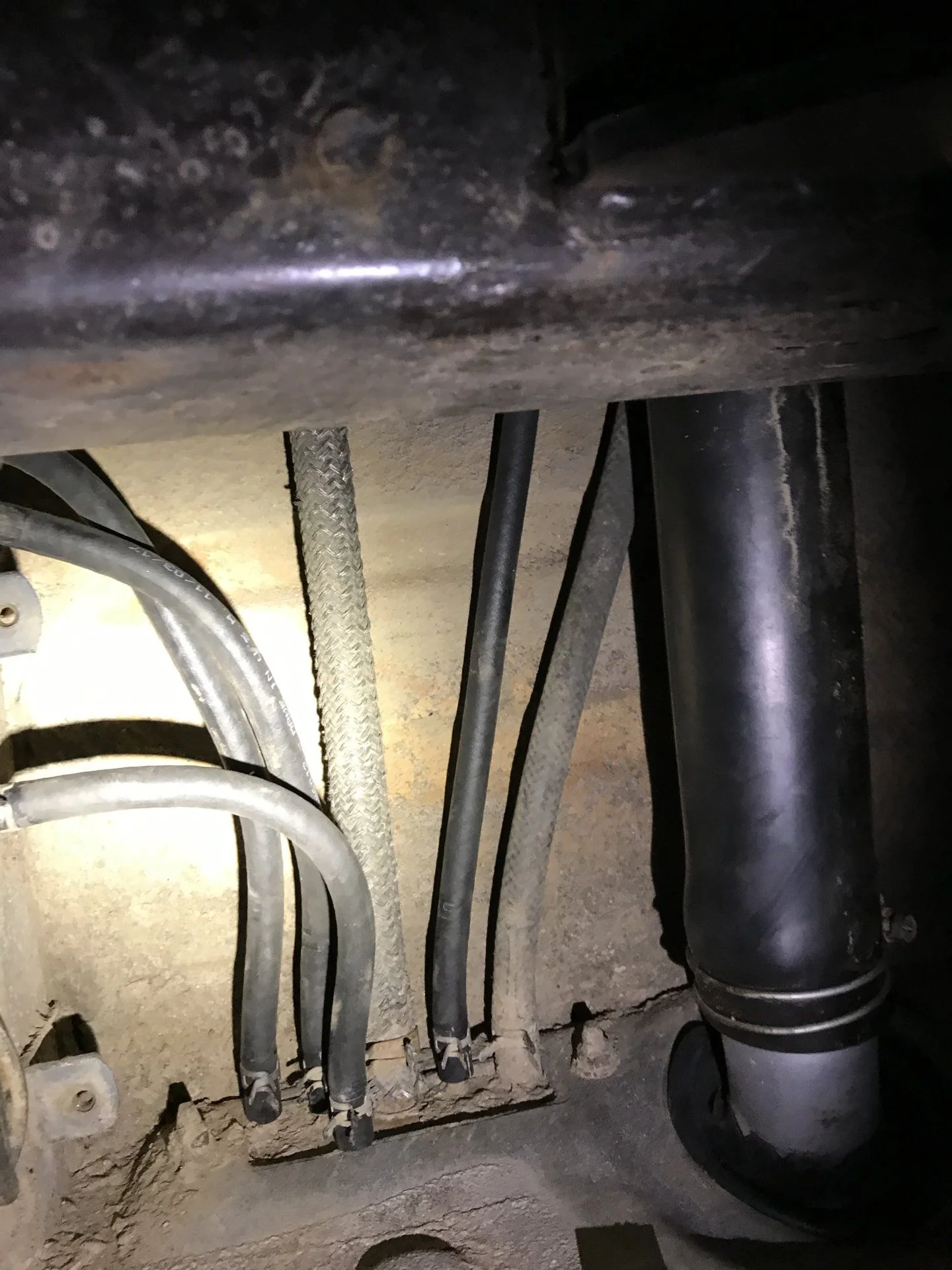

I don't remember the sizes, but I replaced mine with generic hose from AutoZone. Take one off, drive down there, and go in the back. They will have what you need. It won't be OEM and pre-bent, but it will be much more affordable.
I took them off and drove to Napa. I used 3/8” hose for the stuff that was slightly larger than the 1/4” small stuff.
For the large hose under the truck from tank to evap I used 5/8”.
I also used 5/8” from filler neck to evap.
The 1/4” and 3/8” fit well enough. The larger 5/8” is a bit big and I had to use threaded generic hose clamps instead of OEM tension clamps.
