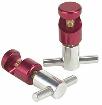

A set of these for some extra safety. I usually clamp one side with a vise grip if it's windy out or I'll be under the hood a long time.
http://www.amazon.com/dp/B00BVL7QJK/?tag=ihco-20
Thanks TXLX - haven't seen those before. May have to get a pair.
