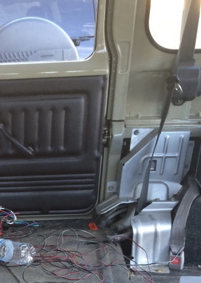

Just behind the cover, passenger side just left of the door opening (silver in pic #1).

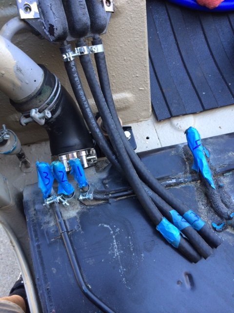

You should see something that looks like pic #2. Sometimes these connections can loosen or the lines go bad.

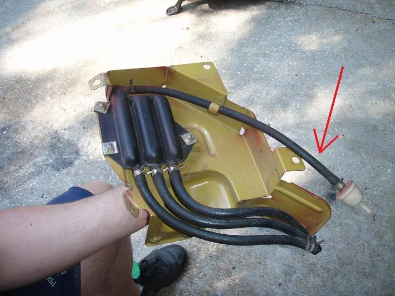

FYI - be careful with the plastic separator/manifold, it can be brittle after many years of service. The below pic was the culprit of my gas fume smell inside my rig.

I also had fuel smell issues the last couple of years. Before ripping out your fuel tank try replacing these 4 hoses that go to the evap unit from the tank with new fuel line. (Apologies for stealing this picture) My lines were original and didn't have any obvious cracks but I replaced them anyway as they were over 45 years old last summer. Completely eliminated the fuel odor in my 76 plus it was an easy and inexpensive fix.

I may have found the source of the smell (hopefully). After taking into account all the great feedback and comments, I checked the Evap Separator and tubing and discovered that one of the nipples had been broken off a LONG time ago and the whole thing was Jerry rigged by the PO with a piece of steel tubing pushed into the Separator and the tubing half-assed taped on. It wasn’t working at all. Do, assuming that is the problem, I’m on the hunt for a replacement Separator.

If you can find a replacement separator, you can probably use some JB weld around the metal tube. It's not the first choice, but when one of my nipples broke off, I superglued it just to hold it in place and then built up JB Weld around it with several layers. It's working fine so far. If you get a replacement which will be used I assume, be really careful with it. Most of them have become brittle over the years. Make sure your hoses are long enough that when you install it, it doesn't pull and break another nipple off.
