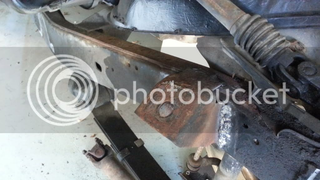

I made up a little fixture for holding the engine mounts inline for when I cut them out and transplant them into the fj frame
This is a pic of the freshly welded mounts. Welding vertically is quite difficult, so the welds are not pretty. But they will do

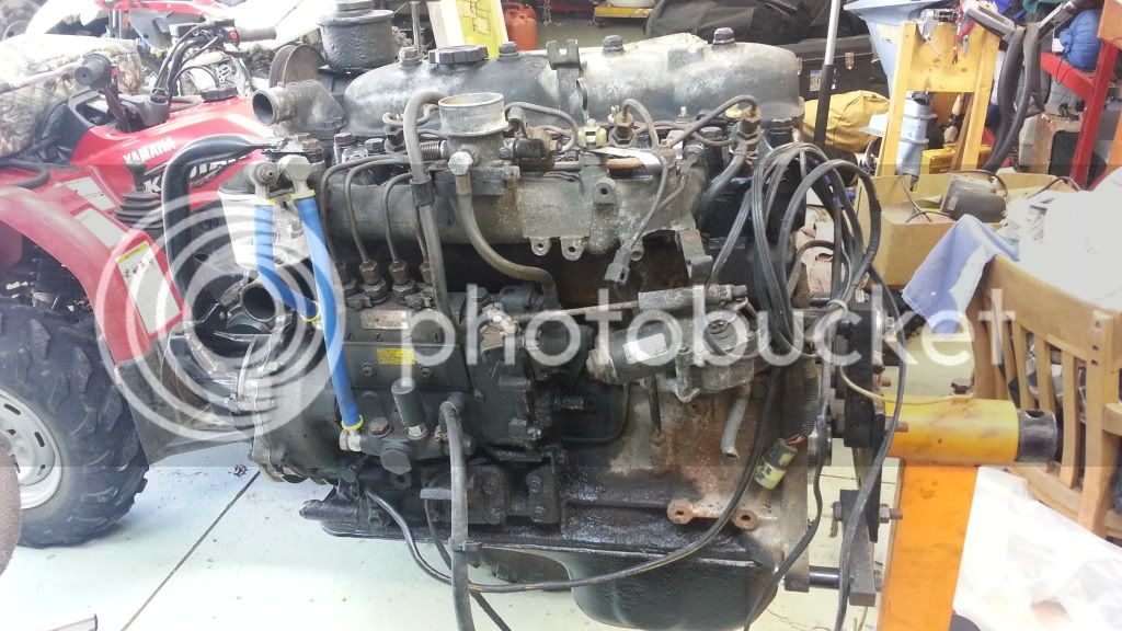

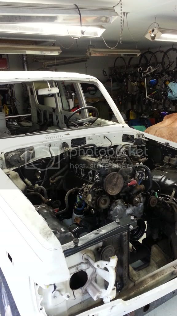

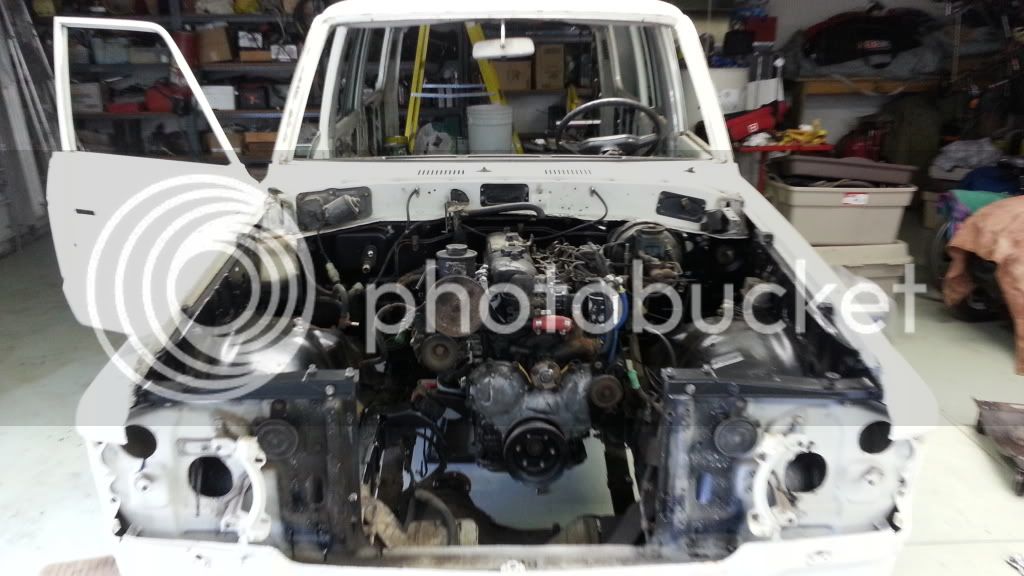

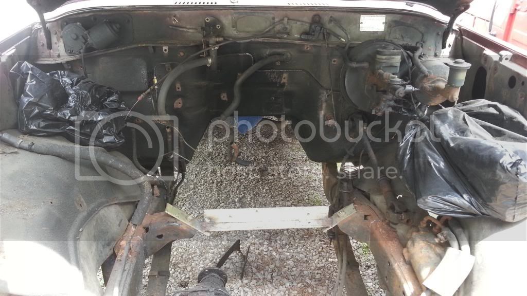

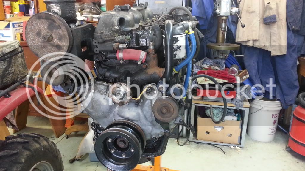

I finally got the engine back into the truck. To me this is a huge milestone for the project. This step shows actual progress, instead of constantly taking things apart, I am finally starting to put the truck back together

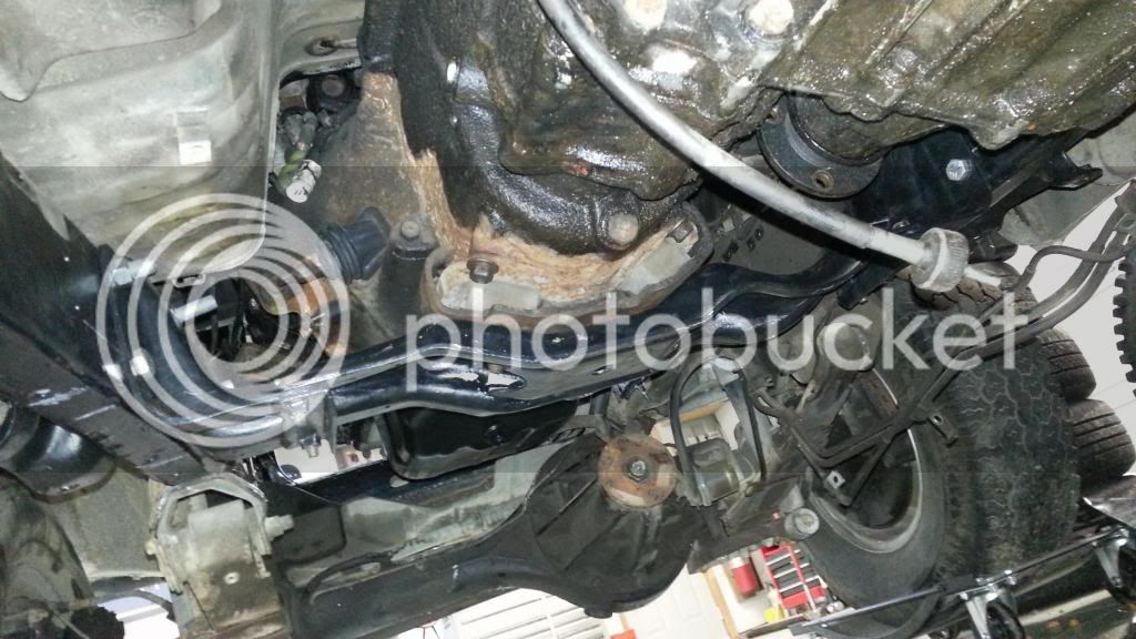

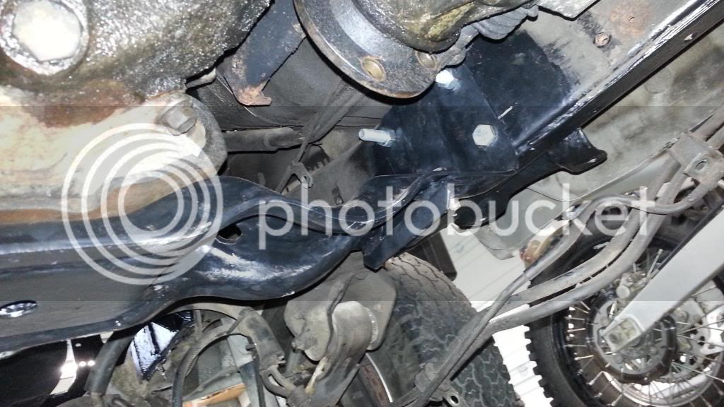

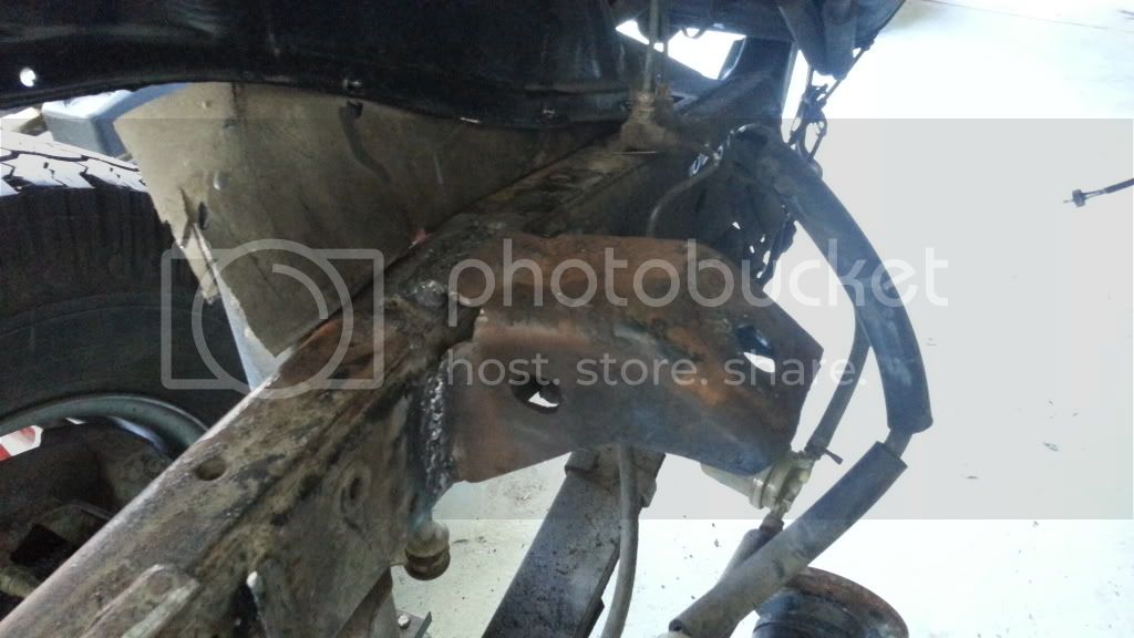

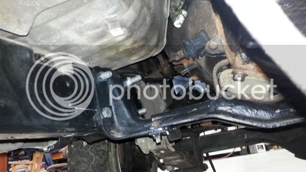

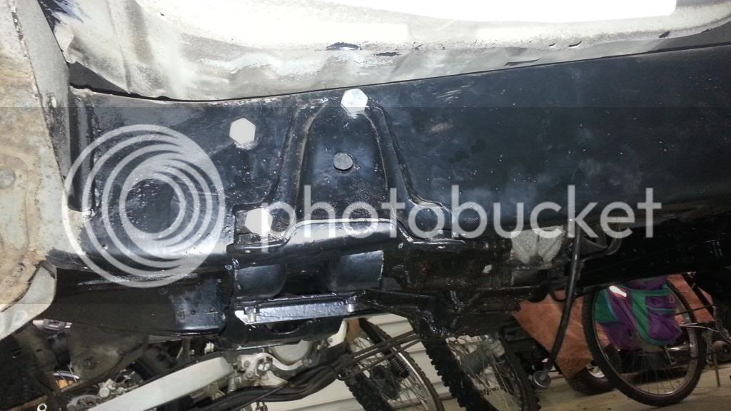

bj60 vs fj60 transmission cross member
I was asked about how I installed the transmission cross member so I thought I would post it in case it helps some one else.
The fj60 has mounts for the cross member welded to the frame. The bj60's are bolted to the frame.
The first step was to grind out the mounts on the inner frame so that the bj60's could be mounted in there place.
I was going to grind off the outer mounts as well, but it was alot harder of a task than I thought it would be. So I just left them.
I then inserted the engine and transmission into place so that I could locate where to put the transmission brace mounts.
Finally I drilled 4 through holes on each side of the frame and bolted the bj60 mounts in place. Worked perfectly.
Here are some pics for reference
As a note I would like to say that the bj60 was a fairly early model year and the fj60 was a fairly late model year. So I dont know if all fjs have welded transmission braces

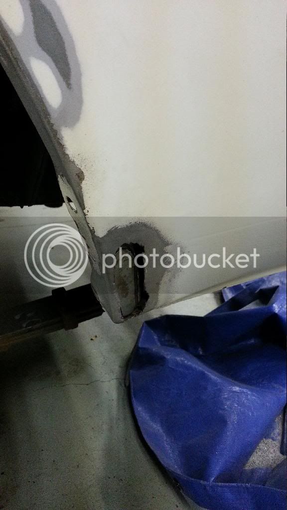

I got a week off work and I am going to spend a lot of that time prepping the truck for paint.

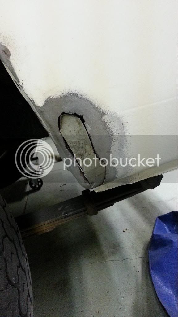

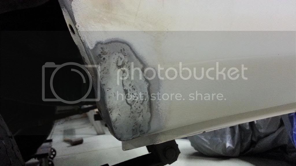

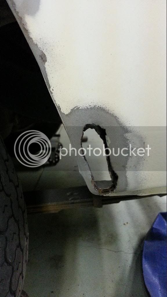

Even though this truck is from California, it actually still had rot. I thought it was just a rust bubble, but when I hit it with a hammer, it went through both sides.
Sorry I spent the morning putting a patch in. It is the first patch I have ever done, and I think it turned out rather well.
my welding skills suck, so I didn't show a picture of that.
Unfortunately the patch sat a bit low on the one side, so I have to fill it with some filler.

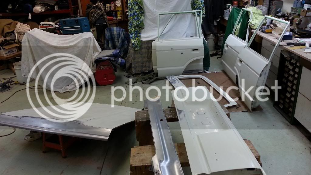

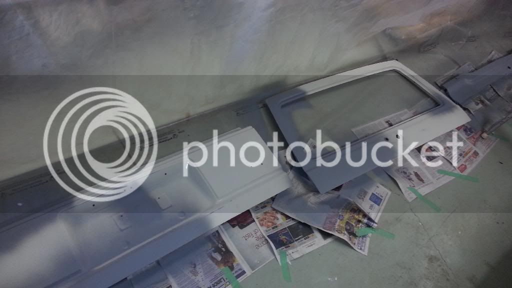

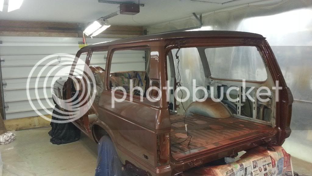

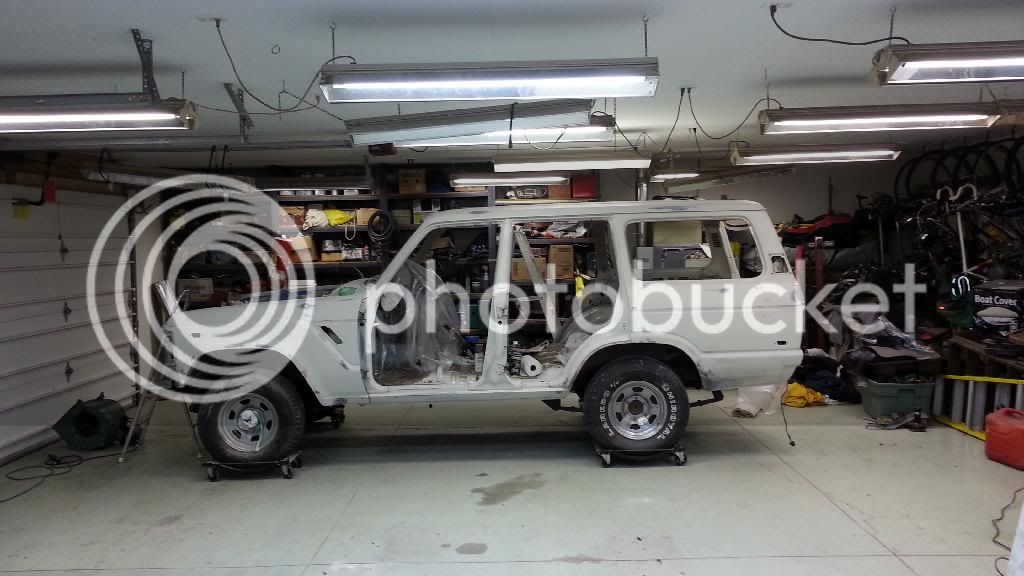

got paint on the body
]I had some spare time during the holiday season, so i was able to spray the body of the truck.
Unfortunately the white really bled through the paint and I had to do many coats to hide it.
I did 4 coats everywhere and a 5th on the roof.
but the final product turned out really well. There is some dust particles in the paint, and I am not totally sure how I can get rid of those. I might try buffing when it's dry

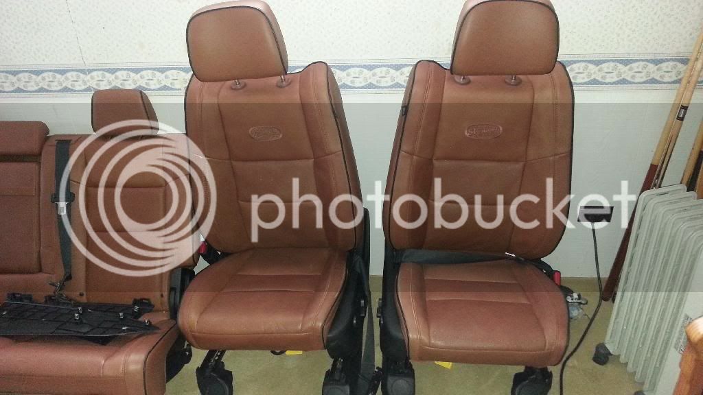

I picked up some new seats for the 60.
The original ones were falling apart, and these were a great deal
I probably won't get around to fabricating brackets until i have the truck all back together. Unfortunately the rear wiring harnesses on the American truck was different than mine, so i have spent the last few days with my dad trying to splice the two together.
What are those seats from? they look really nice!
They are out of a new model grand cherokee, they have power everything and are heated and air conditioned.
I won't use the a/c part of the seats but I need the heaters and power motors to work.
I haven't inspected how they work but they have a 21 pin connector. I was hoping they would have 1 power wire for the motors and another for the heating pads

Bolted trans support instead of welded
