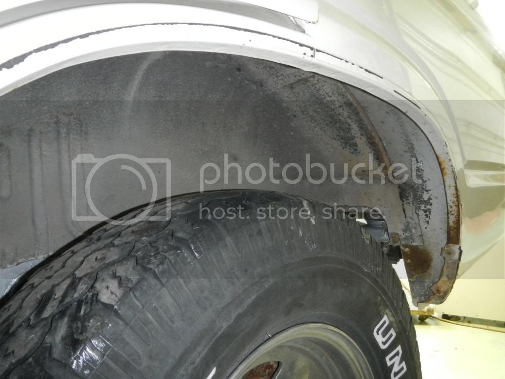

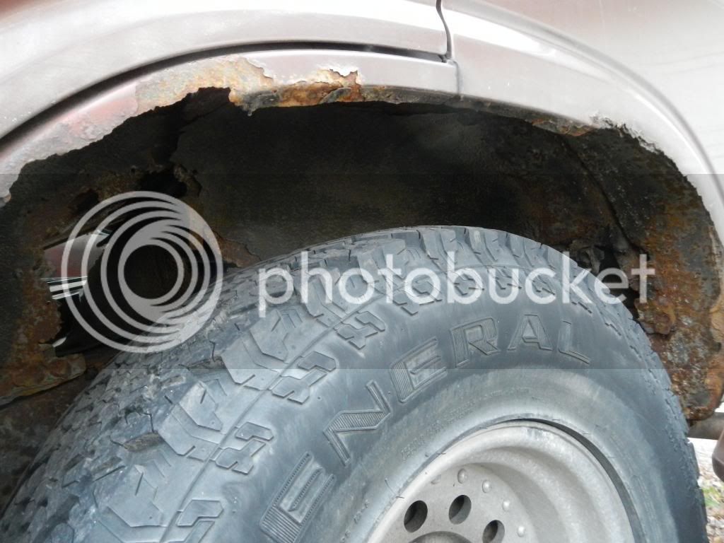

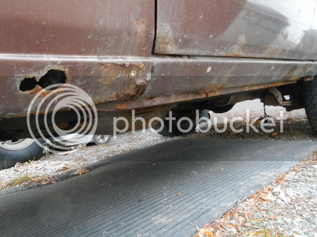

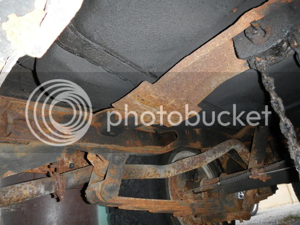

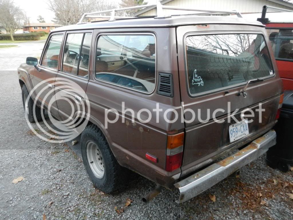

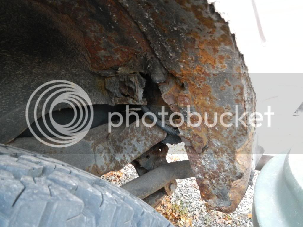

I go my cruiser from my dad, it was my trusty college car and served me very well. But Canadian winters were tough on it and I decided to do a body restoration to get rid of the cancer all over it.
Very quickly into the restoration I smacked my hand on a rusty fender that left me with an incredible wound and over a month off work.

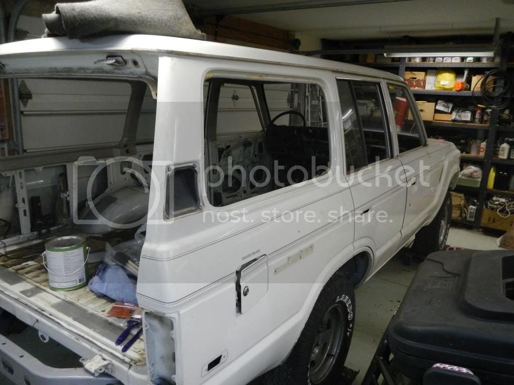

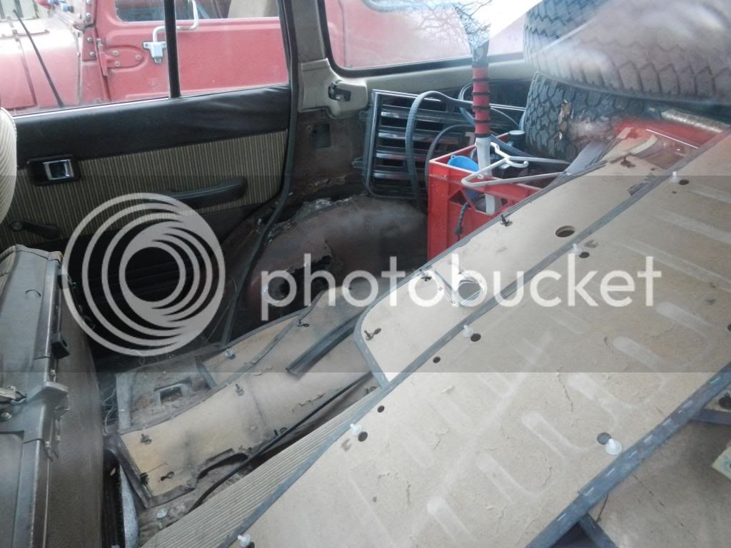

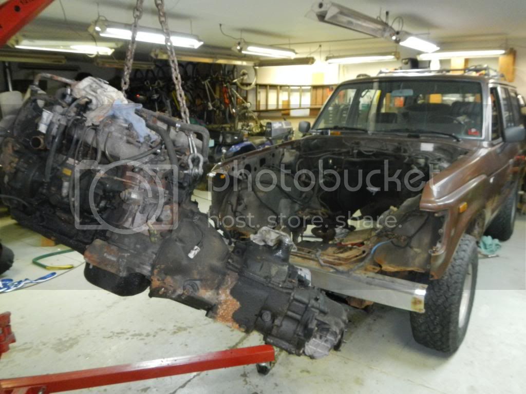

During that time I had alot of time to think and i decided to just buy a clean body from california and transfer all the stuff from my truck into it.
So I contacted a member on here and drove out to pick up the body.
I must say that I am very thankful for the California weather, it keeps old cars alive.

Look forward to watching this build. It is always exciting to see an old rusty BJ60's
drivetrain get transferred into a rust free US 60/62. B.C. is littered with diesel 60's
sitting idle due to rust. Really is a shame. Please Post up some photos of the donor truck !

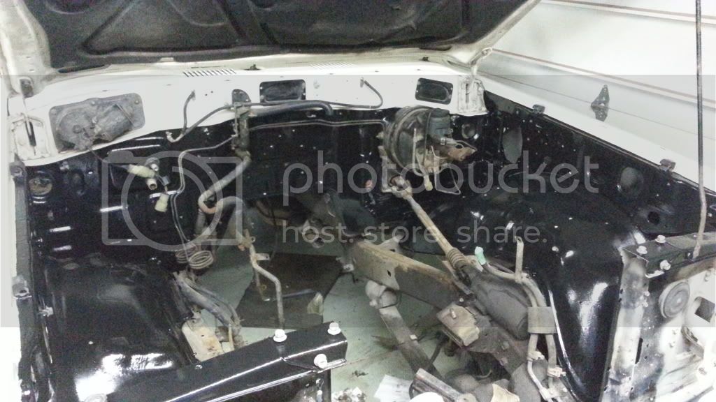

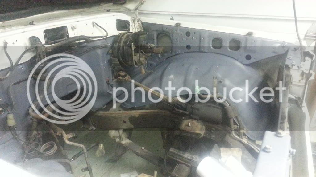

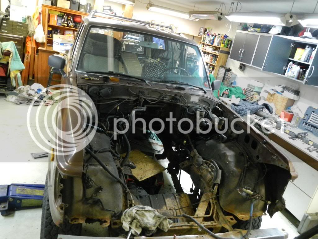

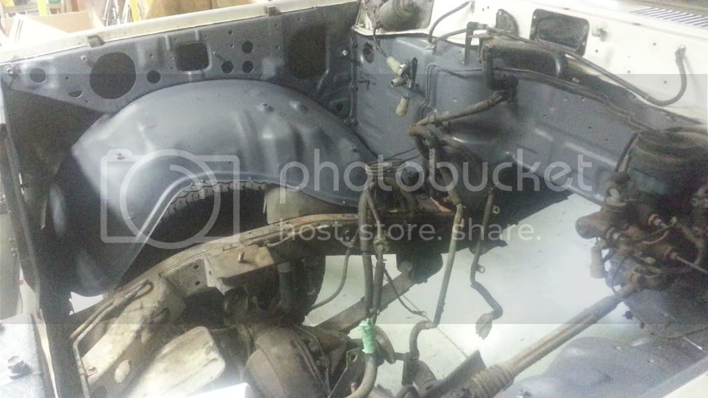

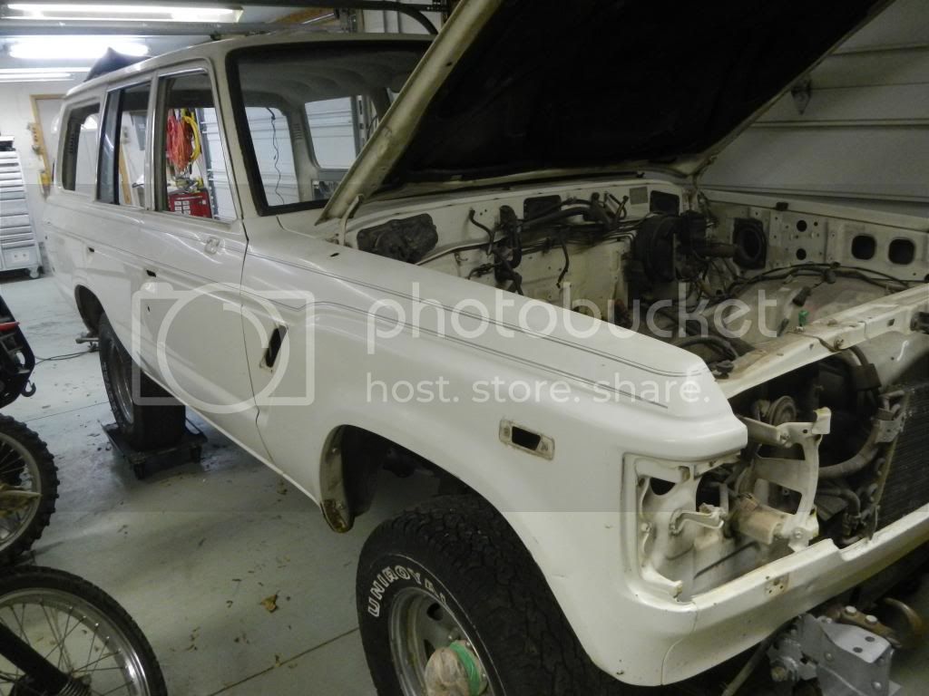

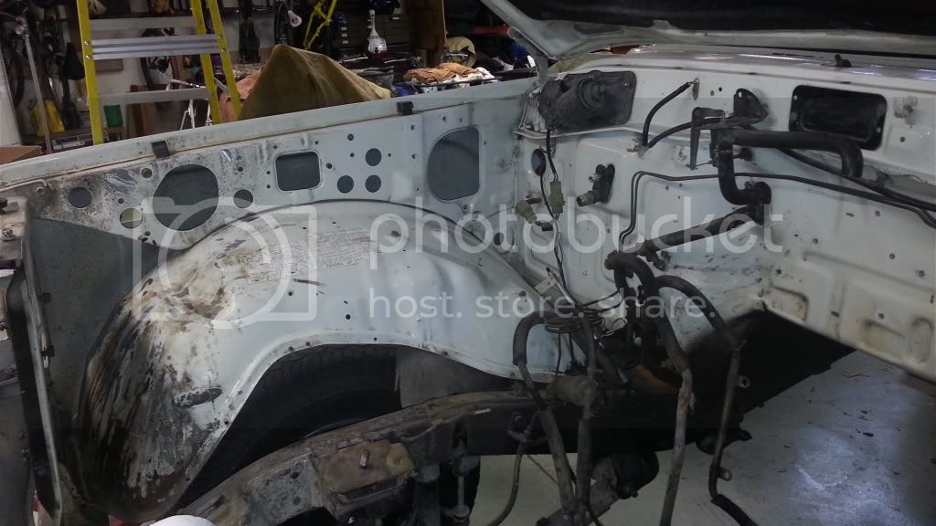

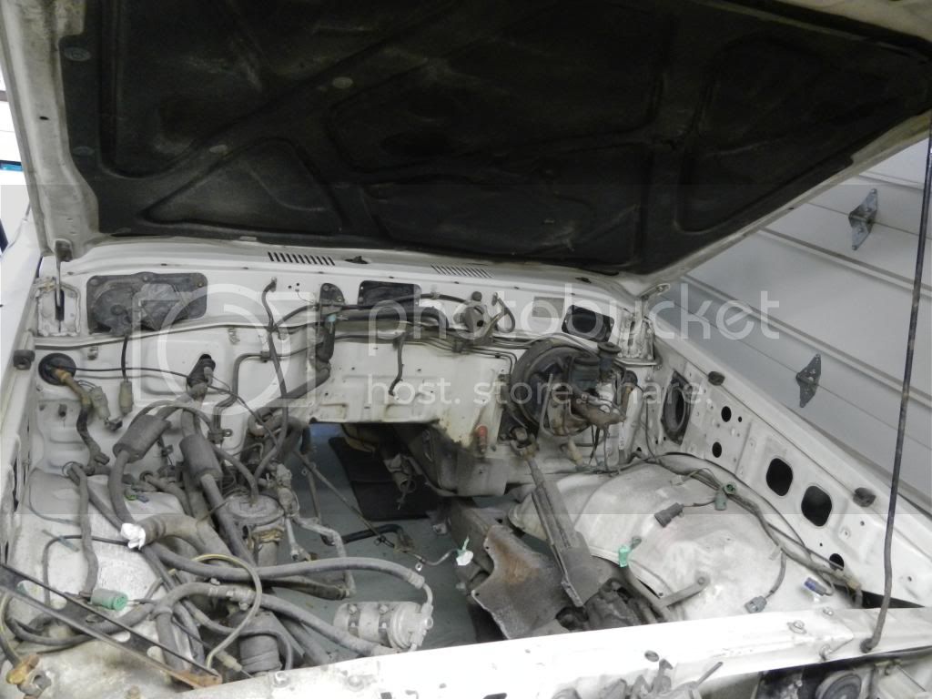

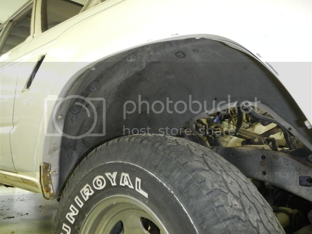

I plan on painting the cali body brown, the white engine bay would look a bit garish in contrast. And because I am throwing a 3b in there the engine bay is going to be black in no time due to oil and soot.
So I opted to just paint it black right off the hop
I didn't do anything fancy, just sanded primed and painted.

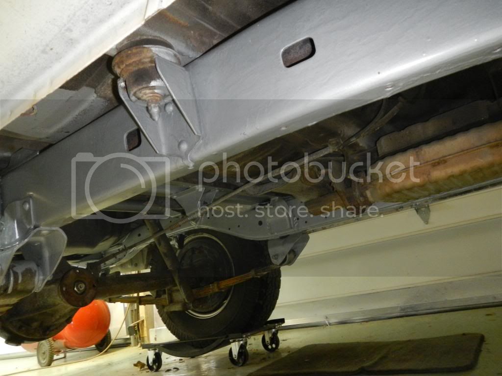

Next up will be the frame, while the body of the truck is in 9/10 condition, the frame was actually in fairly rough shape. I would give it a 7/10. Unfortunately I forgot to take pictures of it before and after sandblasting
did you mask and rattle can or brush somehow? How did you get around the hoses, etc?
Because I am swapping in a different engine I removed almost all the hoses and wiring, I then used some brushes to do the actual painting. It gave me the precision to paint around all the leftover tubes and wires, eliminating the need for masking tape. It took awhile, but I like spending evenings in the garage. I don't usually care about the fastest way of doing things, I am more concerned about the most pleasurable way

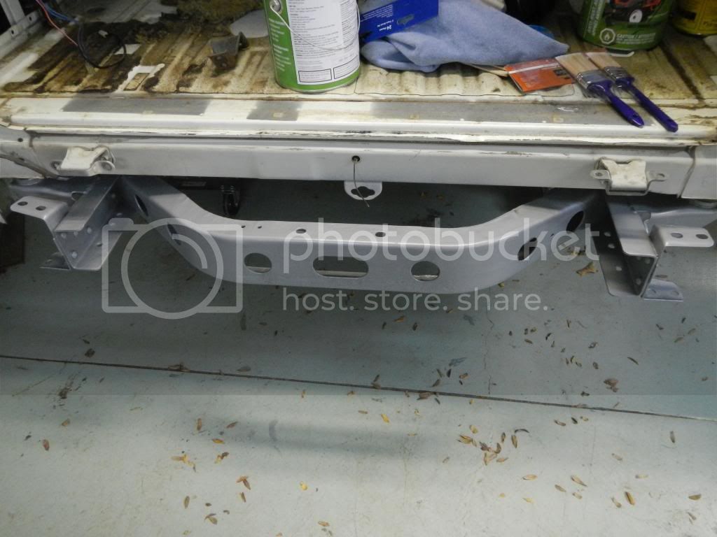

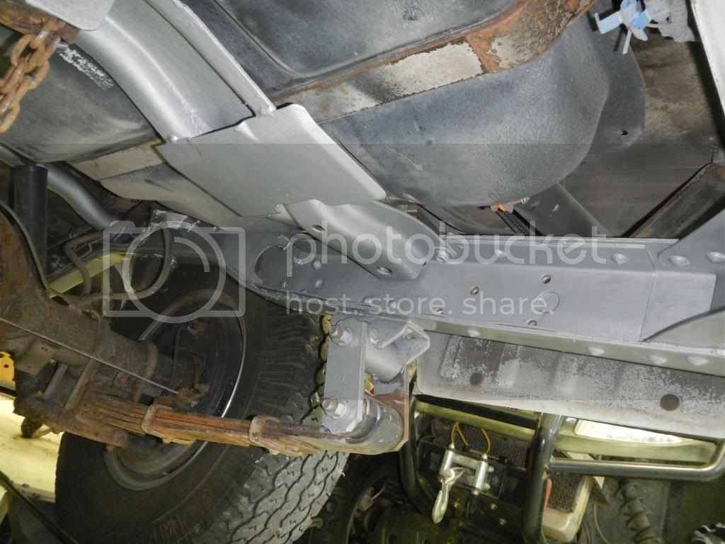

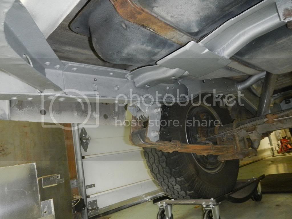

I spent a day wire wheeling the frame, but I couldn't get it into alot of places because of how bulky it was.
So I tried sandblasting for the first time. I was amazed at the difference, I thought I was doing a good job with the wire wheel, but it looked like garbage compared to what the sandblaster could do in a fraction of the time.
After sand blasting I applied 2 coats of master series.
Next time I repaint a frame I think I will do it with the body off, unfortunately I do not have the room at this time to do that.

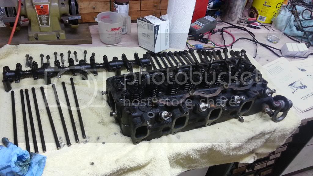

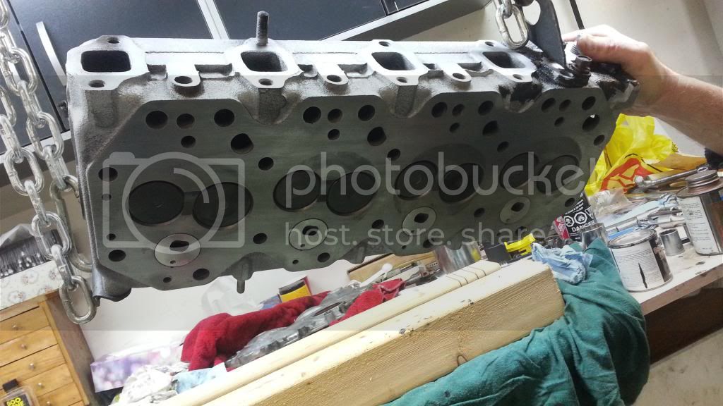

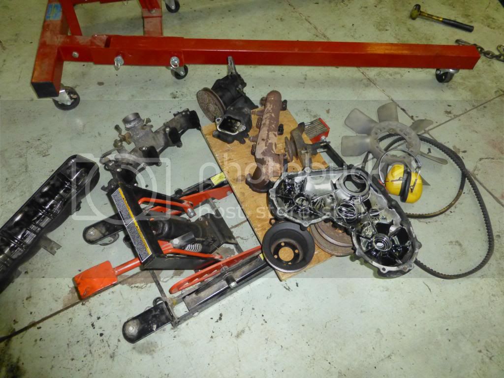

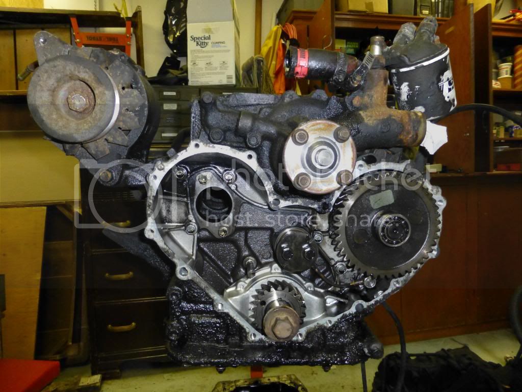

I plan on adding a turbo to my 3b so while the engine is out I thought I would freshen it up.

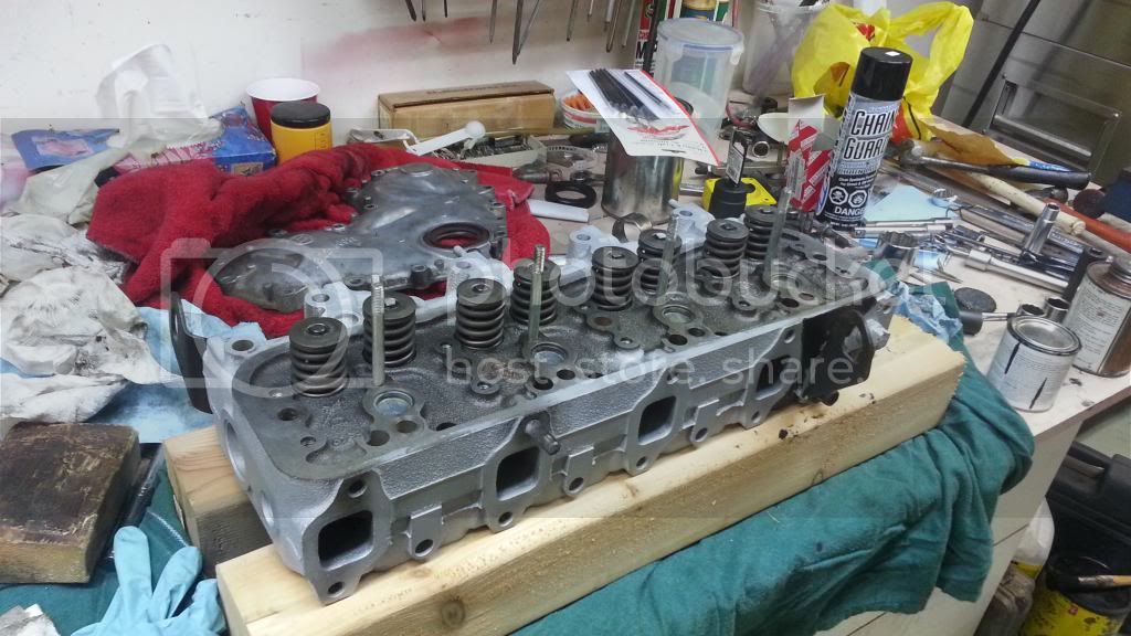

I did my cam bearings, and the front one had an incredible amount of wear. The other two were in good shape but I replaced them while I was in there.
The head needed new valve seals, they were all shot.
And the precups had quite a few cracks, so I had new ones installed.

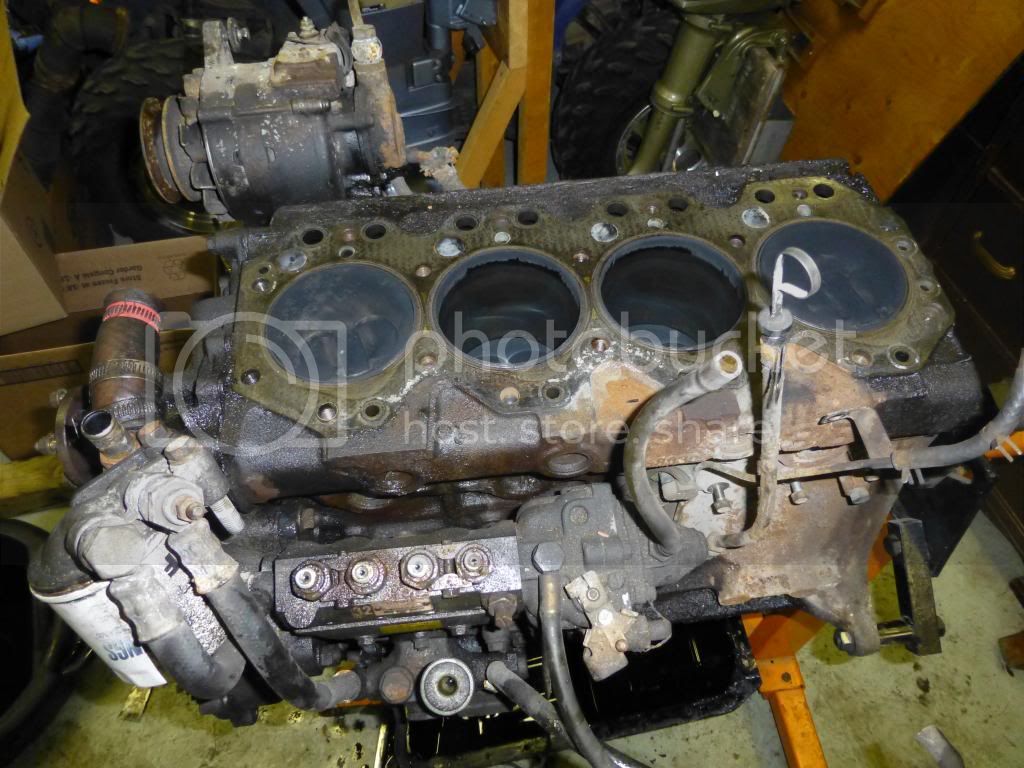

I used plastigauge on all the crank bearings and they are all in spec.
And the cylinders have a small amount of glazing but its not bad at all.
All in all I am very impressed with the robustness of this engine, it has 430k kms on it and I see no reason why it cant do another 250k
