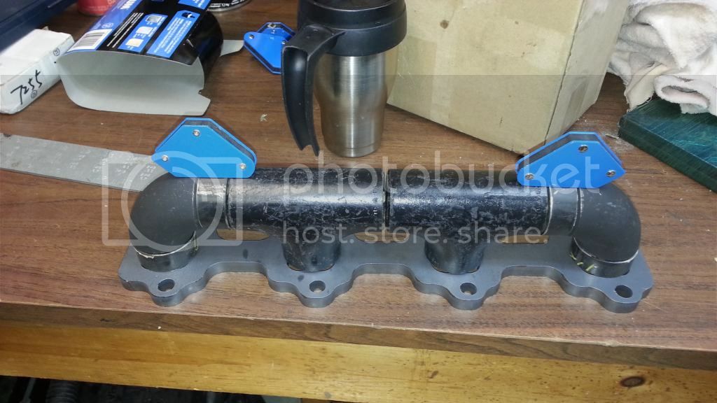

Had a great day today, I have a local shop bending me up a bumper shell. And I got started on my exhaust manifold.
Please excuse the booger welds
Tomorrow I hope to clean up my welds and fab up the adapter for the turbo.
That manifold looks killer, although I'd watch that those welds don't leak or might actually kill. :)

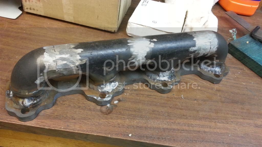

I also did a leak test on the exhaust manifold I welded up yesterday. It failed miserably. So i loaded it up with way more welds. I'll post a picture later, it's pretty funny.

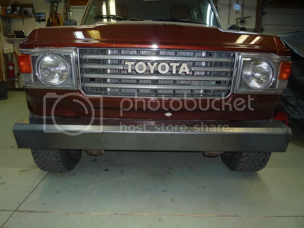

They say imitation is the most sincere form of flattery
I'm going to try an combine your design with the stock bumper.
The straight bumper just doesn't look right. It needs angled wings
I had intentions of making a front and rear BEEFY OEM style, but not that much interest.. Let me know if you need a picture of anything to help you along.

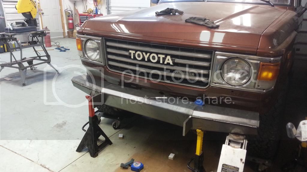

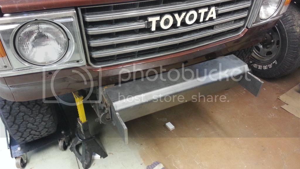

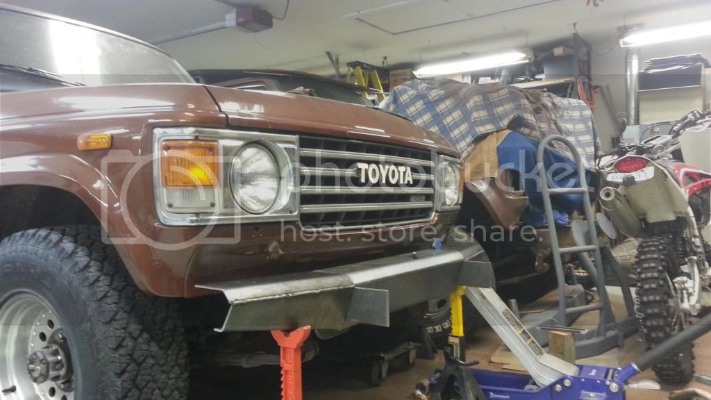

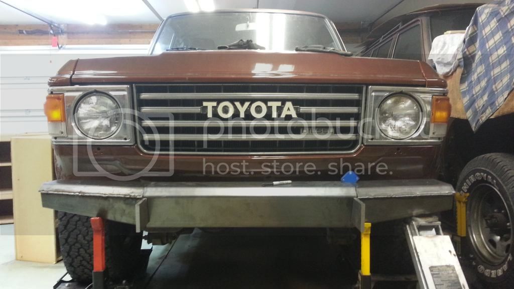

I got started on the front bumper today.
I started with a wooden template
then I set myself on fire grinding the frame mounts. TWICE!!

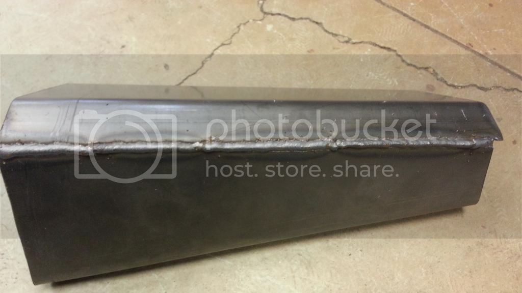

I got the center section roughed in today
I started on the wings, but they are proving to be difficult. The shell was not perfectly bent, and the wings are misaligned due to the order in which I cut them.
More to come tomorrow

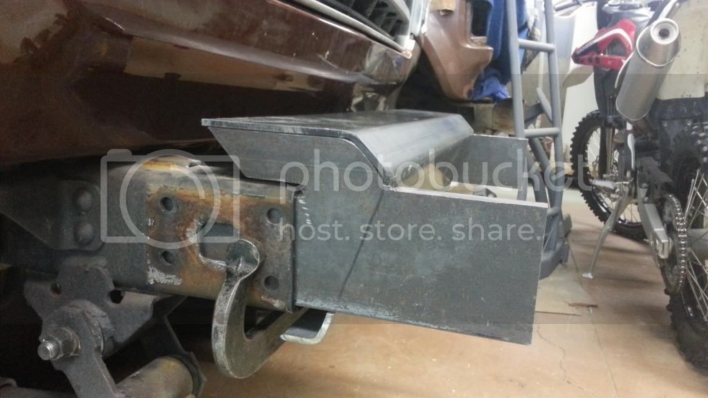

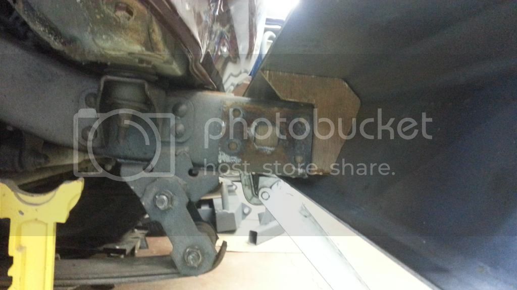

I love how you went around the frame instead of cutting it. Looks awesome :cheers:

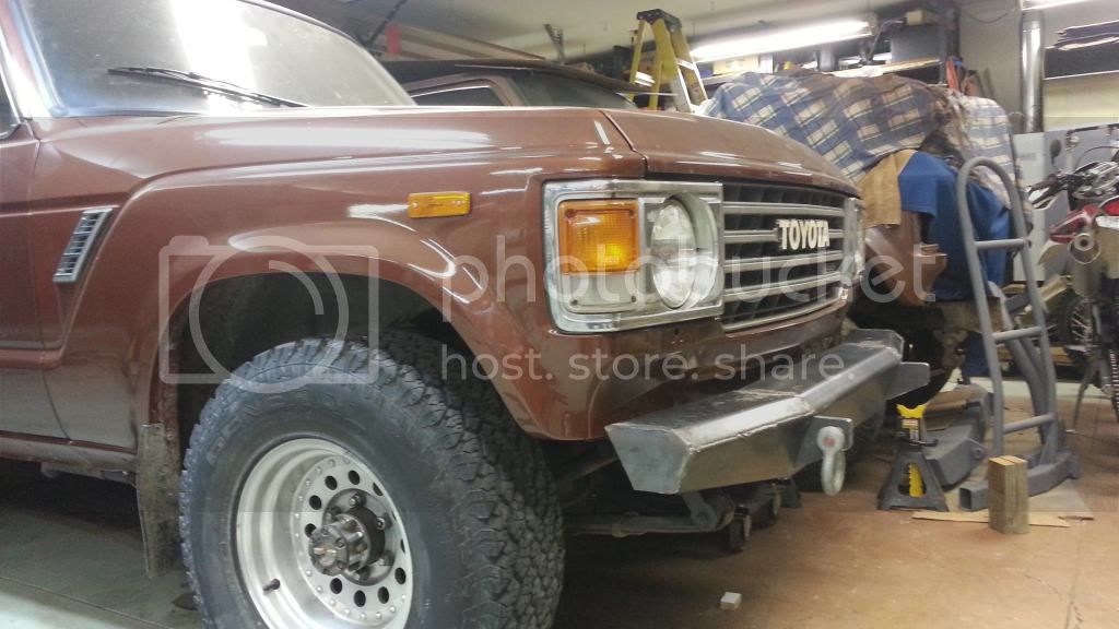

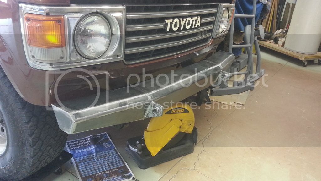

Got the wings of the bumper roughed up. I need to chop the ends and get more steel to make caps.
Overall I am very happy with it, I made a few novice mistakes. I am having troubles with the wings deforming from the heat.
My welding skills have increased 10 fold since I bought this truck.
Productive day
Good job! Nice to keep the frame stock too!
Thanks, you and @GLTHFJ60 both commented on that.
I honestly didn't know that the frame got molested on most trucks. I just made them the way it makes sense to me.

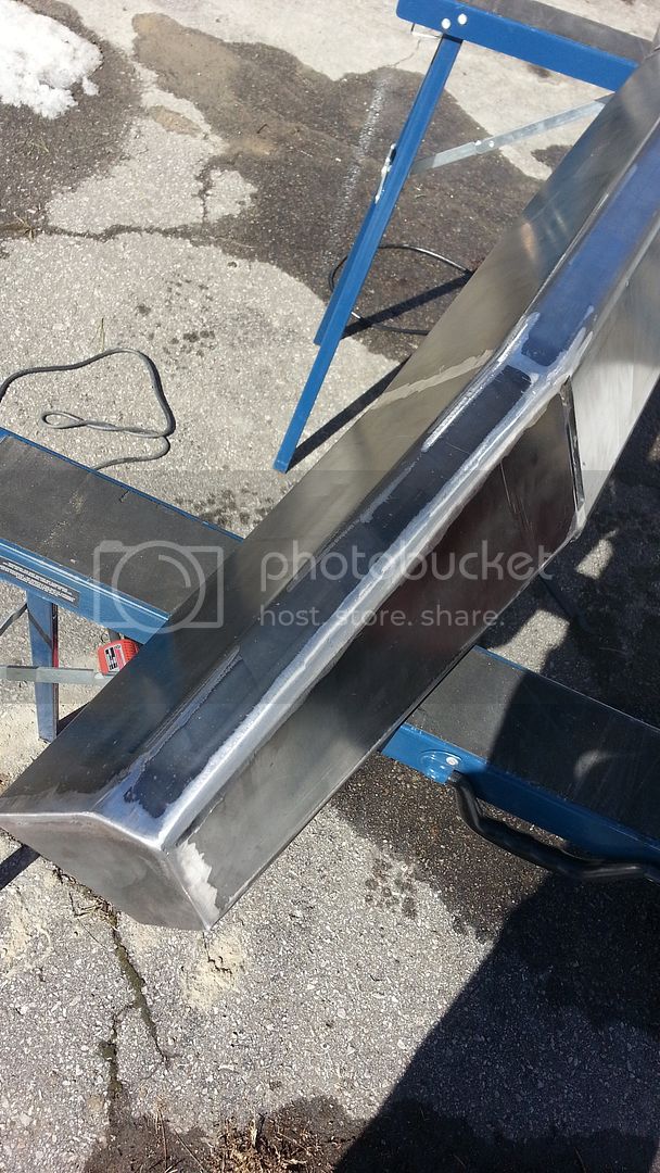

Hopefully tomorrow I can tack the final product together. I am so nervous about welding it. My ability has increase alot this year, but I am probably only a 5 out of 10 welder.
She'll hold, but I want it to look nice
Hi G, have not been on here for a while, things are looking good! I sent you an email a while back about a good time to call but you never replied...
I did what you did as far as mounting the bumper on the frame, no reason to hack the frame...to avoid warping just do 1 or 2 inch stitch welds, don't weld one long bead (as fun as it is), let things cool then go back, also, tack things in place and clamp things in place if possible.
I'm calling you tonight
Made progress today, got the shell all welded up. Just need to clean up all the welds then weld on the frame mounts.

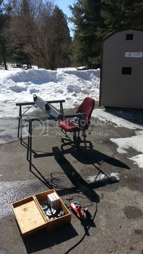

We finally got some reprieve, it's 30F today, so I set up shop outside and finished up the welds.
Big shout out to @reevesci for the advice, my one flat weld joint is a bit wavy, but the rest are all pretty good.
I'm just having lunch. I'll finish it up in the next few hours

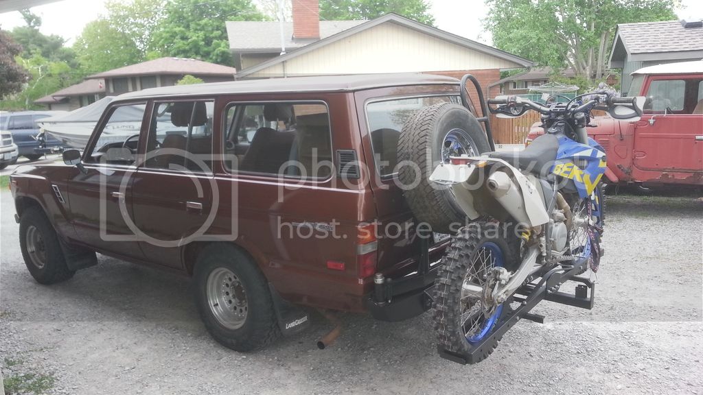

Put the truck on the road this weekend. Felt awesome to drive it again.
my exhaust broke in half right in front of the muffler. Every time I hit a bump it sounds like the truck barks haha.
Got the bumpers on and proceeded to load up and take a bunch of my stuff I was storing at my dad's.
I was thinking of running the new exhaust on the outside of the passenger frame and doing a side exit in front of the rear wheel.
