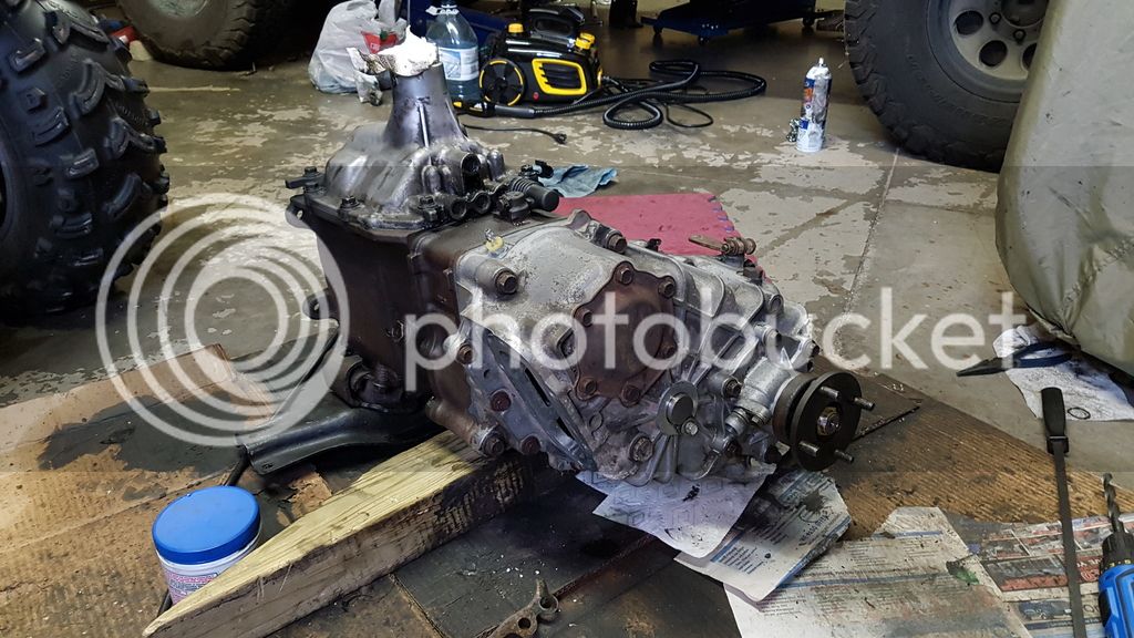

So I got the case close up and reinstalled in the truck.

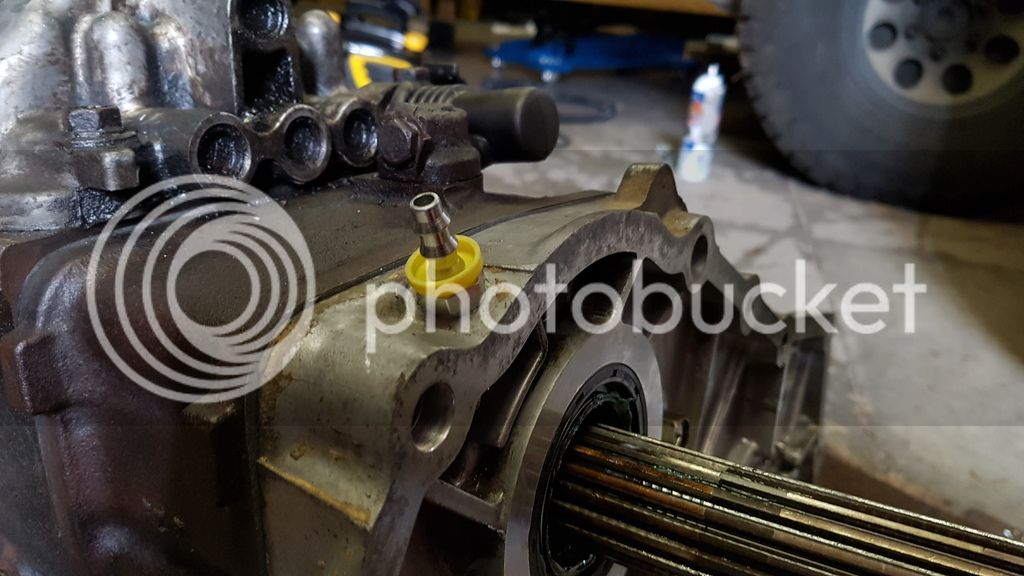

I removed the stock vent and drilled out the hole and tapped it so I could install a vent with a hose.

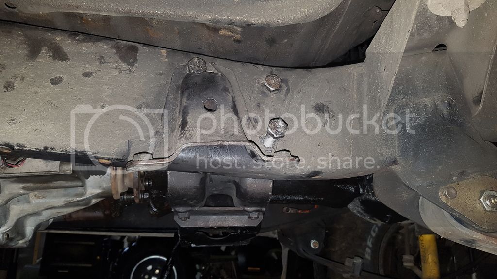

It always bugged me how I hacked together the transmission crossmember, so I finally got around to grinding off the old ones. I will paint the frame in the spring when it is warmer.

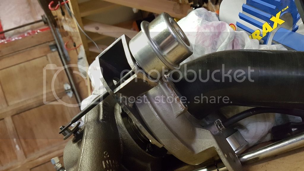

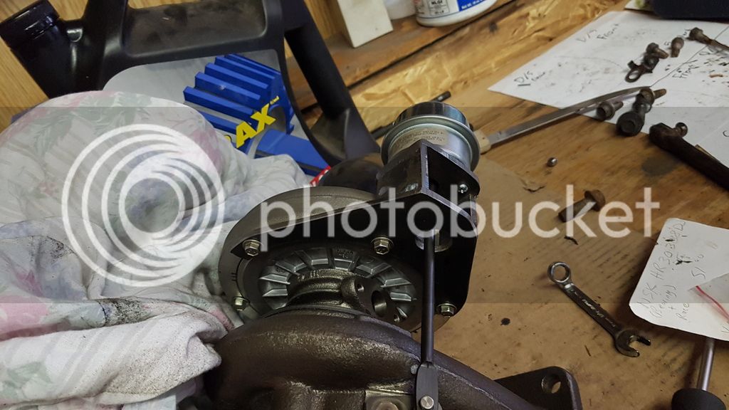

Spent a day fabricating a new wastegate bracket and turbo support. I only took pics of the bracket.
It's stout

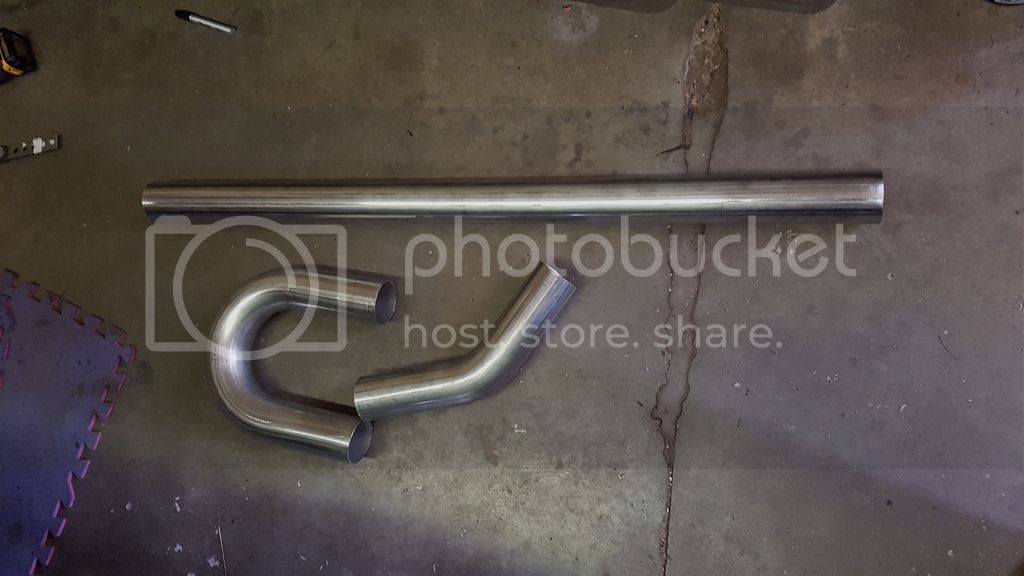

I started with some 3" tubing, this picture is actually just my left over pieces.

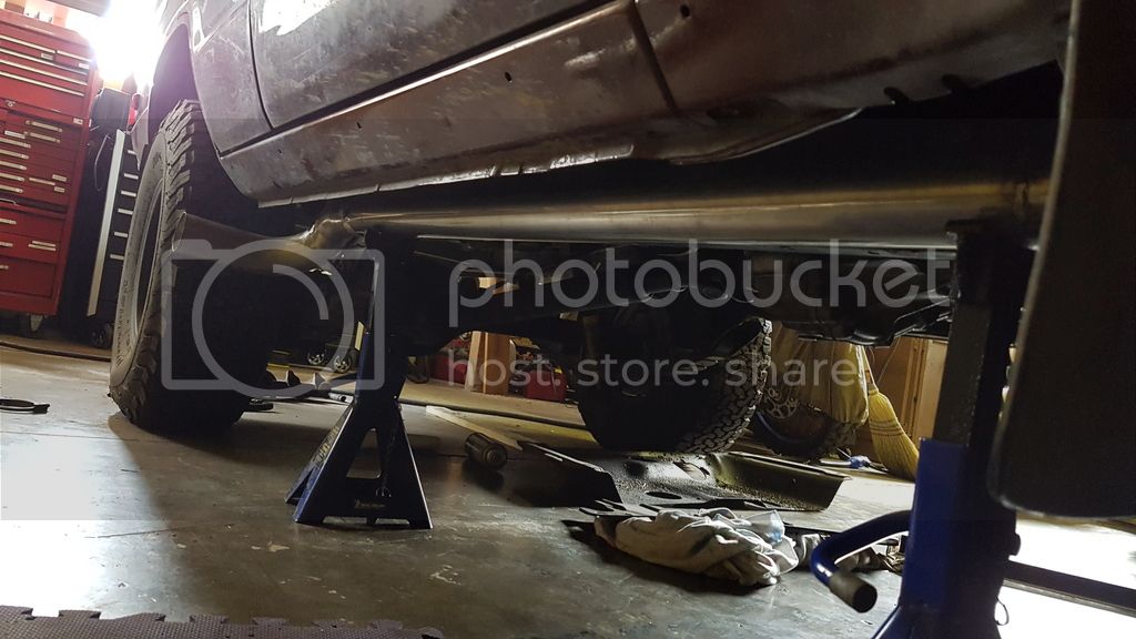

I've got a decent gap between the firewall
Routing it through the leaf made the most sense
And then exit out the side
I might rework it a bit in the future, but for now i am happy with the result
Hope that won't create too much heat on the spring bushing, looks good though,
How come side vent as opposed to running it out the rear?
If the heat is too much I will replace the bushing and rout it another way.
I ran it out the side because I like side exits. The only downside I can find is that it makes the rear tire jet black from diesel soot.

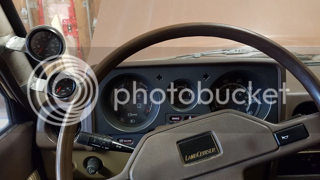

I ordered a gauge pod holder back in january, it didn't show up after 3 months. So I contacted ebay and got a refund and then ordered on from amazon, it showed up but definitely won't work.
I decided to just build some out of scrap aluminum instead of wasting time trying to get it to fit.
