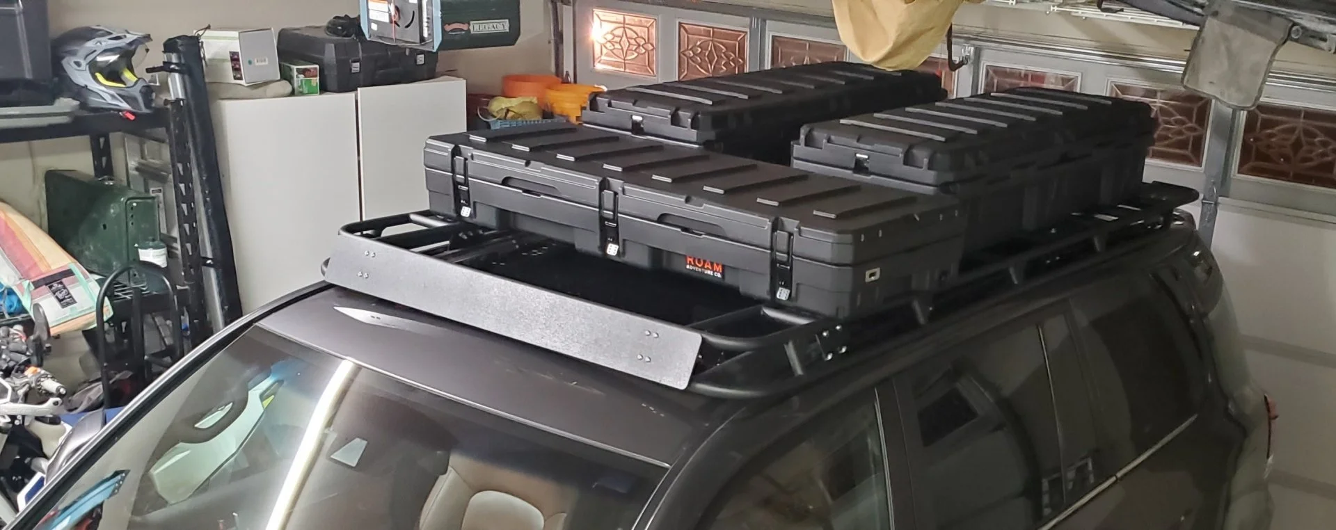

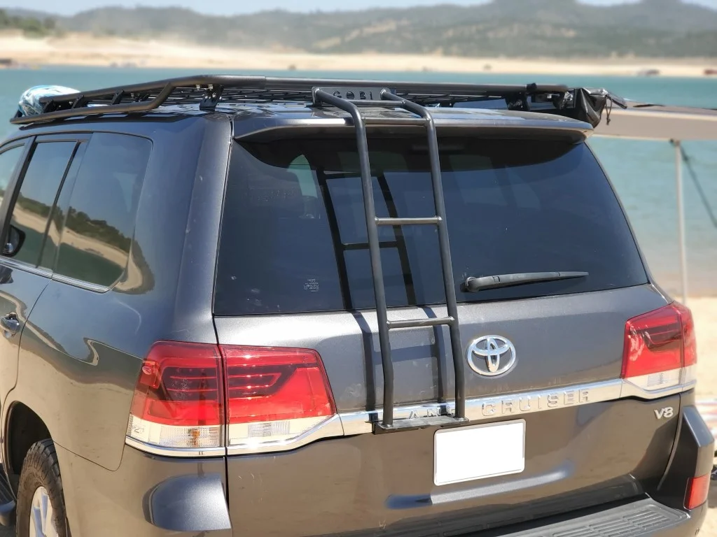

I spent a lot of time looking for a low profile rack and rear ladder combo. Gobi was the only option (withouot a custom bumper) but it would interferre with most low profile racks and keep the hatch from fully opening.
I have to give it to Tim at Gamiviti for making this design work.
Tim spent (probably too much) time with me designing the perfect rack for my needs and customized the rear support to have clearance for the Gobi ladder. We were not sure how it would all come together, but it turned out to have just the right amount of clearance for both the ladder and shark fin. Thank you for all the time and energy Tim! Gamiviti truly has the best rack out there. Everything they make is awesome.
I hope this helps anyone looking to accomplish something similar.
View attachment 2740444View attachment 2740446View attachment 2740445View attachment 2740443
2nd try on the images
Hey right on! Appreciate all the props and kind words, always my pleasure to find solutions like these and so glad you are happy with it. We've done that same alteration a few more times now, also with positive results, so good to know we can accommodate that rear hatch ladder! thanks again for all the support, it's a real priviledge to be a part of this community here.

The Gobi ladder is great and does work well with the rack. Just be aware that if you were want to get a Slee rear bumper, then the Gob ladder will have to be removed as they are not compatible with each other.
It does work with the ARB and swing out, don't know about others
It would work with the Slee if you dont install the second swing out.

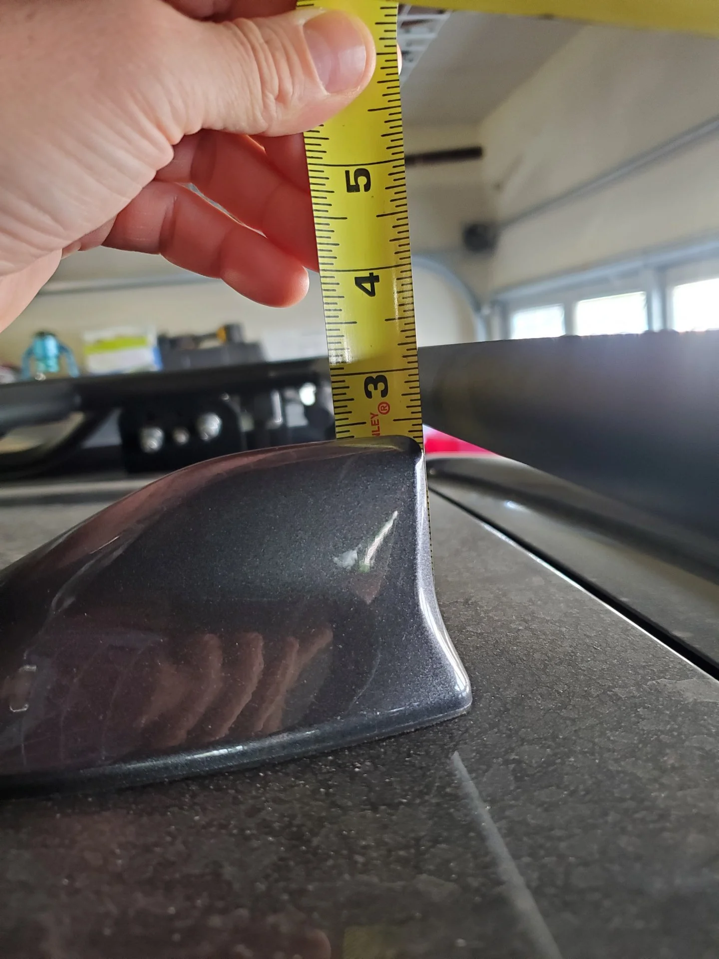

This is great! exactly what I am trying to achieve. Can you please let me know what's the distance between the roof and top of the rack near the shark fin antenna? I have very limited garage door clearance and need to make sure this is going to work for me with my current suspension.
Thanks for the help in advance.
It is maybe an inch above the fin. I measure about 3.25 inches from the roof to top of the rack. Depending on how you mount the towers it may be a little taller.

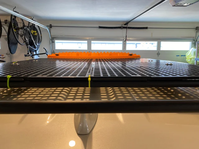

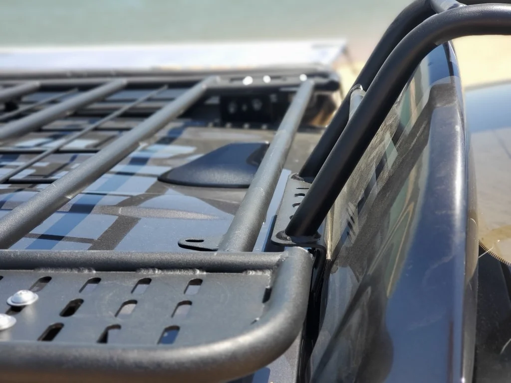

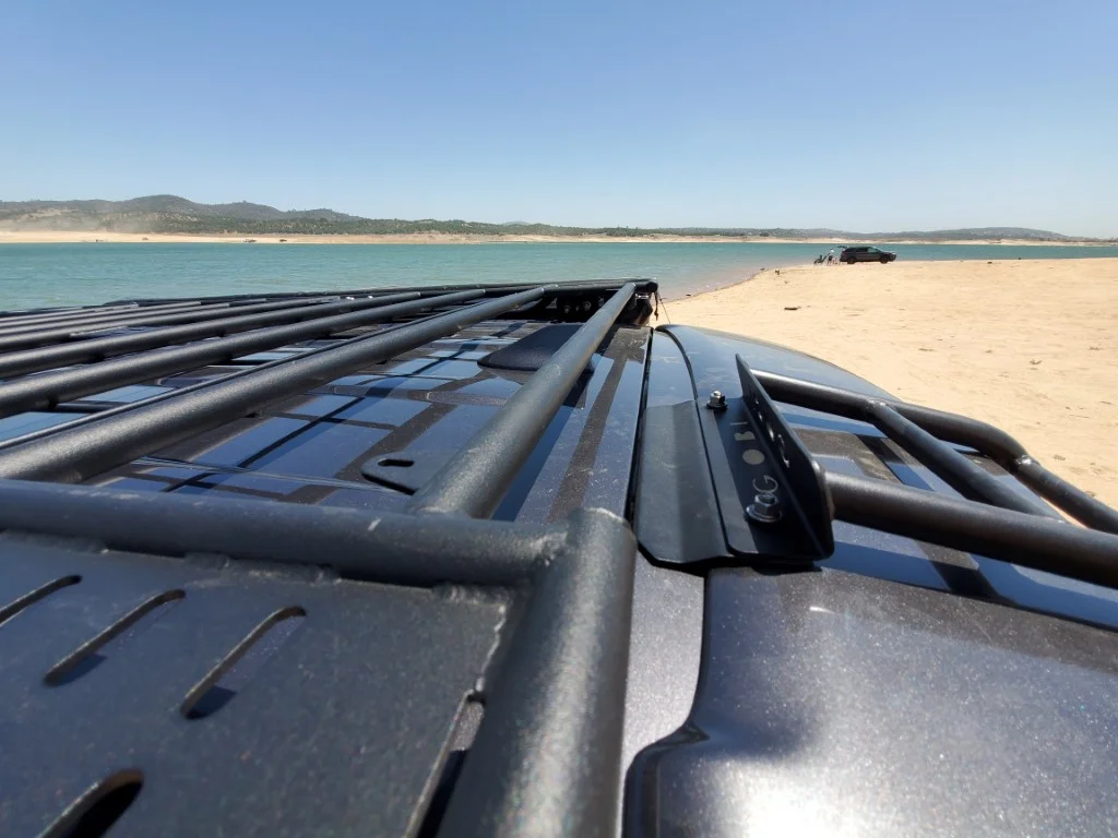

I thought I would provide a couple more pics from different angles to help you understand how the rack sits relative to the fin. It is not higher than the fin. But Tim has designed the rearmost crossbars to avoid the fin. And he was able to move the rearmost bar in a couple of inches so that it would be clear of the raised Gobi ladder. (He started doing this mod a few months back for a couple of other customers so I knew when I had him build mine that I could use the same approach).
This first picture is from a higher angle so that you can see the two rearmost crossbars. Note the yellow zip tie. (It is there to more tightly secure the plastic "pergola" layer that you can get from Tim. I have two of these 2'x4' layers on most of the time as I will be getting up on my rack from time to time. I have a third that fits over the frontmost portion of the roof rack (and covers the moon roof) and time modified it so that, should I choose, I can keep my MaxTrax mounted where they are.
Now, if I lower the angle of the camera so that the bottom of each crossbar is nearly aligned (the yellow zip tie on the one crossbar makes it easier to distinguish it from the rearmost crossbar in the picture) you will see that the top of the fin is higher than the "bottom" of the crossbars.
So Tim has managed to provide a rack that doesn't need to sit "above" the fin. By the way, Tim installed my rack.
