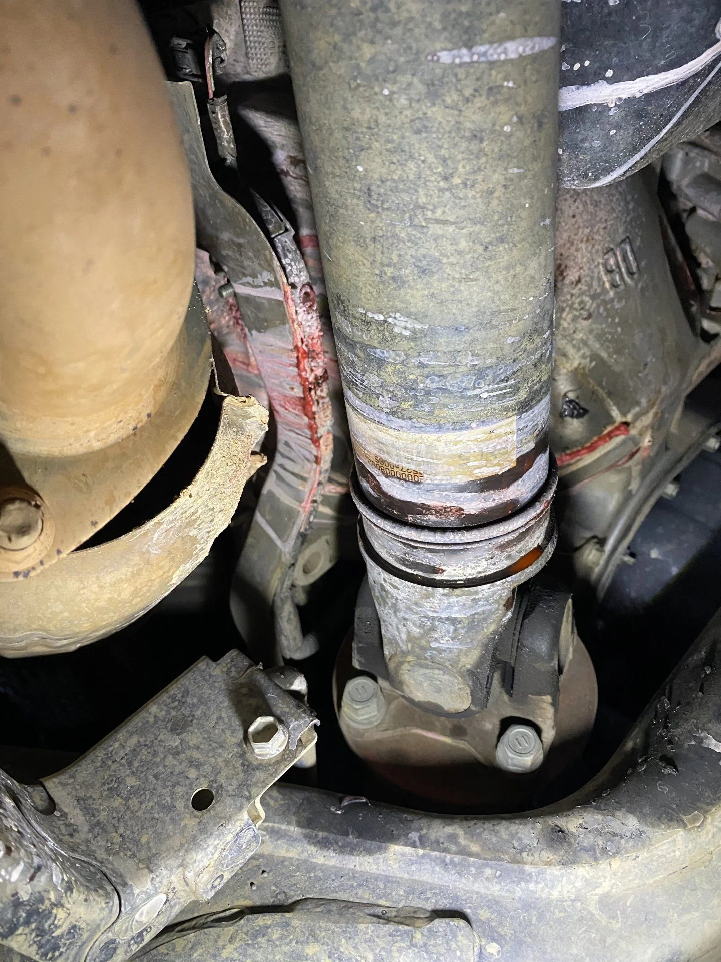

My guess is the valley plate, or "heat exchanger" as the FSM calls it. I'm at 149k and just had a similar issue. I was filling the overflow every ~4 weeks. There was nothing on the ground and no evidence of the leak except a small pink crusty trail on the transmission bellhousing on the passenger's side. Dealership tried to use a boroscope on the top and couldn't see the leak, but their answer was since there was no dripping on the garage floor and none inside the cabin passenger's side floor it had to be either the valley plate or a blown head gasket.
