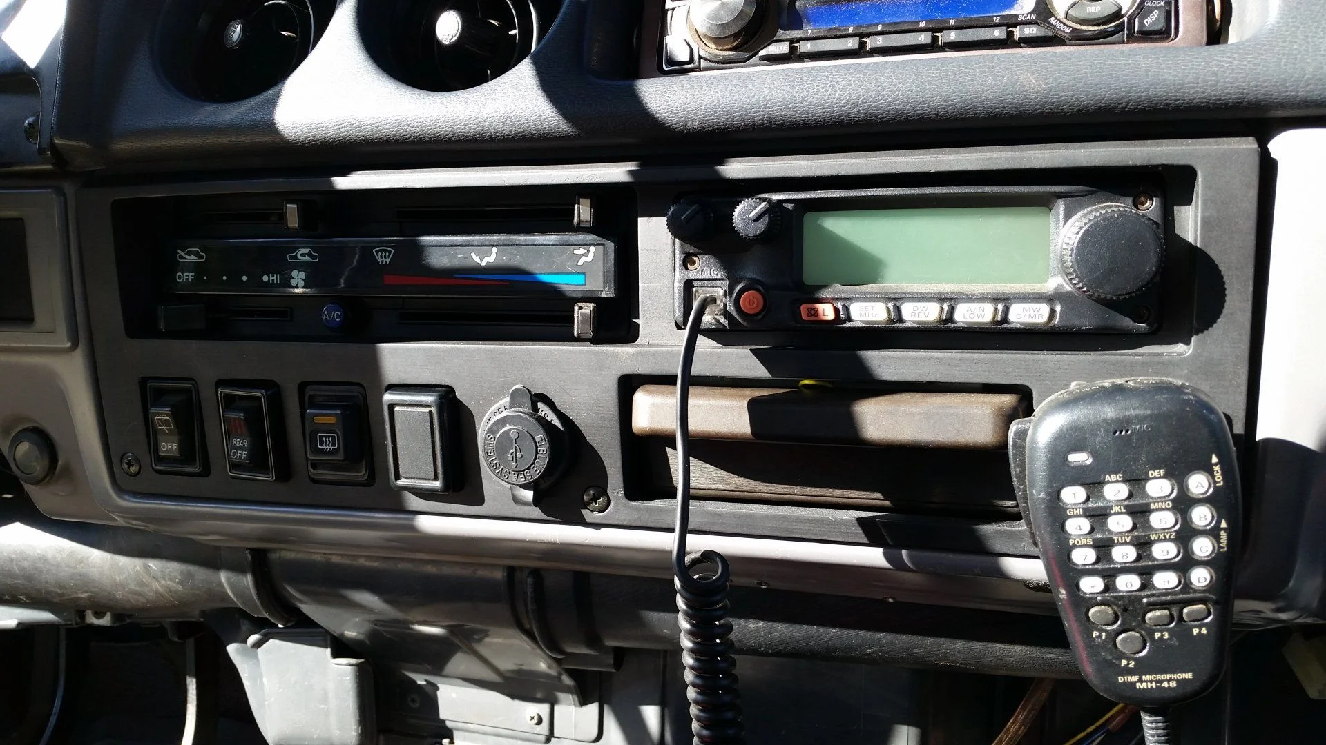

Installed Trail Tailors AC bezel and the Blue Sea dual USB charger.

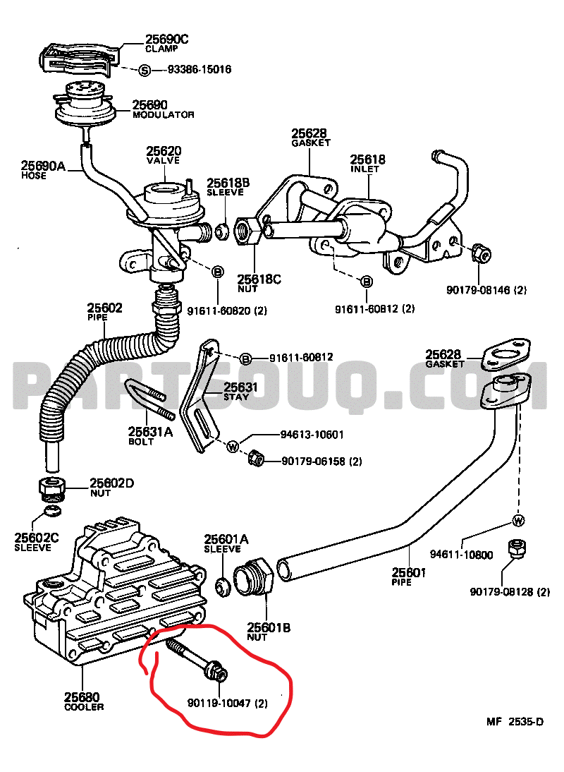

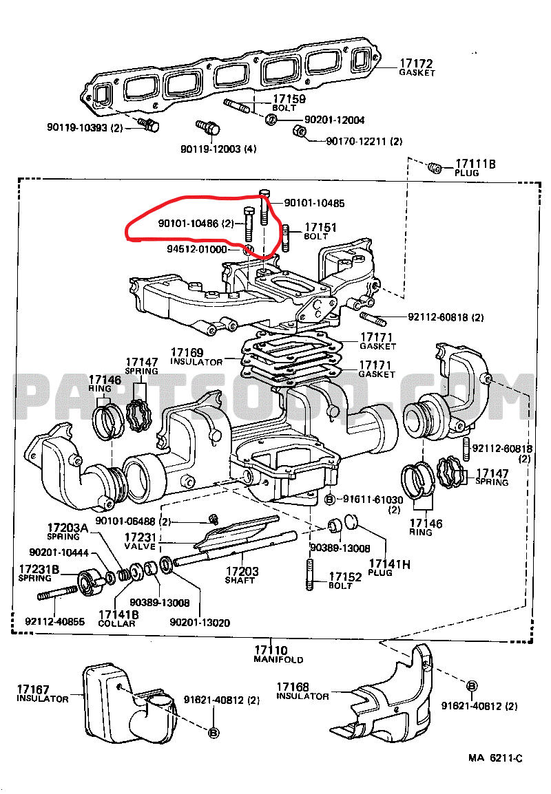

I removed my EGR cooler and the bolts were badly corroded. To the point that one of them had very little left to grab on the head. I was afraid of rounding the head of the bolt. Luckily I managed to remove it. But I found out the bolts I replaced at the heater control valve (riser joint) are just a 1/4 inch shorter but have plenty of thread. So I used them to replace the worn out EGR cooler bolts. I had ordered new bolts for the heater control valve joint.
So what I'm saying is you can use these manifold bolts to replace these NLA EGR cooler bolts:

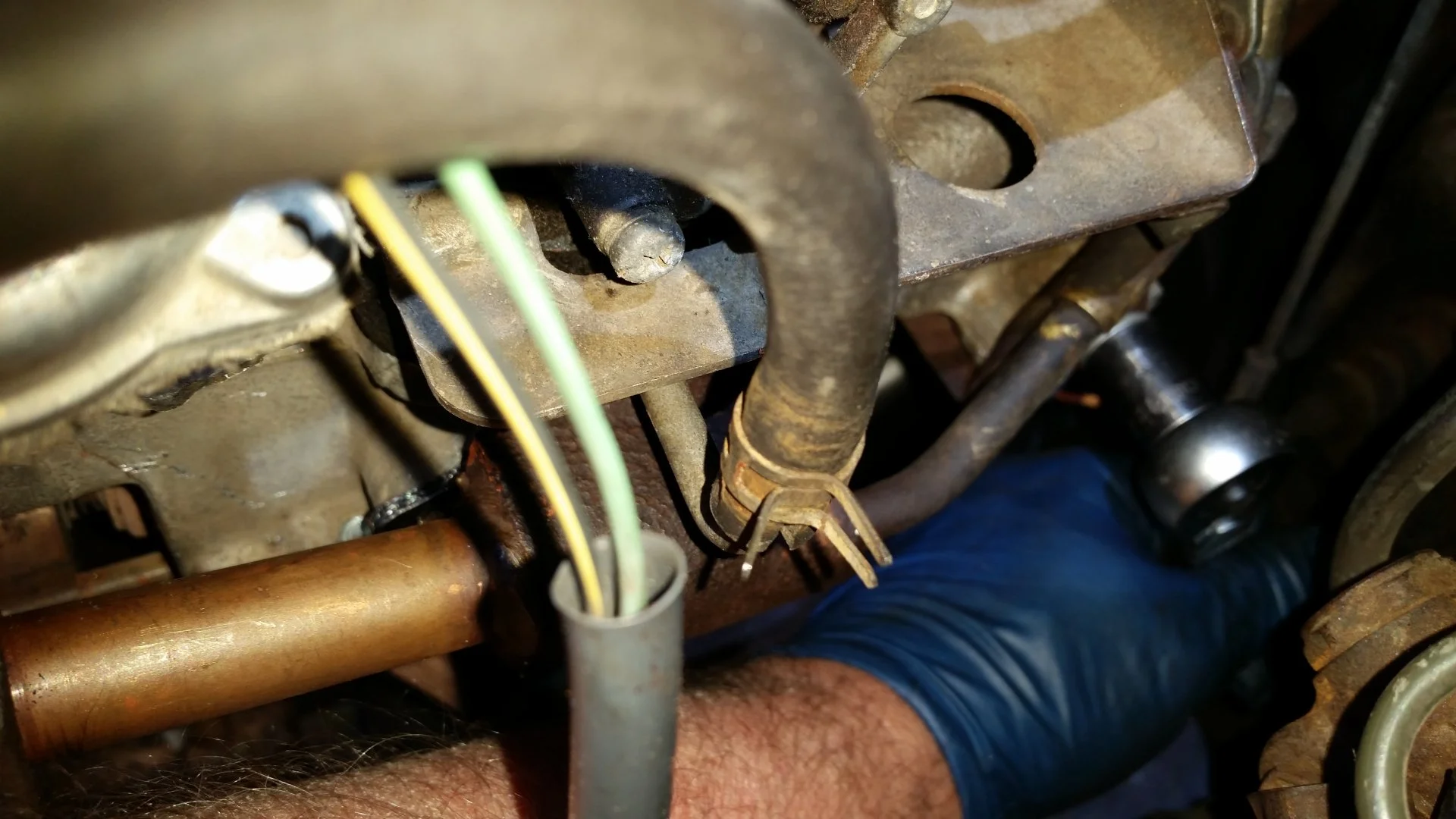

After some driving I noticed a pft, pft ,ppft sound. Almost like a ticking and sometimes sounds like a playing card clicking on the spokes of a bicycle. Put my hands around it and found a leak at the egr pipe inlet where it mounts to the exhaust manifold. I tried another gasket but when I went to put the nut on the inside stud it wasn't on straight and I didn't verify it. Easy to do when you have to reach way up in there and there is little room to move your hand to turn the nut plus it's pretty dark and my flashlight wasn't the best. Then I mistakenly tightened it down with socket and stacked extensions and totally stripped the stud. I ordered another stud and nut from SOR. Once they came in, I tackled removing the stripped stud. I was able to remove it with the manifold still on the truck. It wasn't easy but a few rounds of mapp gas torch and PB blaster and it started to turn. I replaced the stud and put another gasket and still the leak is there. It's in the belly between the studs where the flange is obviously no longer flat. Ordered the SS egr pipe from SOR. Gonna try this again. Unfortunately the egr cooler is gonna have to come off the truck and on a bench b/c there is no way to turn that big nut under the truck. No room and the exhaust pipe is right up next to it. My egr pipe is loose in the nut but even if I can get it out I'm pretty sure it will move the ferrule and then the new pipe is NOT going back in.
Is it just me or does anyone else hate "torque to fit" nuts. They are made oblong if you look inside the nut they're not round but oval. This to insure a "grab" when torqued down. These seem to be a one way ride. When I have tried to remove these in the past I have either stripped the stud or had the entire stud come out of the manifold. I'd much rather have a lock washer. Maybe I'm over torquing them?

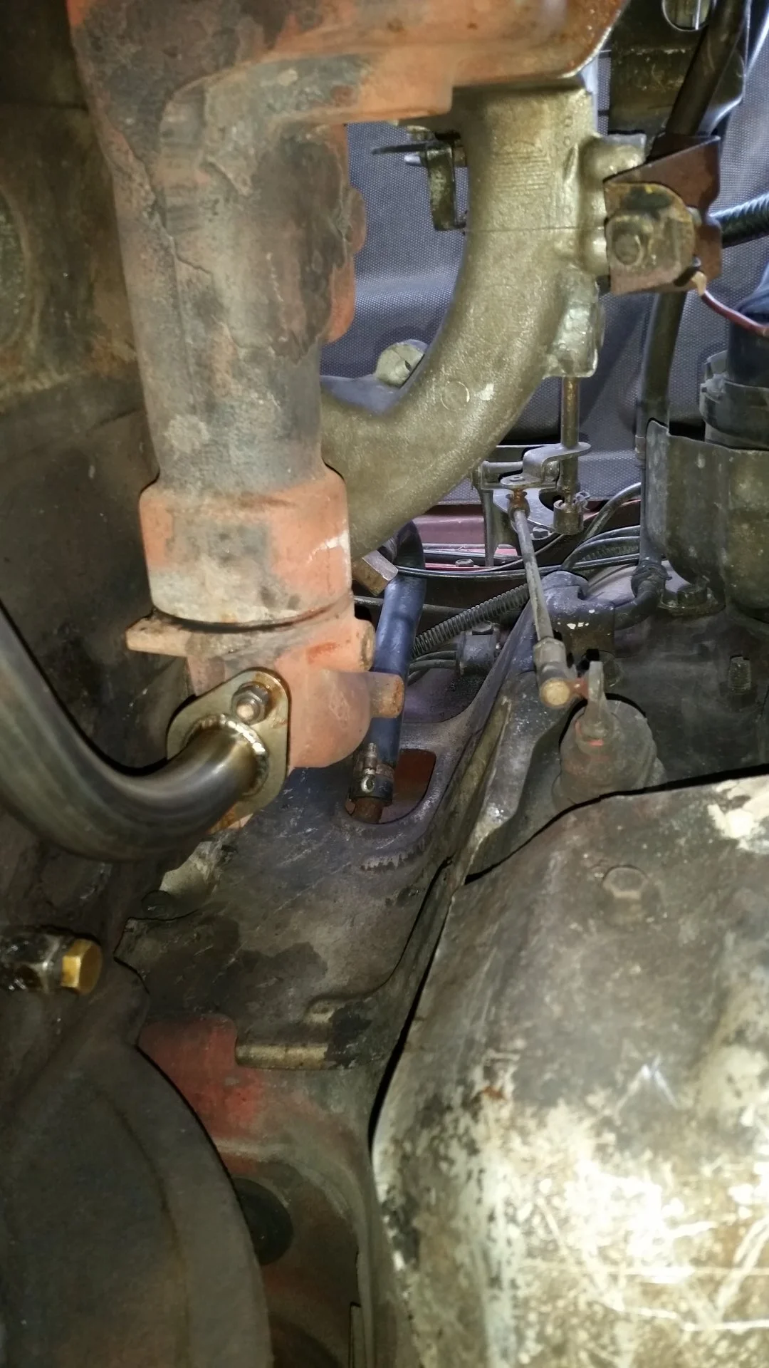

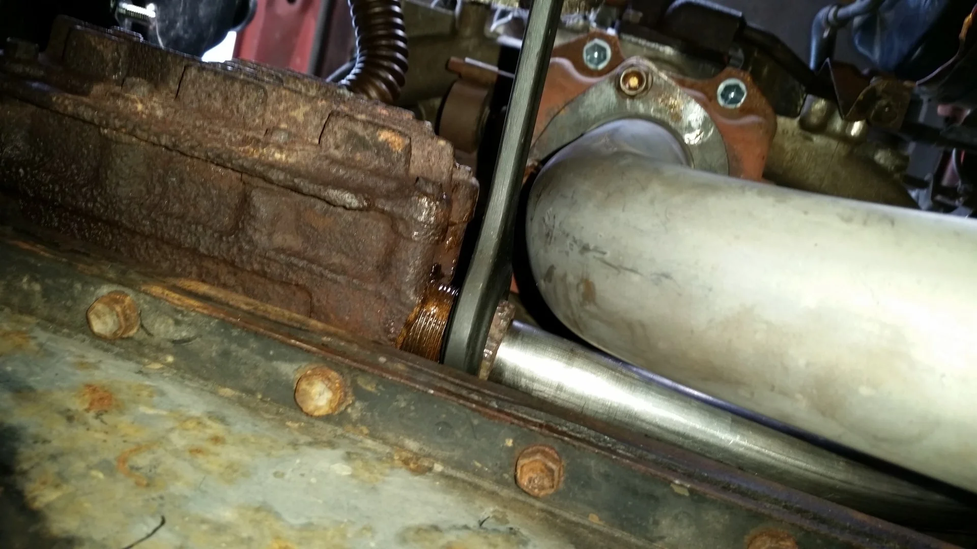

Finished up on the EGR pipe yesterday. What a drag. But newer EGR valve installed. New Stainless Steel EGR pipe from SOR. New EGR gaskets. And a new ferrule on the EGR pipe thanks to @CruiserTrash for the ferrule.

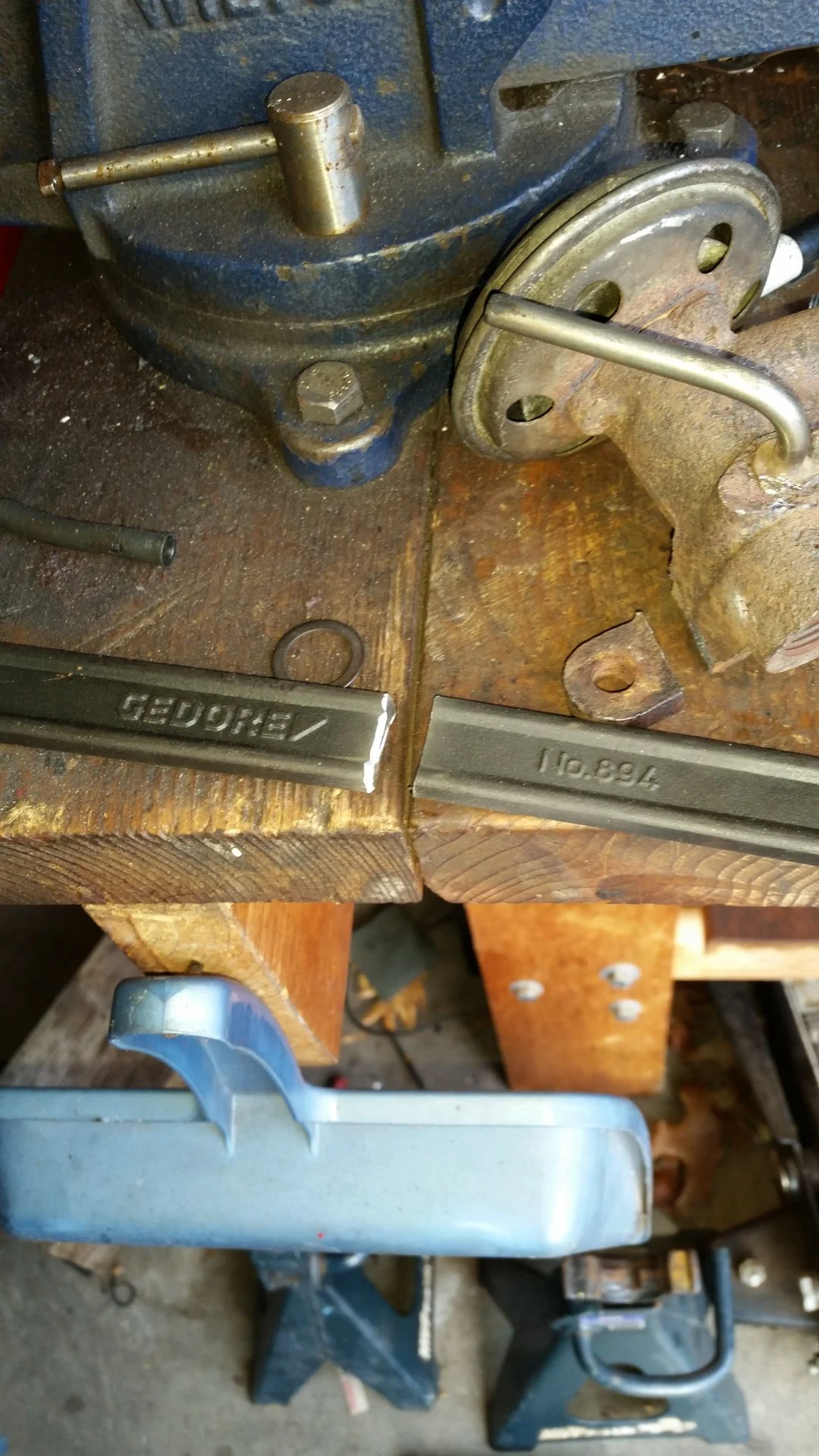

New Gedore 36mm wrench cut to fit...
This shows how much room there is to fit the wrench into position. Yes I did have to unbolt the exhaust pipe to get the EGR pipe to slip between the motor and the exhaust...ughh..

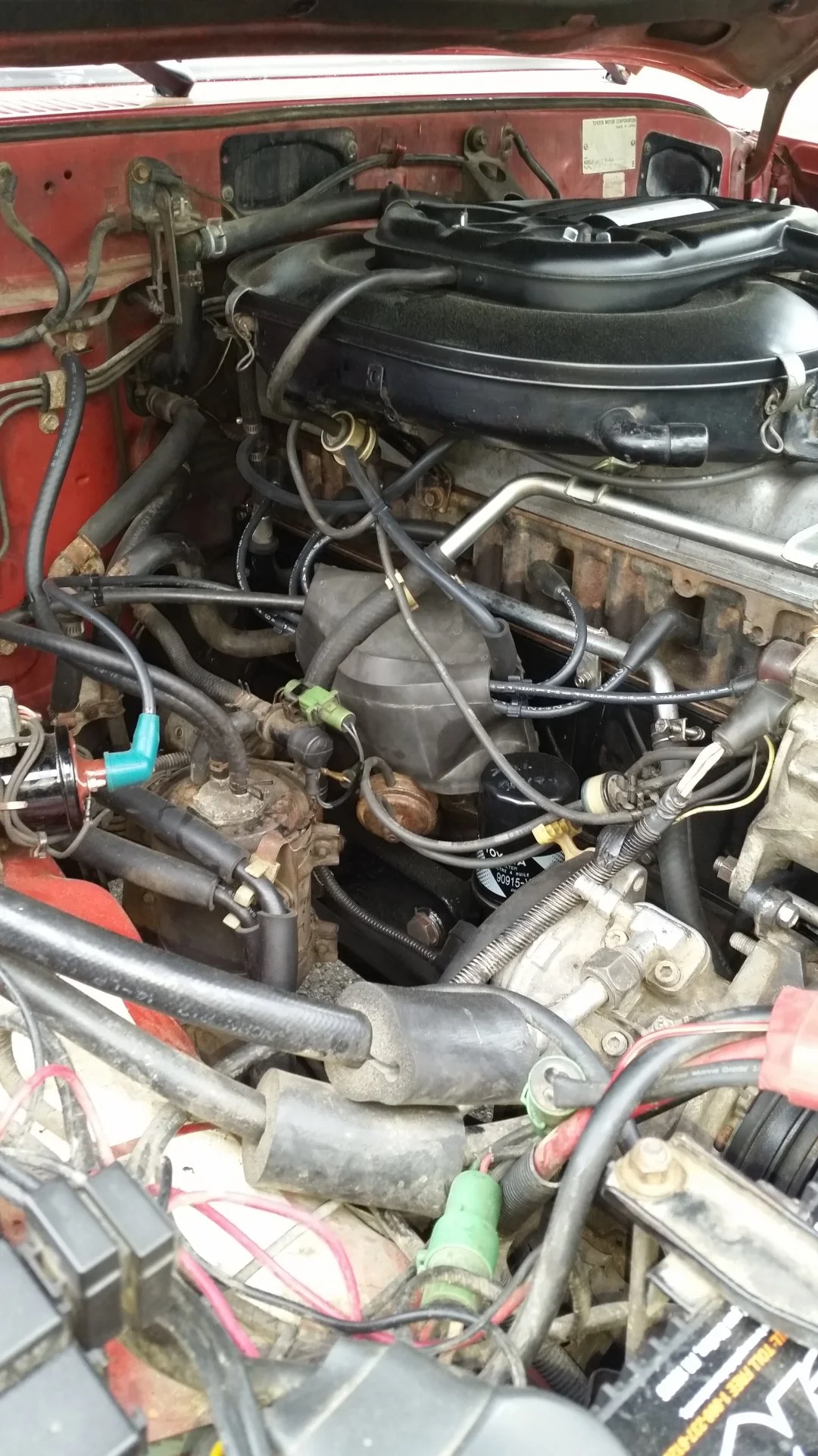

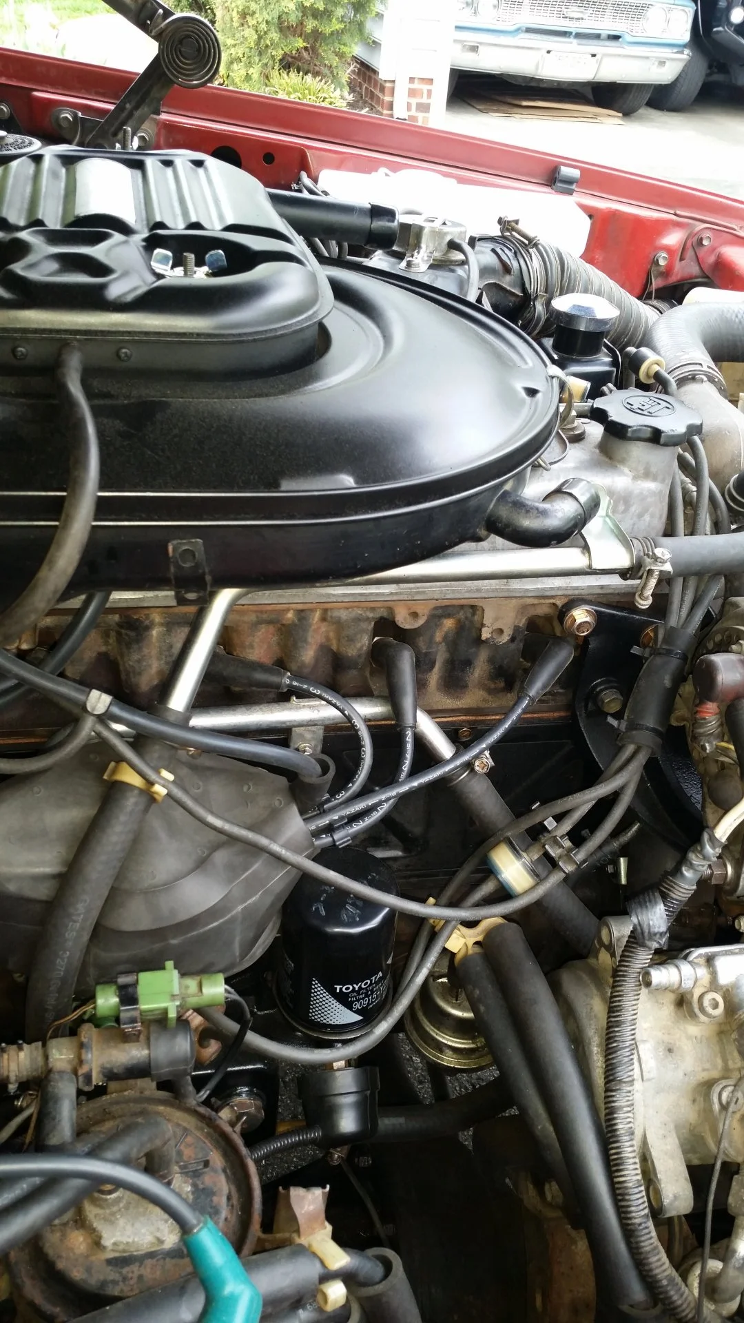

New side cover gasket installed. Sprayed some copper rtv on both sides to help adhere and reduce leaks. Replaced the oil cooler o rings and copper gaskets. Replaced the oil filter mount to block gasket. Painted the oil cooler, oil filter mount, alternator mount and the side cover. New plugs, wires, dizzy cap and coil. Got into the dizzy and greased the breaker plate bearings and replaced the stop pin bushing. Replaced the heater hose and piping for the oil cooler circuit and the heater lines that go across the side cover plate. Pictures really don't it justice for the amount of work. But, hey good news is that I have no more oil drips. (for now).
I cleaned the front timing cover and that shoe horned shape piece that comes down behind the crank pulley. There is a slight oil leak there. It's not dripping but a drip forms and so it still leaking slightly. I'll leave it for now but a new front seal, timing cover gasket etc will be in my future.

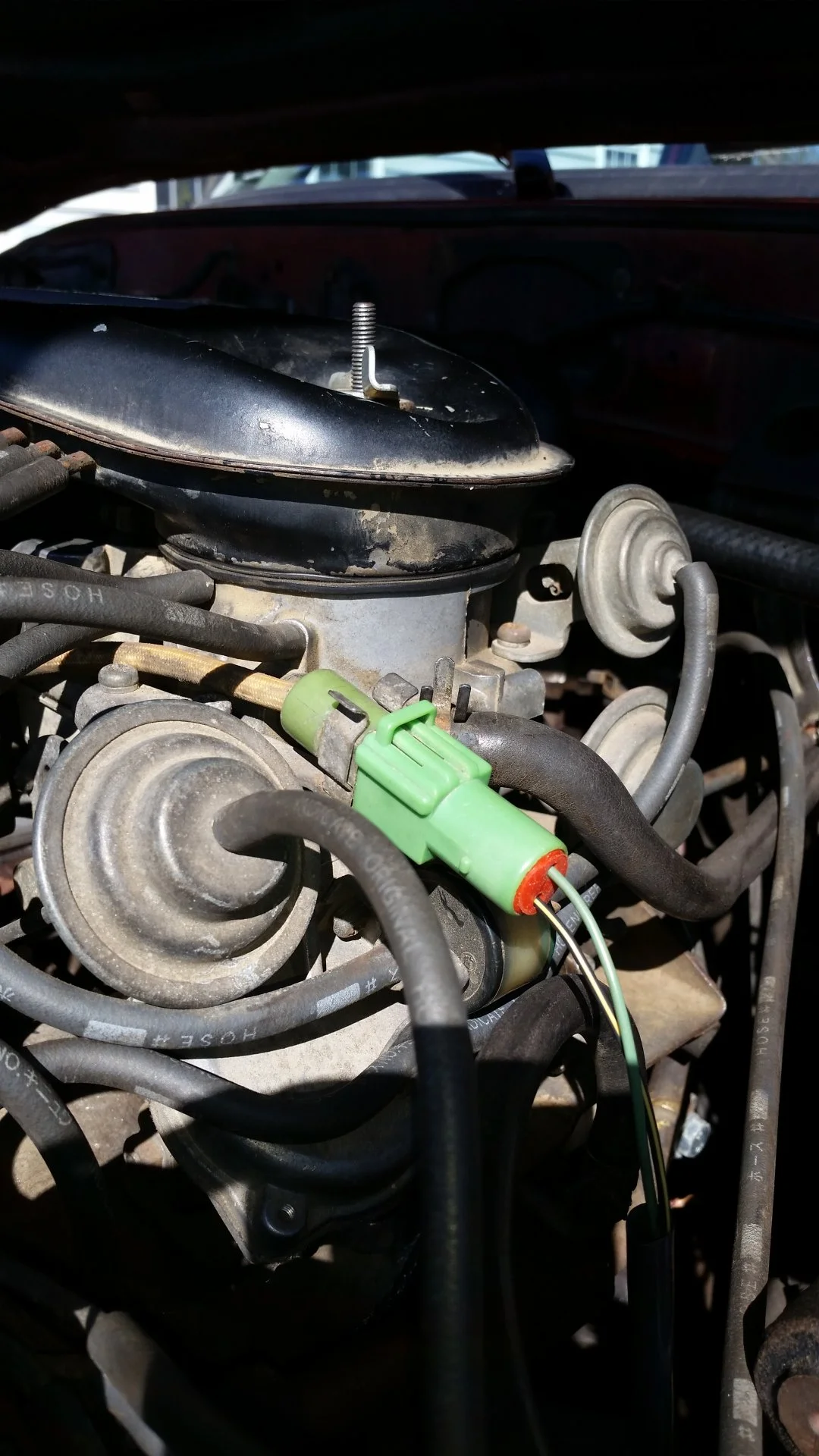

When I first put the dizzy back and tried to start it ...there was no fire! I was a bit nervous but a quick check and I realized that I forgot to plug in the signal generator wire. It was stabbed right and just needed a timing light to dial it.
