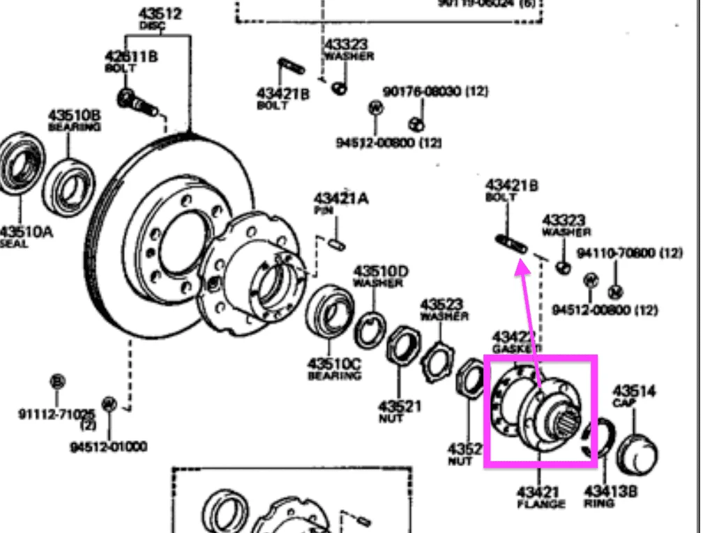

Update on the aforementioned squeaking:
It's worse than a u-joint I'm afraid... I only hear squeaks from time to time and only at low speeds. A little less than two months ago, I did a full knuckle rebuild on the DS due to my inner axle shaft seal failing horrendously. The rebuild came complete with new gaskets, knuckle bearings, inner and outer wheel bearings, seals, shims, the works (Marlin Crawler complete rebuild kit). I decided to jack up my DS front wheel to see if there was any play in the bearing, and there is... Which SUCKS. When I would grab the top and bottom of the tire and push/rock the wheel, it has a very small amount of play in it but there's still play... It's not too difficult to tear the hub down to make sure my axle nuts and washers are in place, but the stupid outer hub studs (male-to-male #43421B) that screw into the hub "flange" seem to keep cross-threading and breaking off and it makes the process awful.
I remember feeling uneasy about the way the rotor/wheel bearing assembly was seated on the spindle and I believe I may have overtightened my inner axle nut closest to the outer wheel bearing (#43521). I didn't have a wheel bearing nut socket so I followed the advice of many and used a common head screwdriver and a small soft-blow mallet to secure both the inner and outer axle shaft nuts. In addition to having possibly over-tightening the axle nuts, I also installed the washer backwards (#43510D -- the one goes between the outer wheel bearing and the inner axle nut). The washer has a groove on one side and I installed it with the groove facing the wrong way. I have read that the groove on the washer is an intentional OEM design but I've also read that the groove is actually the result of the bearing race cutting into the washer. What's the right answer?

I'm just blabbing now, but I know I'm going to need to stop at a hardware store to pick up some outer hub flange bolts and new nuts because they're going to get thrashed and I need to learn how to freaking properly preload my bearings because I believe that's my problem.
The groove in the washer is there because of the bearing grinding on it because the wheel bearings are too loose.
I frequently turn the washer around to change the wear surface against the bearing (clean side to bearing).
You NEED to buy a hub nut socket.
You need a torque wrench.
Torque the INNER nut to 45 LB-ft WHILE ROTATING
Back off the inner nut until finger tight
Re-torque the inner nut to 30 LB-FT
Slide on the star washer
Install the outer nut and tighten to 45 LB-FT.
Bend over the tabs on the star washer onto the flat of the nut, one tab in, one tab out.
Assemble the outer flange and snap ring.
Hopefully you have enough grease in between the bearings and packed into the bearings.
The outer flange hub studs will not be found at a local hardware store. buy them from Toyota if you NEED them. Don;t pound on those studs with a hammer unless it's brass.
