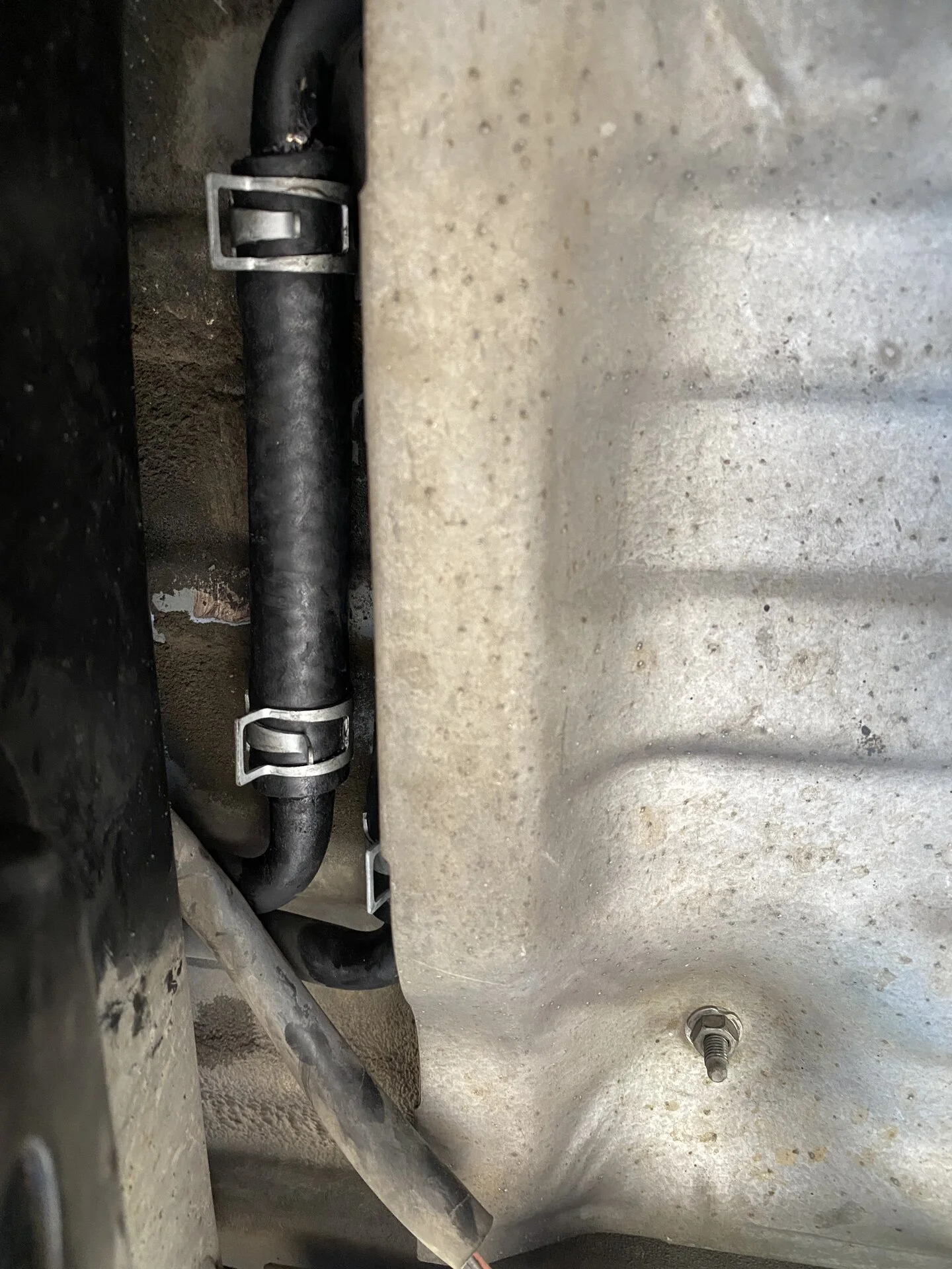

The hoses under the truck that connect to the heater hard lines will require 1/2" hoses and they are a TIGHT fit. You'll need to smear antifreeze inside them and on the tube before you shove them on.
You can replace the entire hard /soft lines on the LOWER section to the rear heater without removing the exhaust. I replaced mine because of rust, but you cannot replace the upper hard lines due to the transmission.
Replacing the two hoses on the side of the transmission will be a VERY difficult job. I highly recommend getting the Toyota spring clamp clamps rather than screw type hose clamps that fit the proper OD of your hose.

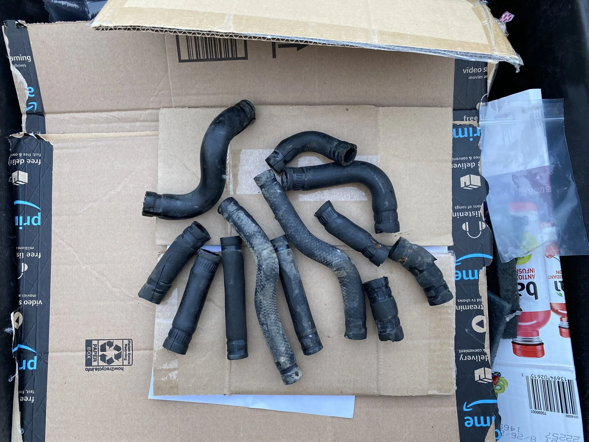

I replaced all of my heater hoses and lower hard lines. I ended up having to buy cheap O'Reilly's hoses and go soft line from the top down to the lower hard lines. It's a tight fit with complete soft lines but they can get there.

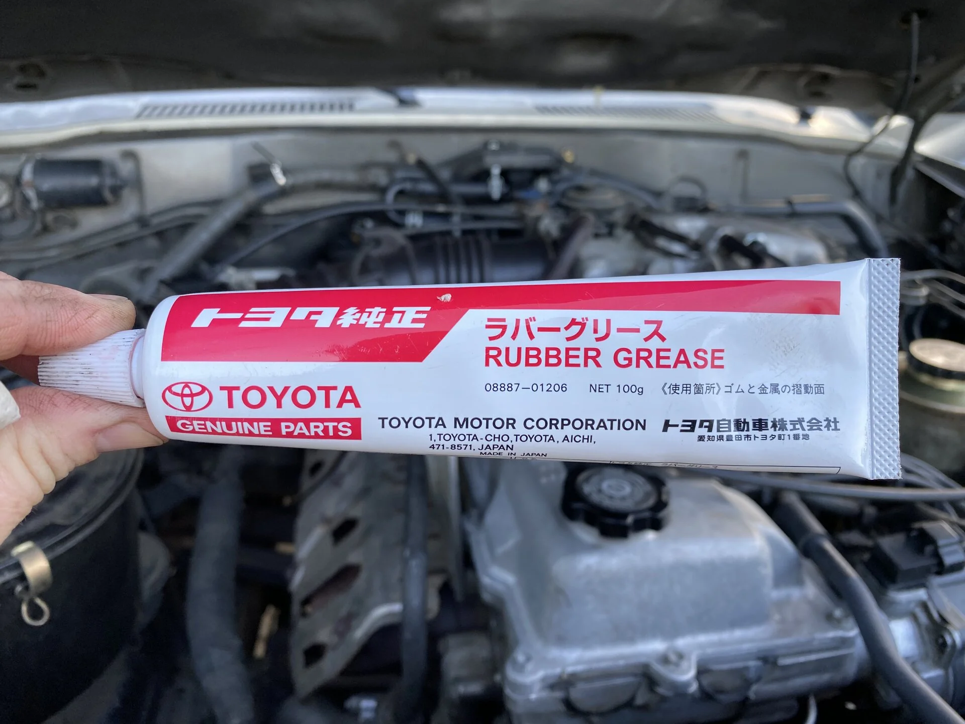

I'm a big fan of the Toyota rubber grease.

Since I believe that is a silicone base, I just try not to use anything in a system that it is not designed for. So, I would only use water based products in my cooling system. That's why I use antifreeze as a lubricant for hoses on the cooling system.
There are a few folks that disagree with me, but :meh:
I've been doing it this way for over 40 years on many makes of vehicles and no issues.
Its lithium soap base

I don't think my rig spent its whole life in CA. forget where it was from originally. my hard lines were looking rough and wanted to just avoid it before it corroded out and dumped my coolant. Was easy to just run all soft lines; took maybe an hour at most to do it?

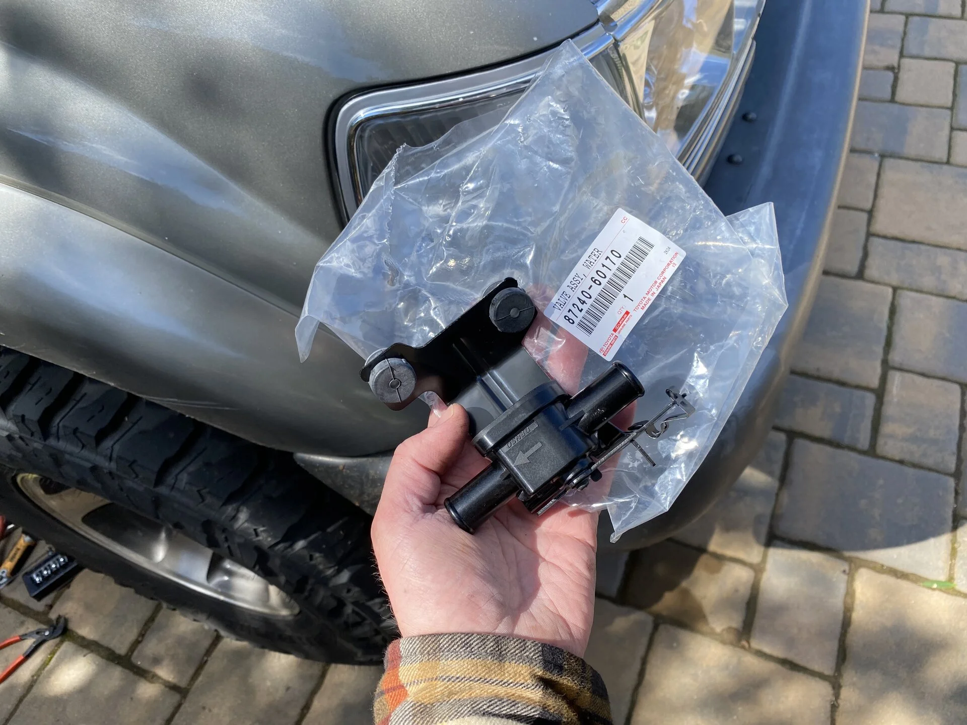

Picking up my 1/2" Gates Green Stripe today, special order off O-Riley's web page, I have the new heater hoses and control valve. I have the rear heater delete option available incase I get Bi@Ch Nutzzz wile I'm under there replacing the rear line heater lines. I'm definitely motivated to keep the rear heater now knowing that the rear heater operates independently of the front temp control. Can keep the truck warm without having heat blast in your face or you can have the front defrosters on cold and the rear heat can blast.

  • Rubber grease for the win!
  • Spring tool hook for removal of Toyota sardine can clamp
  • Unbolt the hardline above cats
  • Long handle long nose pliers are a must (straight / angled / 90deg
  • I just went with the standard gates heater tubing, the Greenstripe is too thick and you cant use the factory Toyota clamps (parts store was out of the breeze constants
Firewall sections can be a ba$tard
Great work; the lines at the bottom of the firewall are very difficult to access. My hat is off to you.
