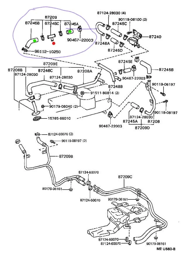

I believe rear heater hoses will work with 1/2" ID. Most other larger hoses are basically 5/8" ID. If you want to bypass rear heater, best way I know is to use 87245-60420 from heater valve to core and a strip of 5/8 as a return line from heater to metal line above the exhaust.

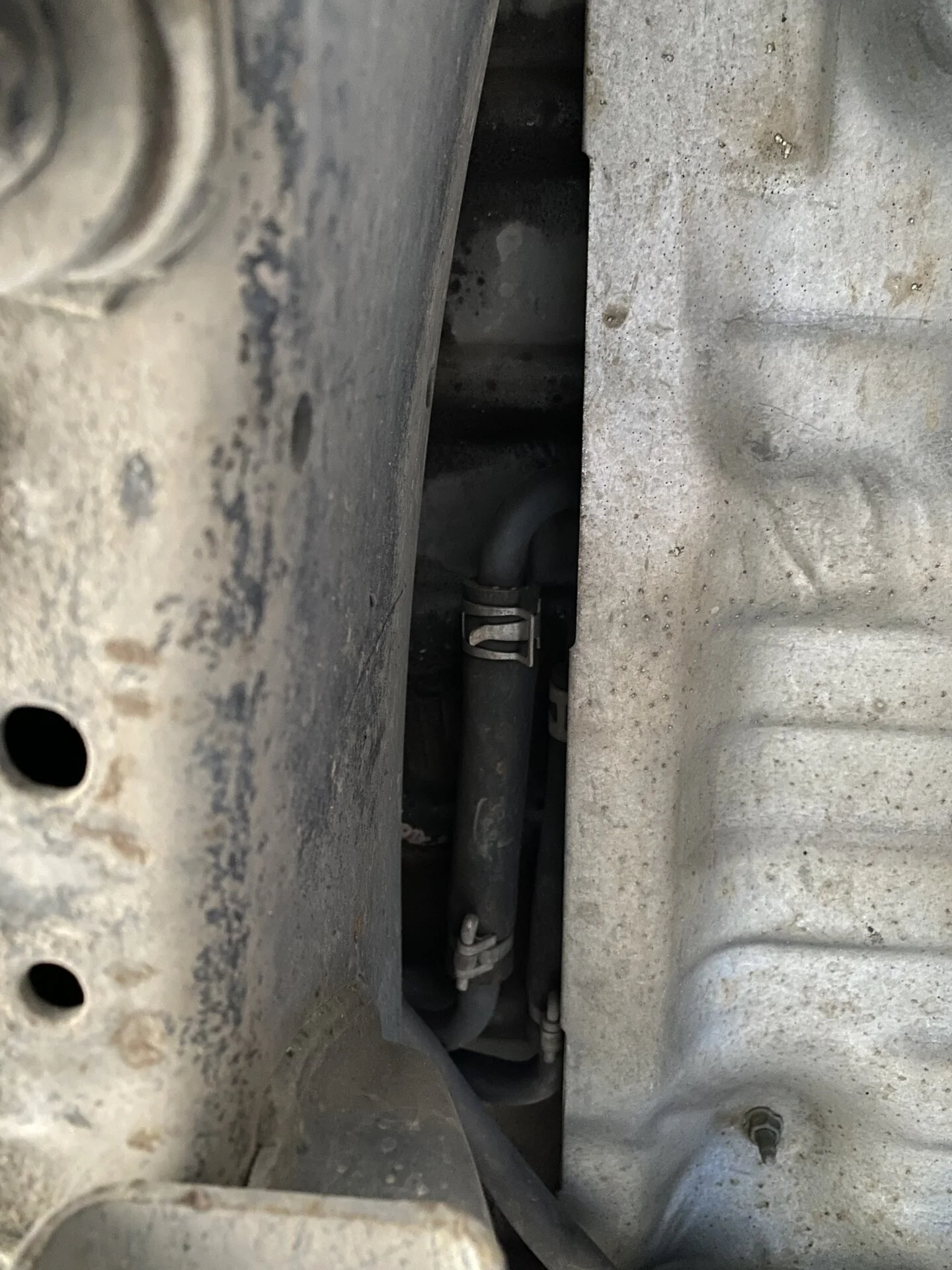

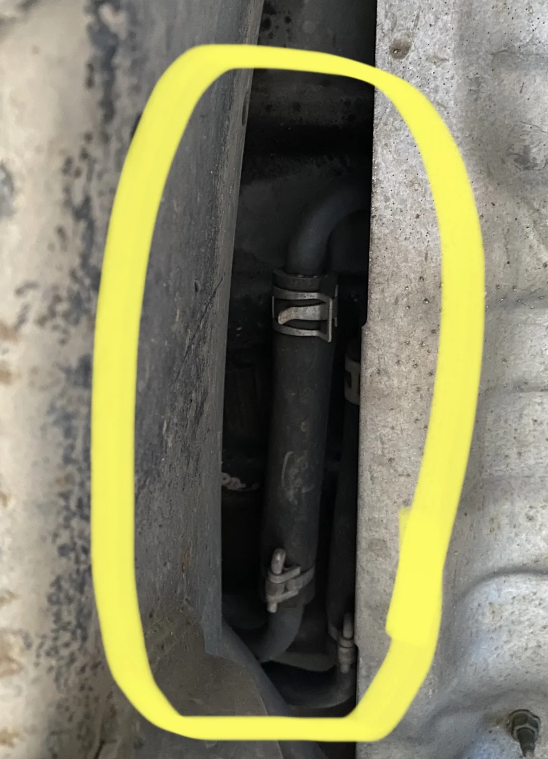

Strange my 97 only has the soft lines above the cats going up to connect to the rear heater core.
These are the soft lines correct? Or like u said they are further back

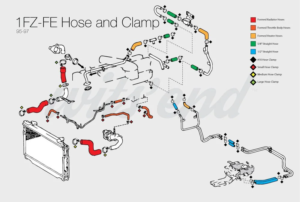

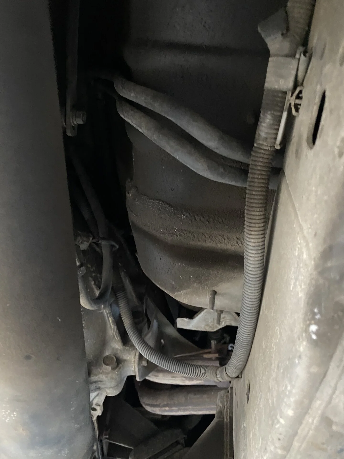

There are actually 4 lines hoses in the rear.
The top yellow ones split on either side of the head, then two in the middle re above the cats and the bottom yellow are above the TC.
