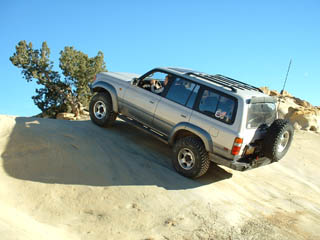

I vote for keeping the stock silver and going a little darker down low and on the flares like they did on some early FJ80s and later CEs.
<Beowulf's CE>
I do like this JDM color as well - more blue-gray ...
