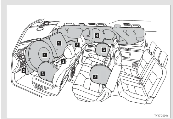

Highly unlikely you’d be able to keep the seat mounted airbag in an aftermarket seat.
Keeping full functionality of the remaining bags is one thing but I wouldn’t think the bag is easily transferred to another seat.

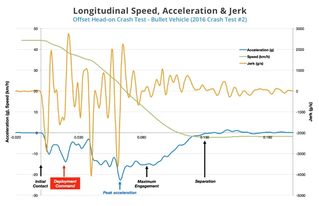

I wasn't thinking of airbags in the seats, but airbags from the other locations. I don't claim to be any kind of crash expert, but my understanding is that the timing and force of the steering wheel, knee, and side curtains are all critical to keeping you out of the fatal G-force zone. The chart below shows the timing of peak force to absorb is within a millisecond. And that's at a relatively slow 45 kph.
I get that you'd be giving up some degree of safety in a side impact, I just don't feel there's clear data on the potential changes to the others. For example, to what degree does driver's seat position play? Is there any input into driver weight from the seat pad?
At any rate, I think this has answered my own question that there probably isn't sufficient data out there to indicate the degree of performance.

One problem I see with giving up just the seat bolster airbag is everything in any SRS is designed to work as a whole system. The side curtains don’t need to go down as far to protect the occupant when there are side bolster bags, for instance. Get rid of those and you may not do as well in a side impact as a vehicle that didn’t have the bolsters but did have curtains. @OregonLC point about milliseconds mattering does a great job of highlighting the nuances in these systems.
