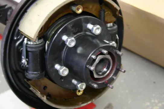

40 series FF. Non parking brake.
8 bolts. It has the seal in a nut on the hub end.
I'll measure flange to flange for you tomorrow afternoon if you still need.
Dan

I'll measure this afternoon. The brakes look identical front and rear to me. In fact, I robbed a drum off of the front axle (swapping to discs) for that rear FF. Basically, the wheel bearings and everything interchange, but the oil seal in the rear on mine is inside that nut.
The whole assembly is NOT available from Toyota, but I got the actual oil seal (which just presses into the nut itself) from SOR. I saw a Toyota part number listed for it on here somewhere though.
