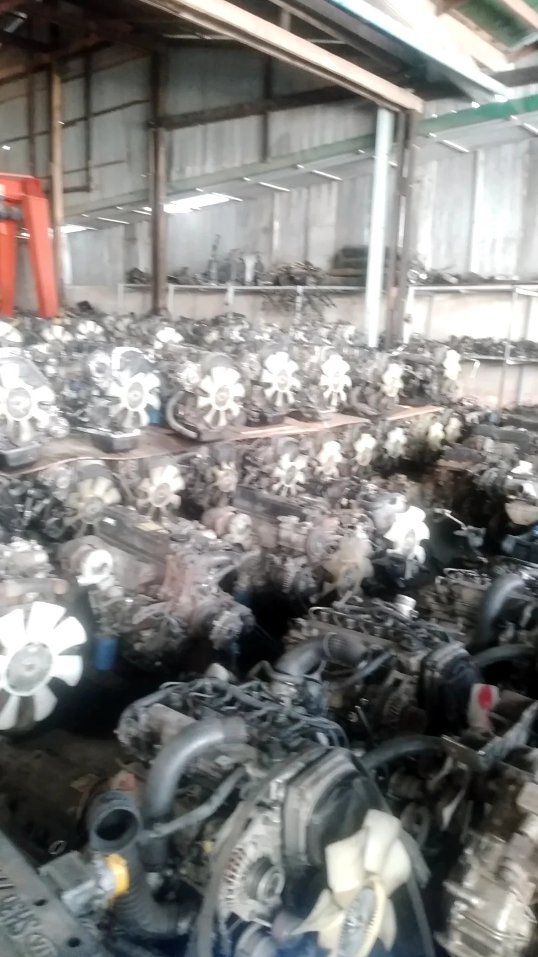

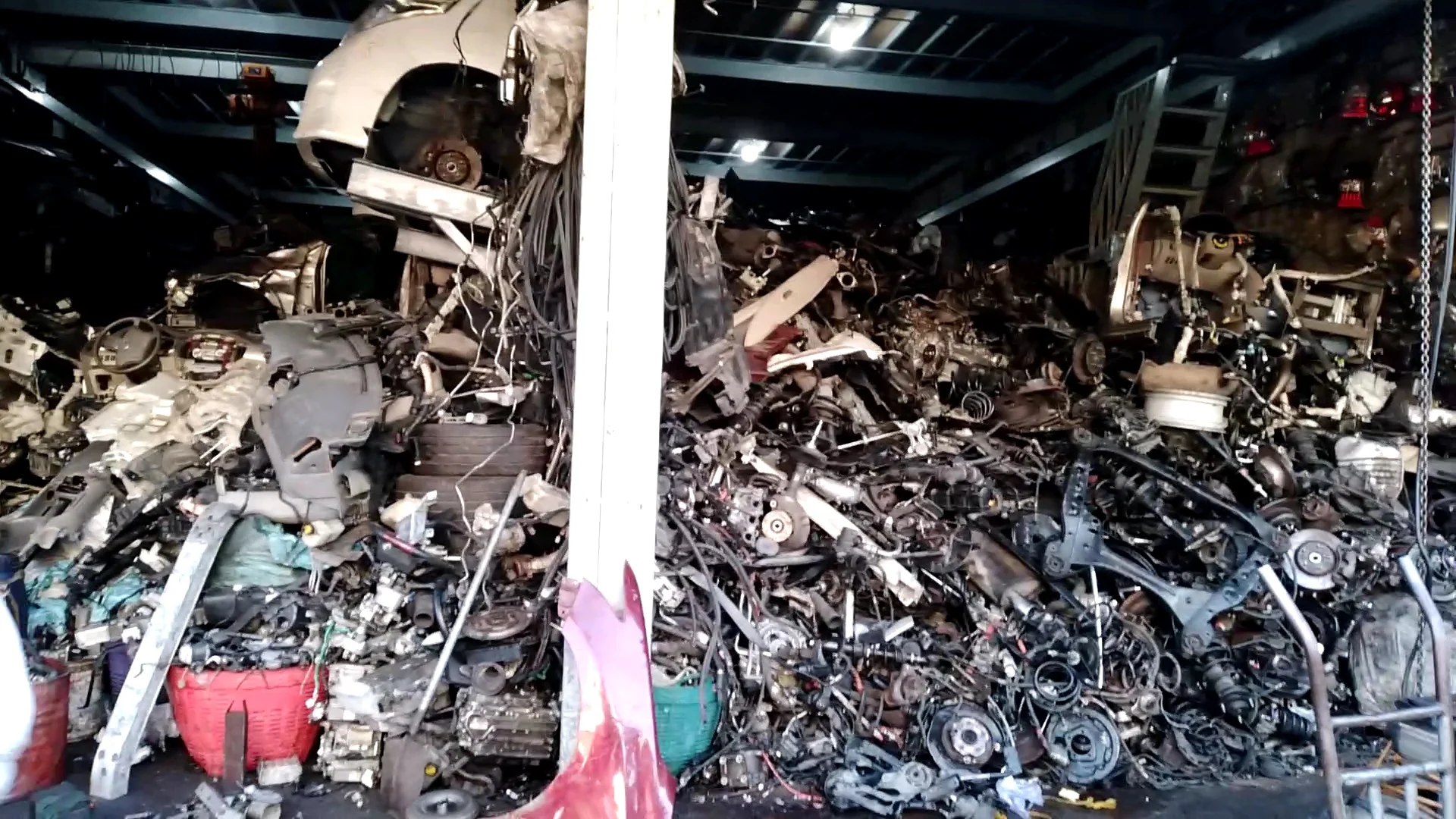

I like the 80 because there is 1000's and 1000's here gas or diesel and axles of all types available. Most better organised then in the attachment photos .

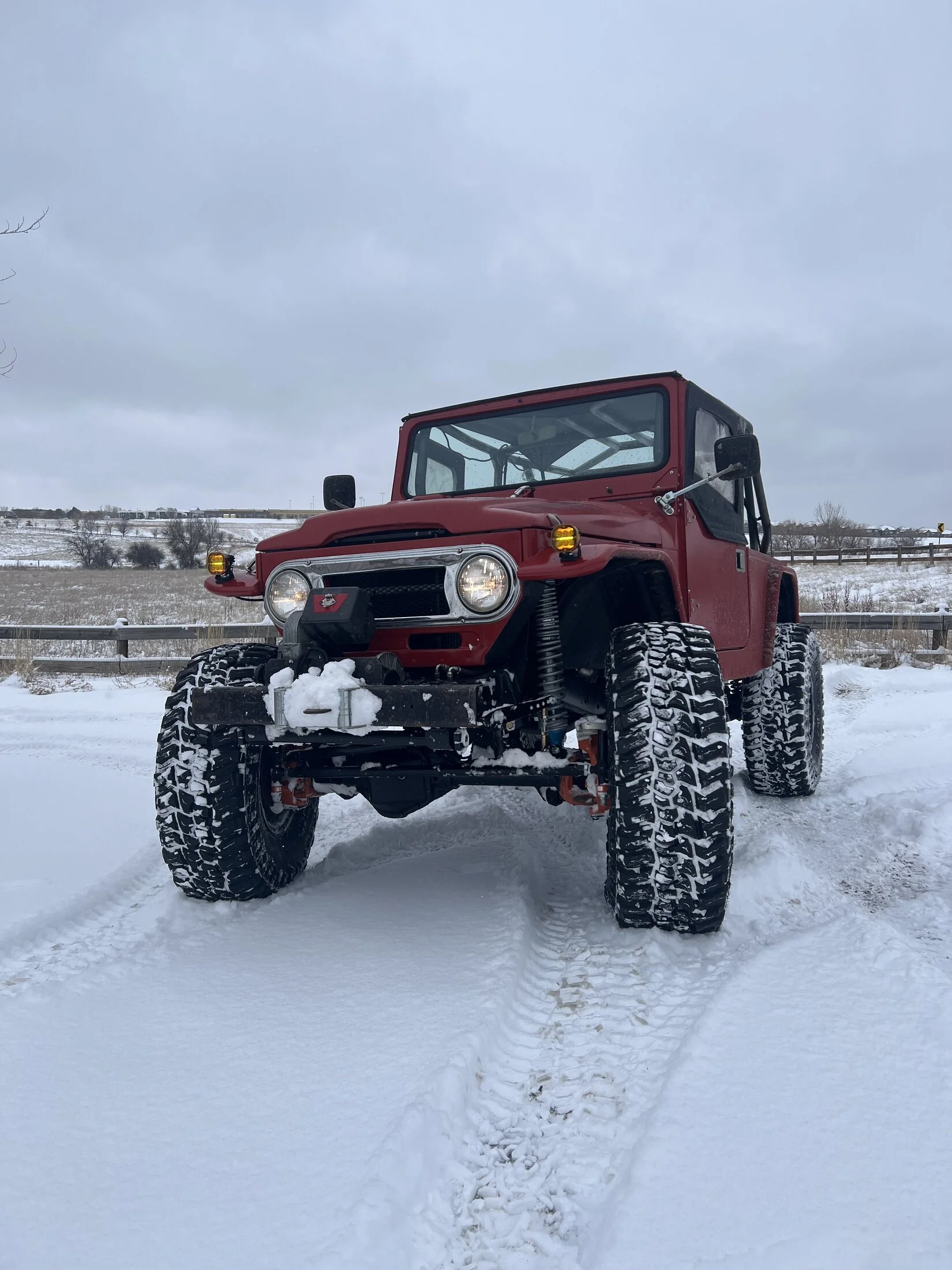

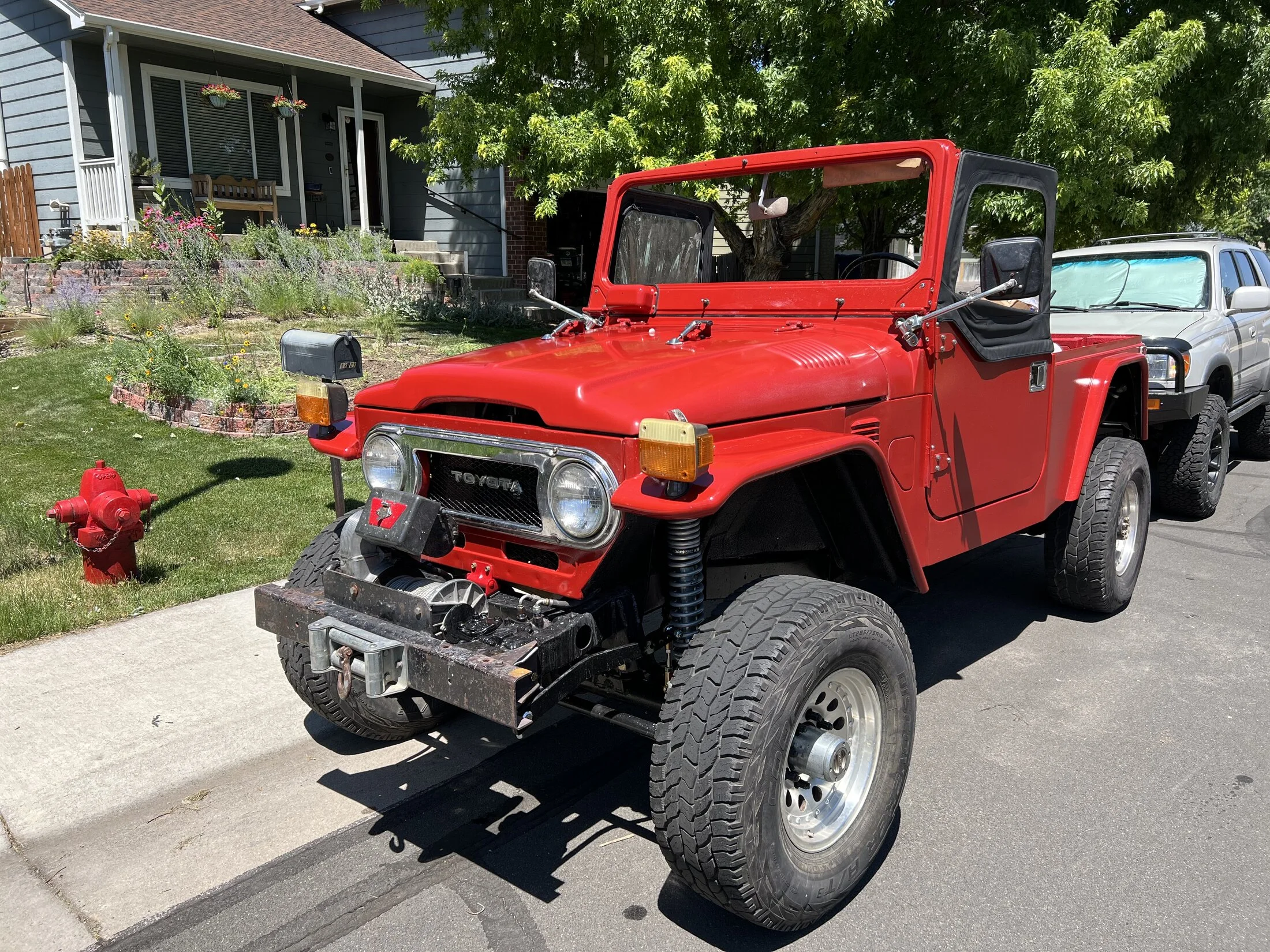

This probably won’t help much because this Cruiser is fairly modified, but it has a 63” WMS stance, which is similar to the later 80 series. My front fenders are narrowed and the tires are 14” wide. The tires just barely extend outside of the fenders with the 285/75R16 tire on 4.5” backspace.

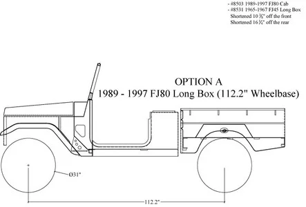

I do like what I see at Aqualvs they make a cowl and cab and box that fits a 80 frame.
I've emailed them to check shipping and costs. It's going to be stupid expensive . But the trade off forthe cost of living here makes up for being able to do this project.
And the used parts dealers is unbelievable here they got it all like $1500. diesel Landcruiser engines . You name it ,its here.

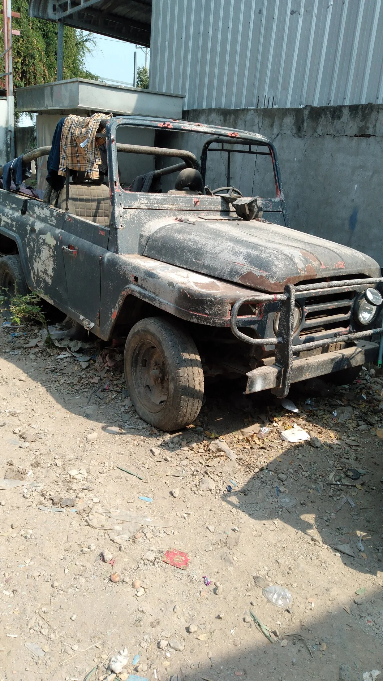

Pic BJ212 diesel future maybe project.

Parts ,body parts is not so bad on importing. There is every imaginable type of 4x4 here . Lada neva from Russia , BJ212 china , 72 vw beetles with Toyota front wheel drive swaped in the front , lots old military willes ,jeeps but most converted to 2 wheel drive with diesel or gas Toyota engine/trans.
Most older no longer driving 4x4 are parked at someone's house or shop out back. They may have 3 or 4 , but a junk yard with dozens or hundreds of wrecked cars in not common.
Streets lined with 30 or 40 shops selling every used part you could ever use there's lots of them.
Some USA gasoline 450 or fzj80 been shaped out with 1KZ 4cyl Diesel. It quite a bit shorter then the 6 gas or diesel. And they seem to do ok in 80 series.
With the body swap 40 to 80 they say you have to move the engine back 10" but maybe with the turbo 4cyl 1kz it may not need to be moved saving lots of work and new drive shafts.
