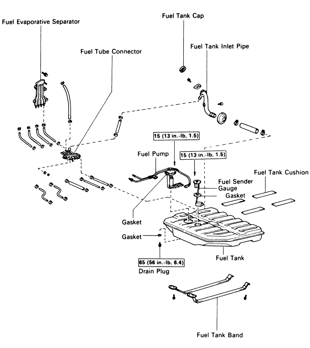

What year is the 61 series landcruiser diesel with a 200L tank?, The gas tanks on all Toyota trucks are mounted basically the same.
Exploded view of the fuel tank components-1989-91 Land Cruiser
Source https://www.justanswer.com/classic-cars/3dtro-fj-62-landcruiser-petrol-hands.html

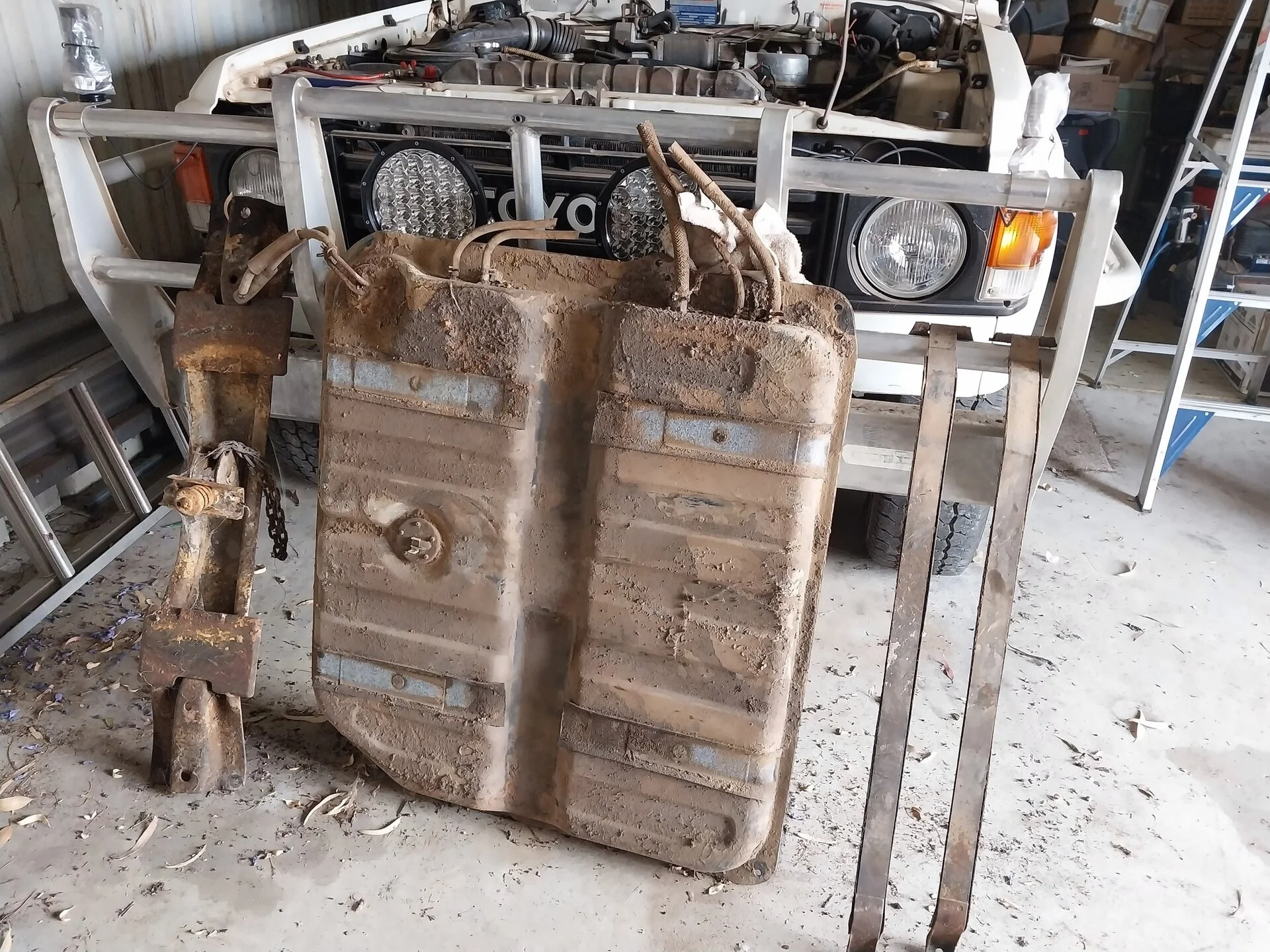

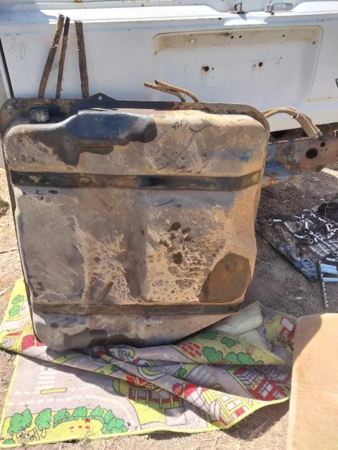

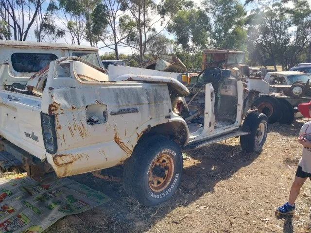

Gee's what a day sofar, head out early to pull this Fuel Tank out for my 4x4, not much left of the old Sahara but we got it done, we had a Ball, hard work thou.
here a few photo's of what we seen out there
