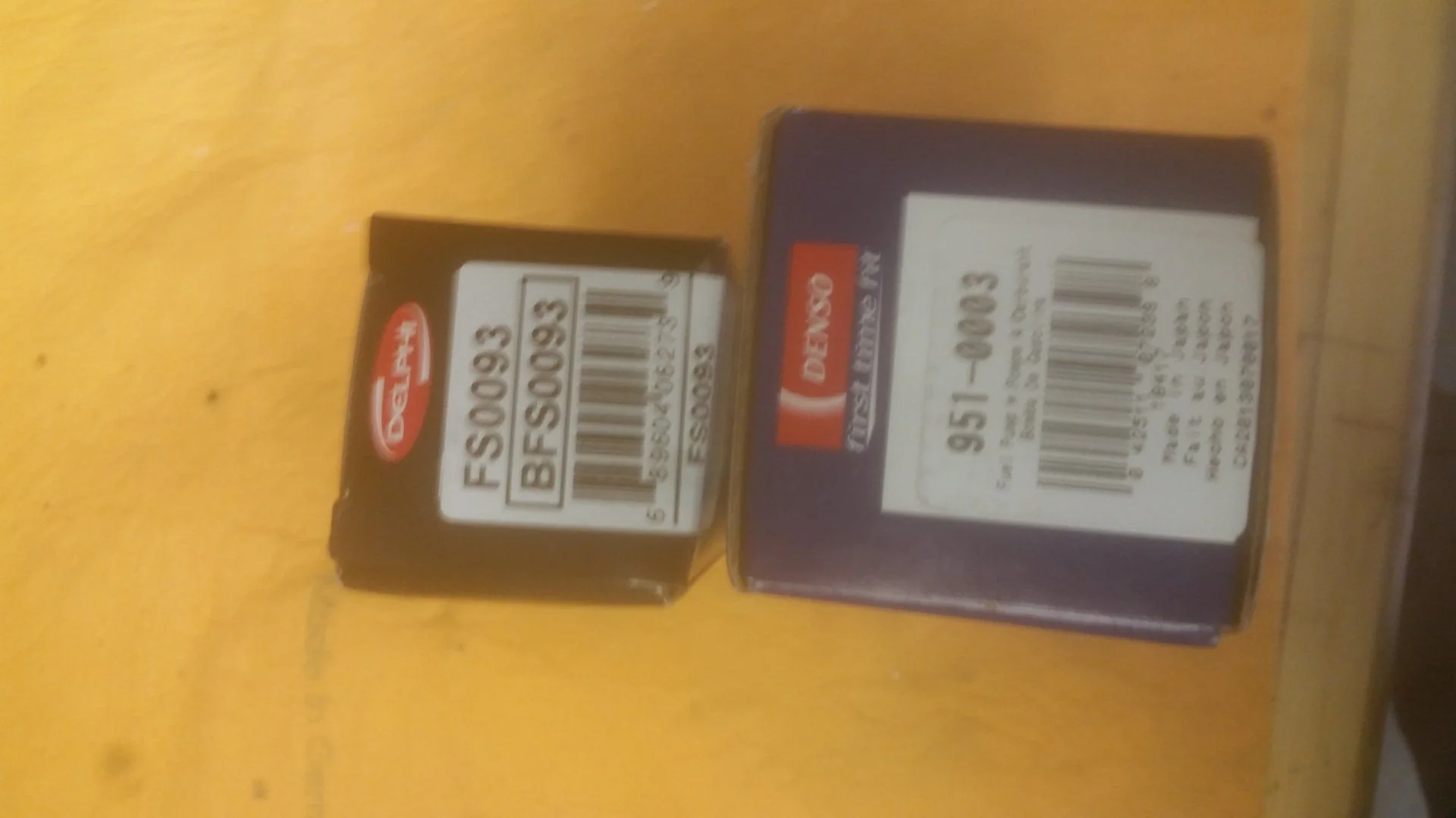

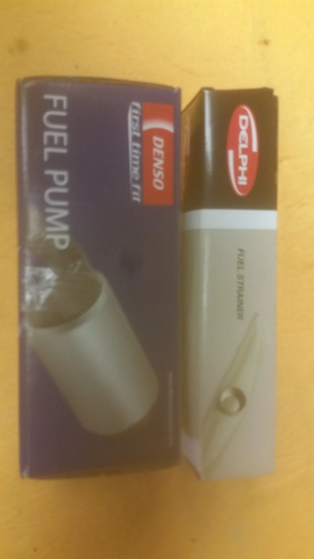

I am showing a rebuilt starter for (280-0233). As for the fuel pump and screen (filter), depending on who you ask the OEM pump parts are either Denso or Delphi. I have seen pics of boxes coming straight from the dealer parts counter with either Delphi (USA made) or Denso (Japan) inside the box. I called the local dealership in Culver City and I was told that if I ordered from them I could get either one. They would not promise either one. Although the lady said that most would be Denso (initially she did dot want to give me any info, but I called three times and she wanted me to leave her alone). So I just ordered these:
Denso Pump
Delphi Strainer/Filter
Together I only spent about $150. Dealer would have been nearly $400. I will examine the parts closely and take note of any differences in quality or appearance for you.

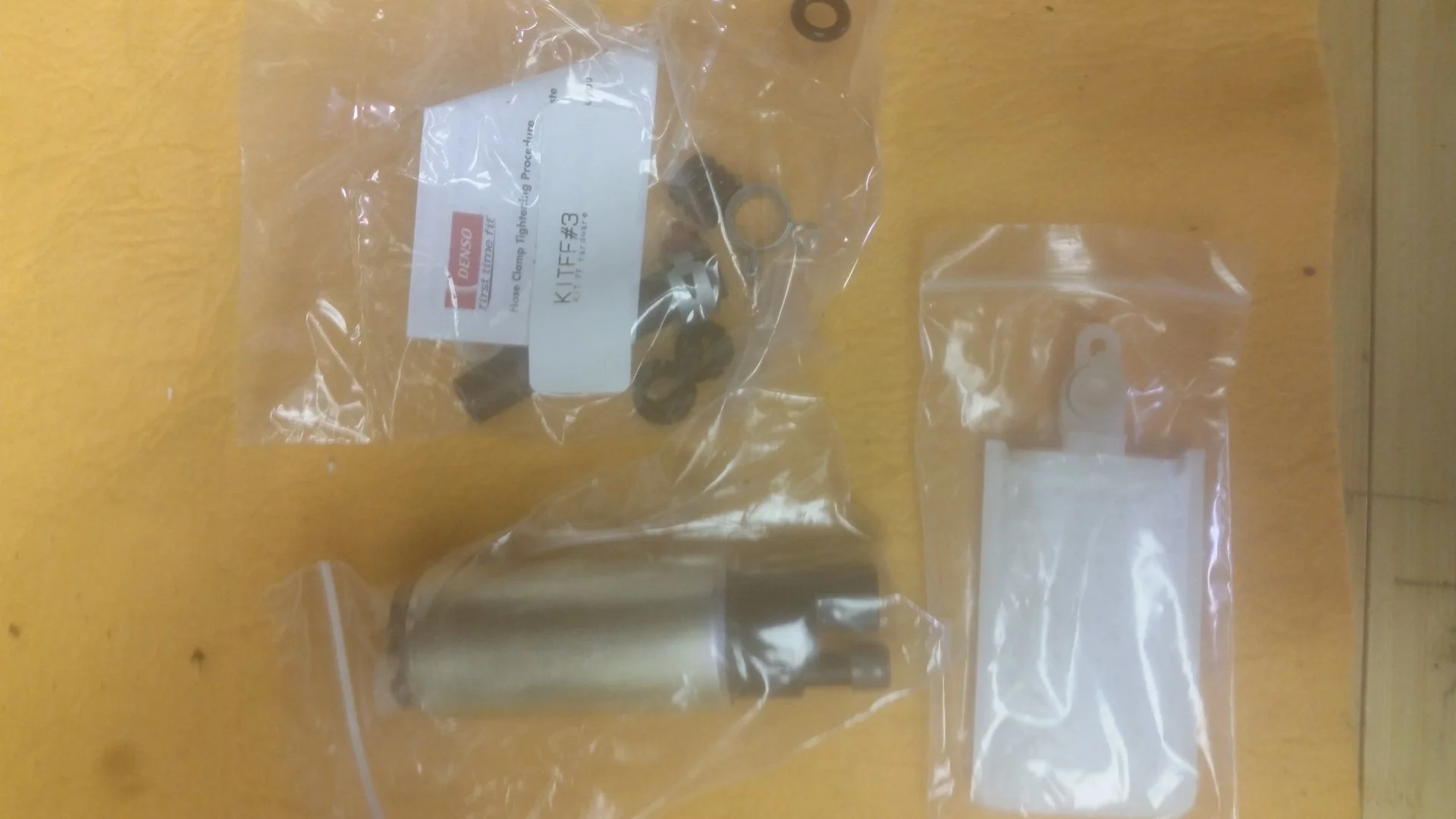

Meanwhile I got these today ( both appear to be high quality):
I will have these installed tonight for sure. I have a lot of practice with fuel pumps from tuning my 335i (N54), with a fair amount of custom installation. This should be a breeze.
All done! Started up first try. About a 120 minute round trip. At first I thought the new pump was non operational because it was so quiet. Not that the original was noisy, but the new one was not even slightly audible.
The OEM pump felt a little lighter than the replacement. Also the metal casting for the case on the original appeared goldish in color like brass? And you may have noticed in the pic that the replacement had a taller plastic end cap and slightly shorter overall pump portion vs the original, even though the overall length was the same.
