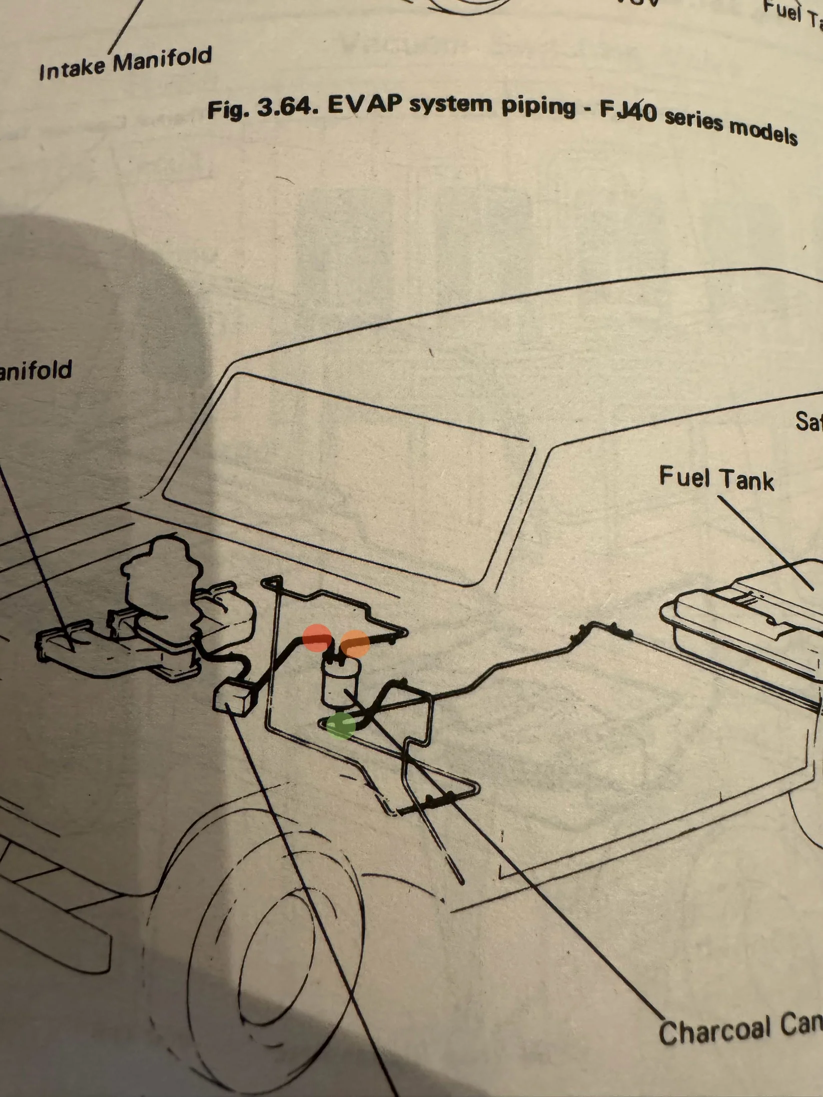

So Ive got a problem Im trying to pinpoint.
The truck starts great, and idles fine. After letting it idle a bit, I’ll go for a drive and initially runs great and pulls strong through all three gears. But then it seems as if when everything starts to warm up it will start popping loudly and bogging and hesitating, almost stalling.
I pull over and checked the sight glass but it seemed ok? Maybe a bit low.
When i give it wot in neutral she purrs along just fine and strong, I can rev it for days, but when moving along it starts giving issues…again this is after everything is sort of warmed up.
The weirdest thing is Ive been driving this thing around trying to troubleshoot so I know Ive used quite a bit of gas, but I opened the fuel cap and saw that the fuel is almost to the top!
I pulled and blew into the charcoal canister house that goes towards the tank, everything is ok. (Orange)
The other top hose goes to the vsv but that one is completely blocked, not sure if its solenoid activated.(Red)
The bottom hose i havent checked yet…(Green)
Anyone know if those two issues are related? (The bogging/popping and the gas tank which seems to have some sort of back pressure)..
The tank did not release any pressure when I opened the gas cap...
Any advice is appreciated.

I am not so sure that is the fuel level you are seeing in your picture.
Good idea checking the pressure in the tank, you don't want a lot of positive, or negative pressure in your tank.
The charcoal canister ideally should be receiving vapors from your tank when the fuel gets warm. The solenoid is designed to allow engine vacuum to purge the vapors in the can under conditions where the engine won't bog when those vapors hit. The green line is a vent so that engine vacuum can purge the can w/o creating a vacuum on the can. Make sense?

Even though a new filter helped a ton, I am basically running through all this over the weekend in prep. for the oem filter. I actually really appreciate all the suggestions and tips. Had never even heard of spraying carb cleaner around the carb to check for a vac leak!
Honestly not sure what the carb is, pretty sure its original two-barrel...whatever that is.
In the picture, the fuel was definitely visible, but actually I believe that I was misjudging the amount of fuel I may have had in the tank. I am still not quite sure though. I intend on doing that fuel system flush, but was also thinking of just going ahead and doing a charcoal canister rebuild just in case. I noticed a bit of gassy fumes last drive and it made me wonder.
