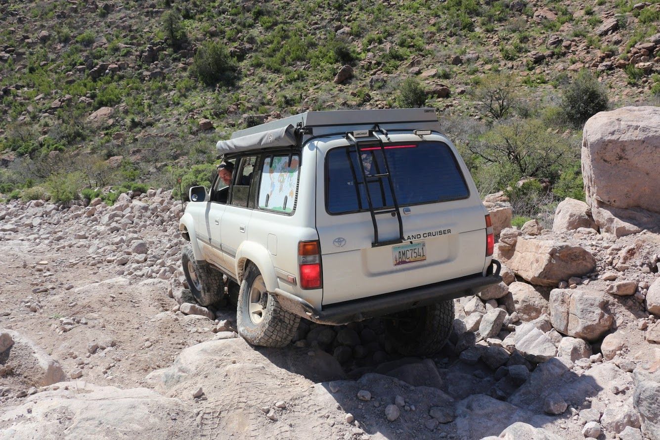

What you are missing out on :D
Wheels on the ground = better traction and safer wheeling
No need to disconnect on every trail but when you need it you are very happy you can disconnect.

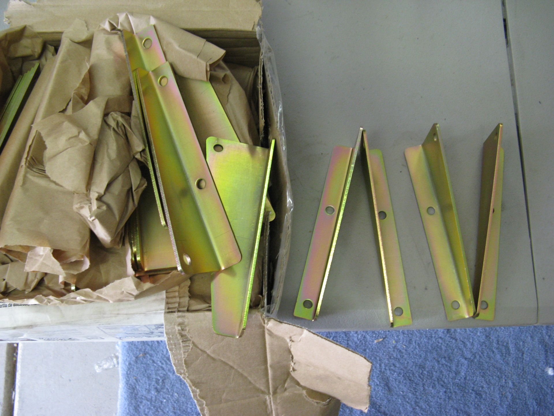

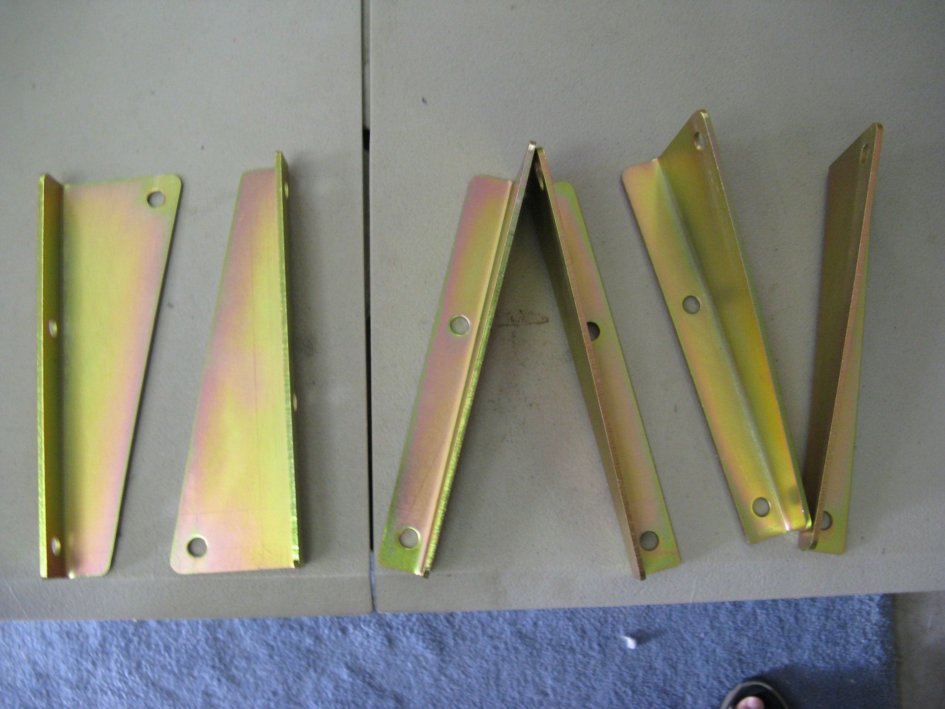

When she picked up the next 100 swaybar disconnect brackets she found out they were not finished and she was not going to paint them. Talking with the manufacturer they up graded the finish to zink coating.:eek: Looks like we have Gen II+ now going forward with a lifelong nice gold finish:D
Let me know if there is interest in current owners upgrading to a zink finished bracket.
