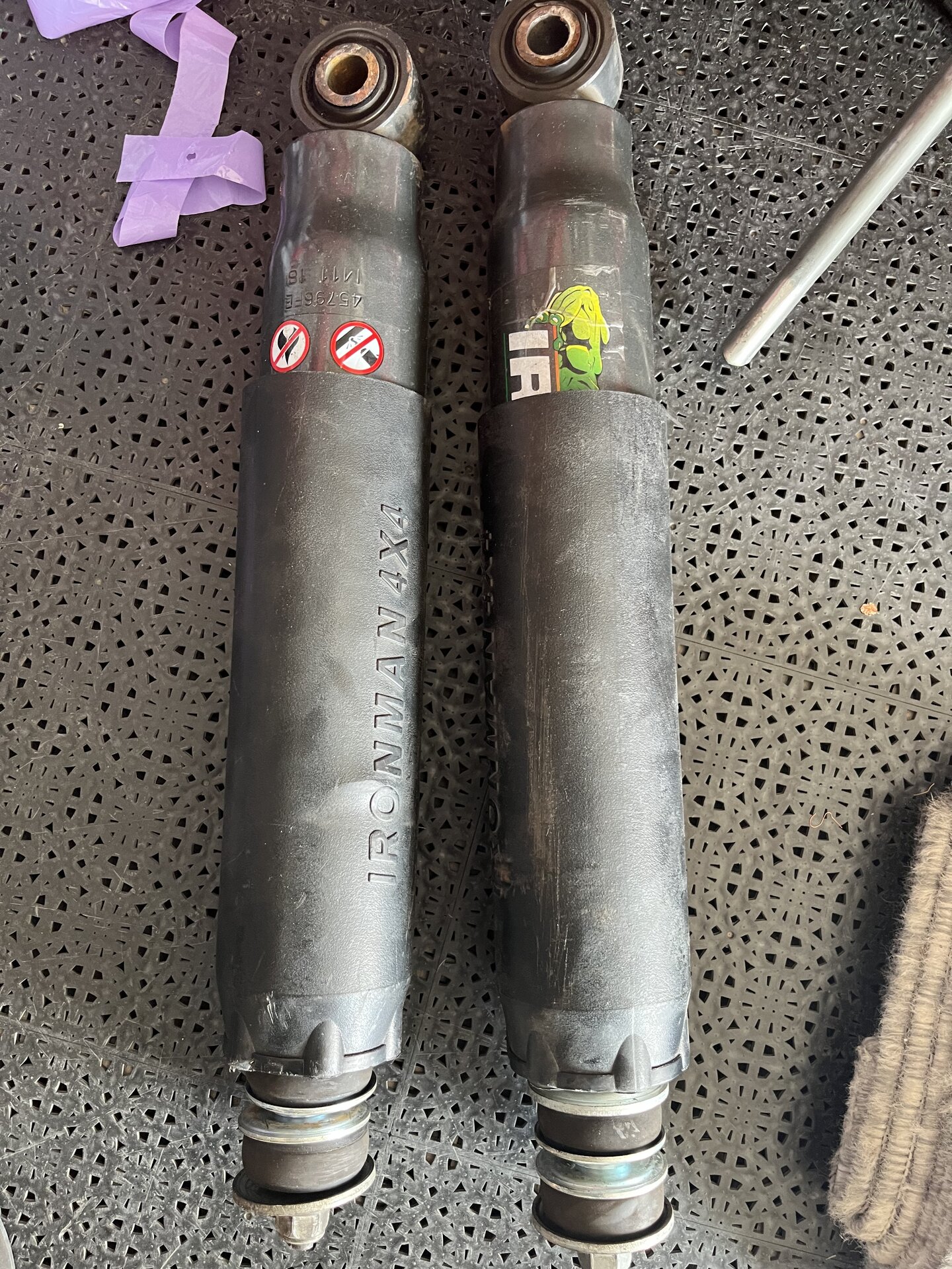

Update finally. For 20.5-21 hub to fender measurements my foamcell pros were only enabling like .5-1” of downtravel. Put on oems and the truck rides like a dream. Little bit more lateral roll then I want but hopefully front bumpstops and spacers stabilizes that a bit
Btw, have a full set of ironman fcp’s with 15k on the fronts and brand new just installed rears (less than 200 miles). Will sell for cheap. HMU with an offer
Update: I decided to keep the fcp rears in. I have a front set of fcp’s with less than 20k miles on em for 60$ plus shipping. It’s a get em out my garage special…hopefully:)
