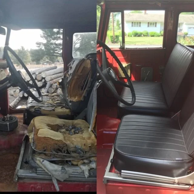

My vote is for original seats. I like them in my 1970 40. They were rough when I got them but I used the SOR foam and covers.
before and after:

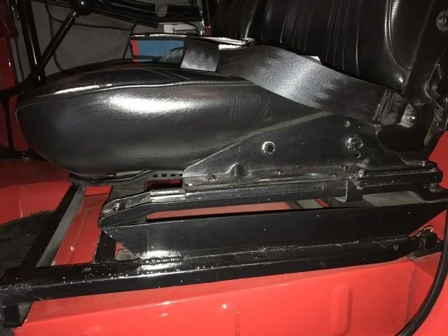

@fixoldthings, if you are not tied to going back original then here are a few pics of later year oem buckets in my 64. Hope these help you decide a path. Good luck!
Nice work, there. Thanks for the input.

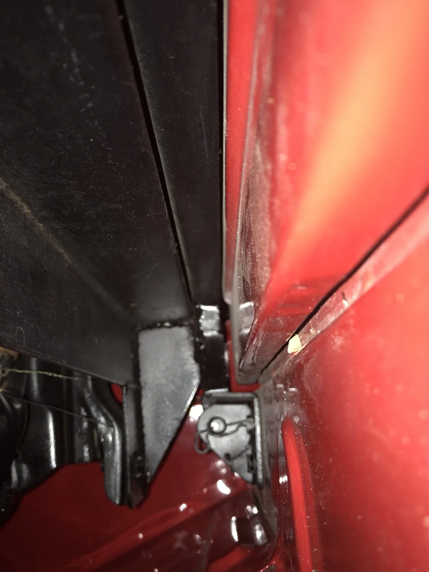

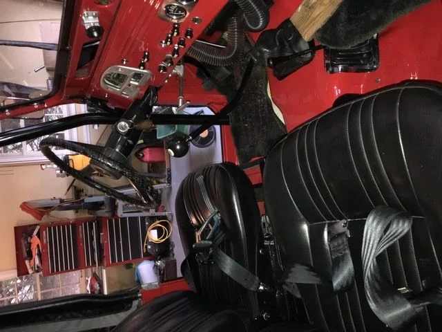

For my '71 FJ40 build I removed the toolbox and original seats. I picked up a complete set of seat supports and brackets compatible with the bucket seats in my '76 FJ40 from Brandon at Classic Cruisers. I bought a very decent set of OEM FJ40 3-point shoulder harness seat belts from Mark's Off Road and a very decent used tub here on MUD that I'll modify to use the bucket seat supports and brackets. I'll have the '76 seats reupholstered at the shop that just re-covered my short jump seats. I'll be using the SOR seat bottom foam. For me and my wife, we're used to the FJ40 bucket seats and are comfortable sitting in them for longer trips, including a run to Chinle, AZ and back as part of the FJ40 Cross Country Expedition and a trip to the first annual Solid Axle Summit a few years ago.
