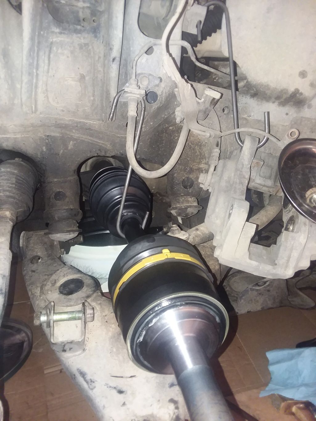

well then the steps are these:
jack up and remove wheel.
remove grease cap from hub.
remove snap ring from axle shaft.
remove 2 caliper bolts and hang caliper out of the way.
separate the upper ball joint and tie rod end. (careful when doing ubj, it can fall forward on you. best to leave nut slightly on to catch it)
now turn push the knuckle away and down and slide the axle out from the hub. if this is difficult then just remove lower ball joint and get the whole knuckle off.
use two long screwdrivers or medium sized pry bars to pop axle out of diff. protect seal and dust shield that is located on the outboard axle.

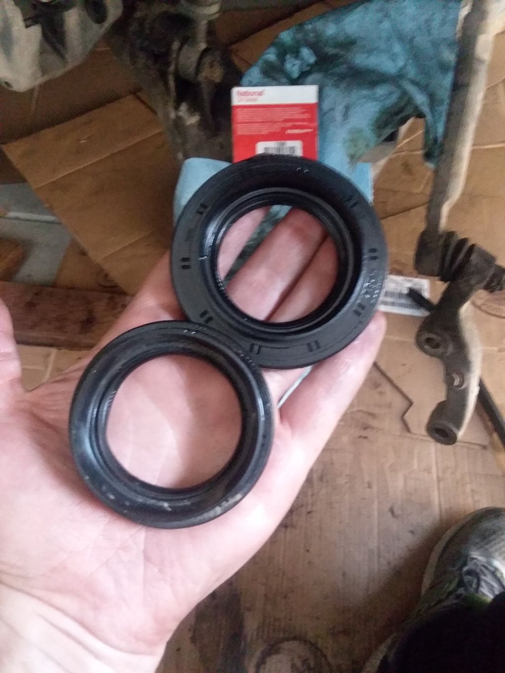

confirm your seal is correct size. they are different for driver side and passenger side.
then pry old seal out. take note of its seated depth.
drive new seal in. don't drive too far or it won't seal properly. there is an inner lip that the seal fits flush with.
pop axle back in. careful to not damage new seal.
attach knuckle again, torque the balljoints and TRE properly. they are all different. replace cotter pins with new stainless pins. (home depot 1/8" by 1.25 inches or so)

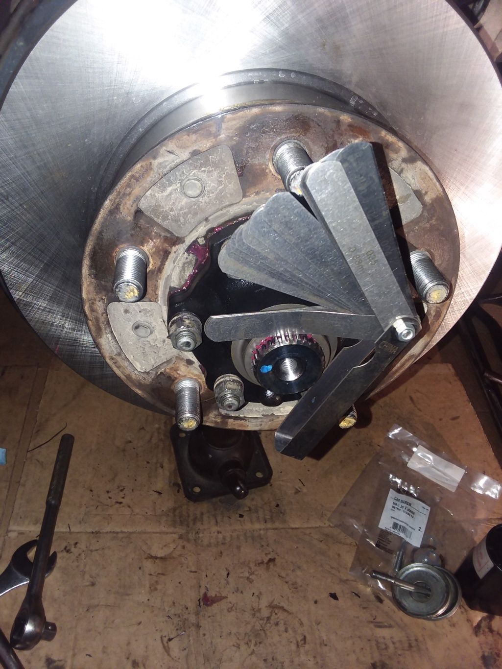

use a bolt to pull axle out as far as possible and fit a never used snap ring. probably 2.4mm unless excessively worn.
replace grease cap.

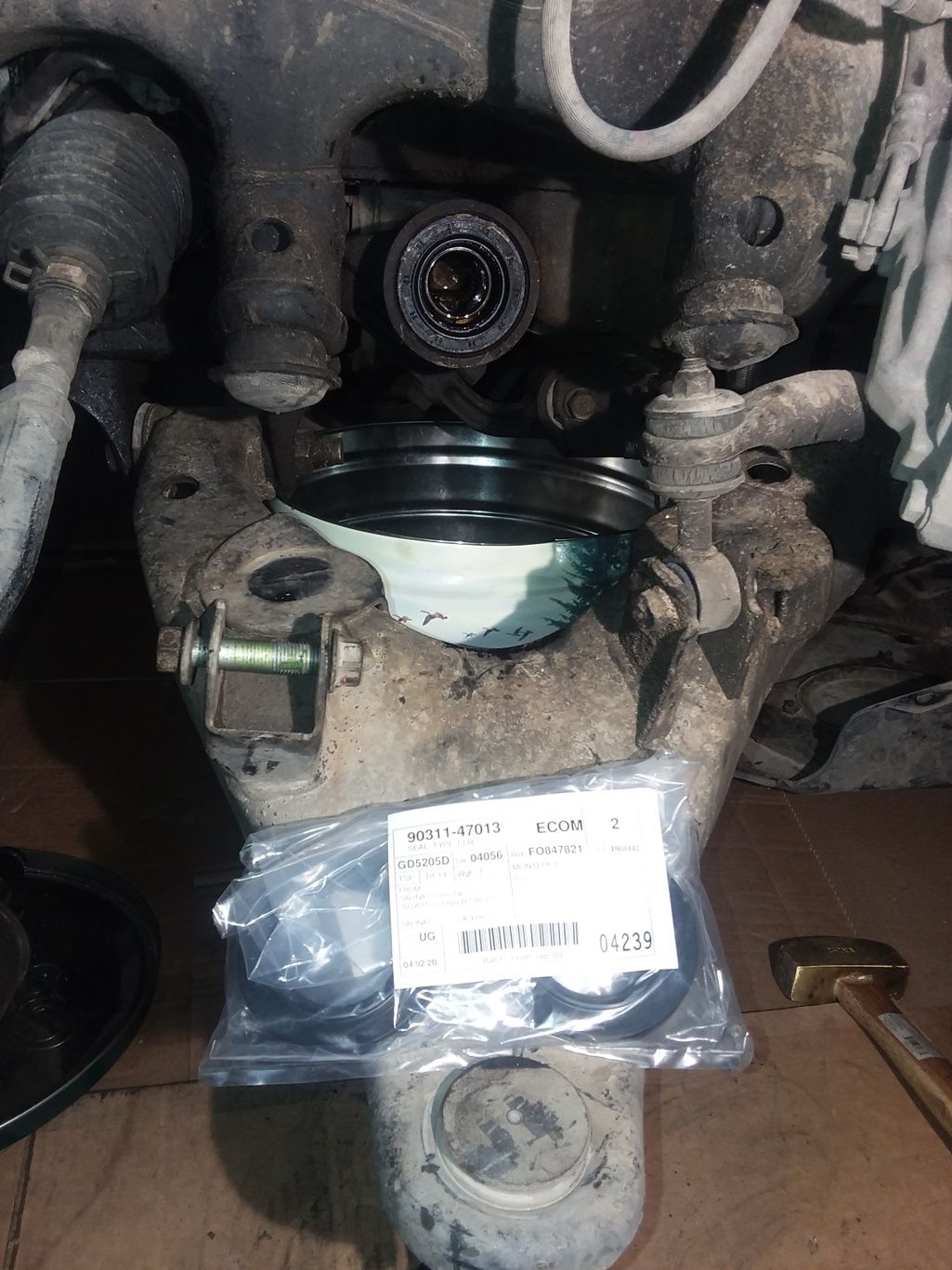

diff oil seal (driver side)..9031147013..13.25
diff oil seal (passenger side)..9031147027..12.18

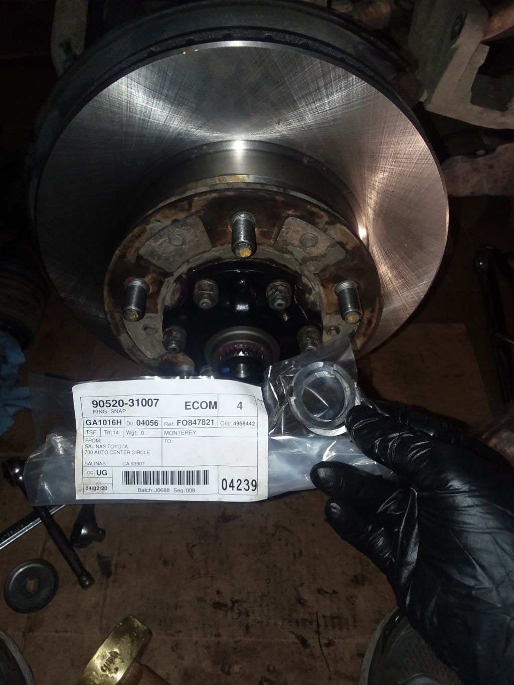

9052031005 (2.8mm)
9052031006 (2.6mm)
9052031007 (2.4mm) * probably need this size
9052031008 (2.2mm stock size just in case)

different sized seals depending on side

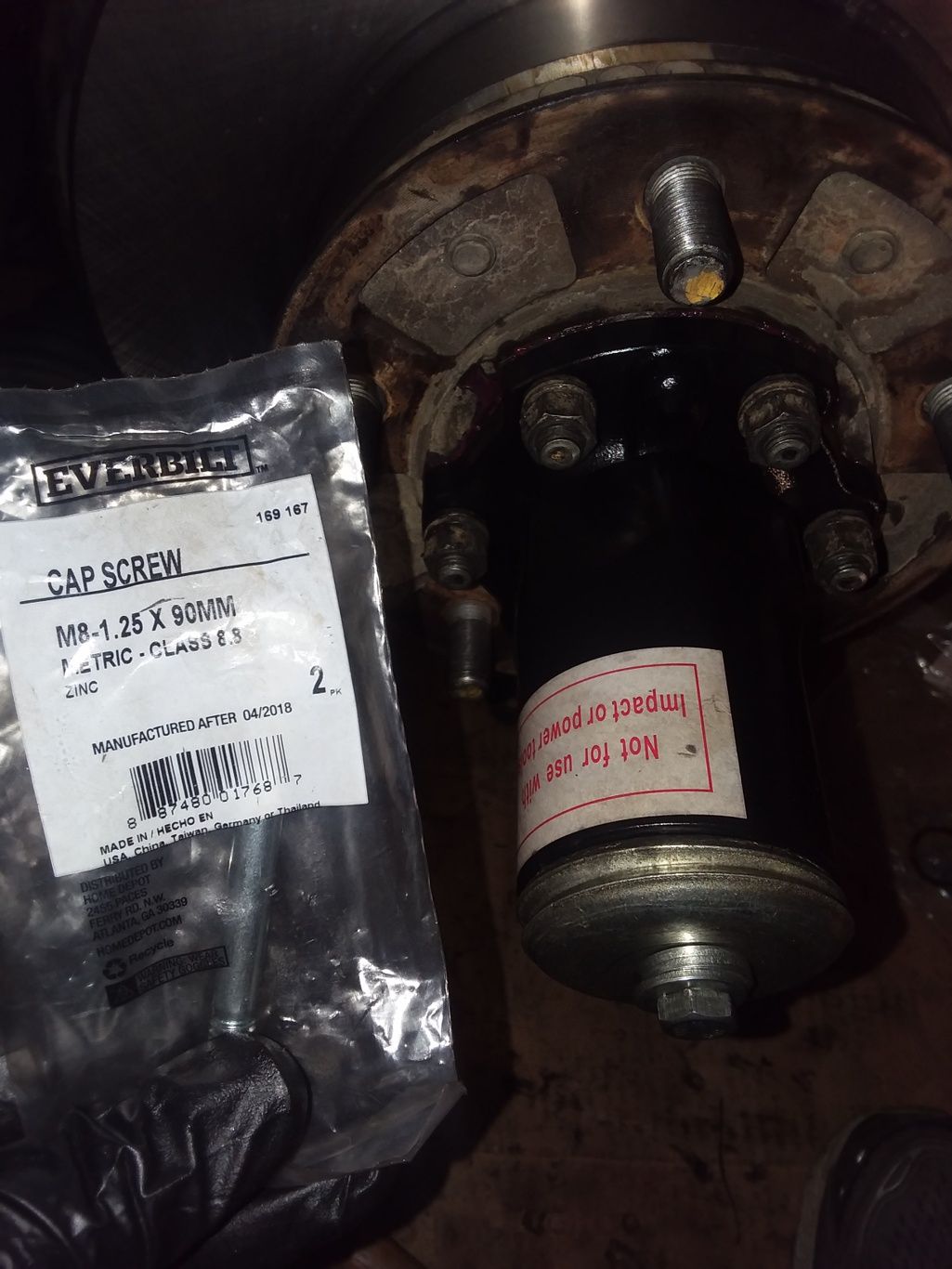

here's the bolt i use to thread into axle to pull on it. you don't need to pull so tight since you aren't repacking bearings.

there's the seal you're after. if you jack up only one side only you won't lose much oil at all.

Why do you need different size snap rings?
Well s***, it was still dripping slightly this morning. Looks like I'm going to have to replace that seal.
The bearings haven't been done in a long time (service records just say "inspect or repack" at it's service at 97k miles. Diff fluid looks like it was changed at that time as well. I'm at 185k now.
Overtime the gap between cv axle and housing/hub can increase. The stock c-clip is thinner, but over time more wear and tear occurs and that gap widens, resulting in needing a thicker c-clip.
How do you know if you need a thicker C-clip?
measure

basically you pull out the axle as far as possible and put the biggest snap ring that will fit. they come in .2mm increments.
